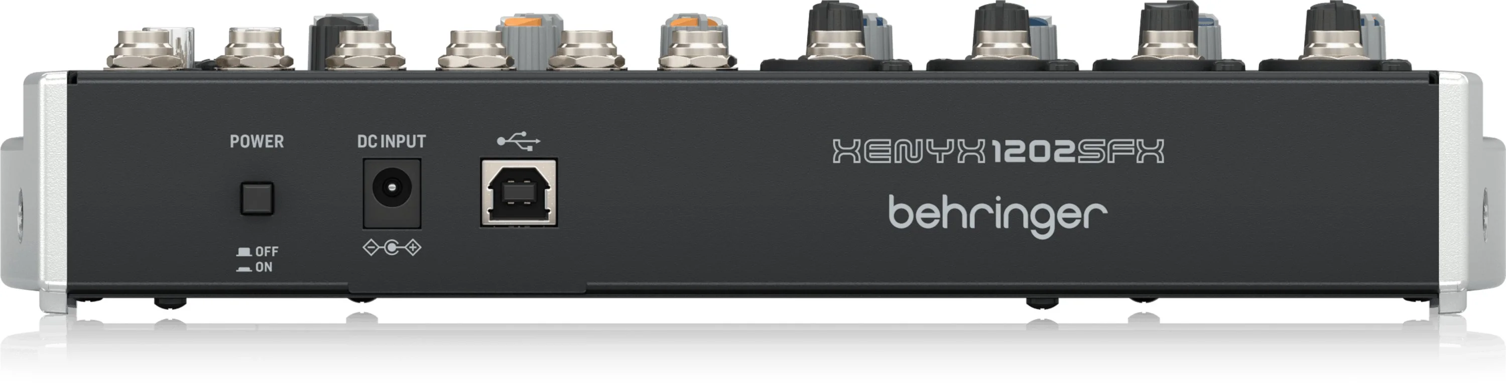

Ooops! Forgot, old see! Are you sure there is not a USB socket on that mixer? It will not look like the ones on your PC. Google "USB B".

View attachment 140668This picture is of an SFX....mine is an FX. It does not look like that on the back. It only has the power connection hole. It has 4 channels for microphones, all with 3 possible microphone connections, the 3 prong microphone connections, the jack plug size, and the jack plug with a 3.5 mm converter inside it. I hope that makes sense without taking a picture. No were is there a usb connector. However, I'm wondering if I can connect the Line in, Line out to the pc...one to the mic and one to the headphone 3.5 mm connections?? And if you ever sang on Singsnap with their mixer you would understand why I'm trying to get this mixer to work Rob. Their mixer is horrible. I would like to add a little depth and reverb to my voice and I know this mixer can do that if I can just get it working on my system. That is the question. If needs be I shall take a picture of this. Thanks for answering!!!

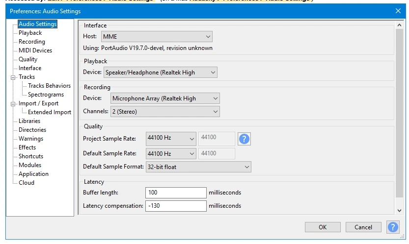

What is a USB PC? A PC with USB Inputs only? Anyway you plug the Mic in via the USB and you are done - If using Audacity you choose Audio Preferences and pick the mic as your recording device - there is no way to connect your Mixer via USB -it doesn’t have a USB interface - however you can guy a used Behringer U-Phoria UM2 Audio Interface for about $25 - then you can use you mixer/
