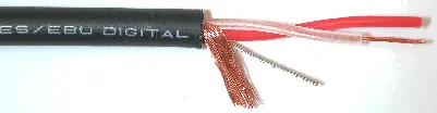

I understand that I need to connect the insert send to the top of the patchbay and the return to the bottom of the patchbay, but how to do this is where I'm stuck. I'm currently using Mogami 3080 cable to wire this up. The cable is 2 conductor with a drain wire, and a shield for the whole cable.

Does that say "Digital Cable"? I'm no expert but I don't think you're supposed to use digital cable to wire a board to a bay. I'm not familiar with your bay but what I do is run my inserts through a regular ol' TRS snake to the patchbay. then I run the Y cable in the front of the patchbay (instead of behind). this way I can slide the snake cables from the insert over to say an input on each channel, and use the balanced inputs through the same jack on the patchbay. I hope this helps.
