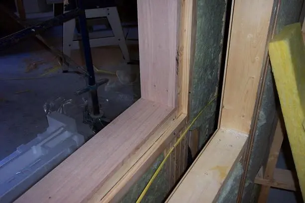

Like I said before, you start with a rough framed opening.
Here you can see one side that still roughed, and one side that has the begining of the window seal.
Note the furring strips on the inside of the window's rough opening; more on that later.

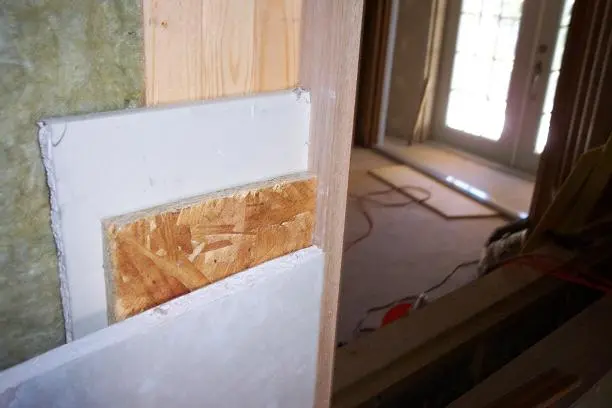

Looking at the outside of the window... the finished wall side; it is IMPERITIVE that the window frame extend out, from the wall framing, enough to accomodate ALL the layers of wall material you plan to use.
In my case, I'm using a triple layer system, so the window seal had to extend out from the framed wall about 1 1/2".

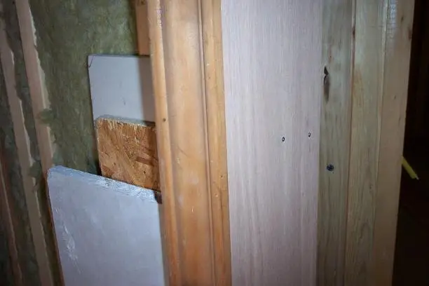

What that does for you, is it puts the window frame or seal FLUSH with the final layer of material that's going to go on the wall.
Then you simply trim that out, and umm.... "beat to fit, and paint to match"! :D

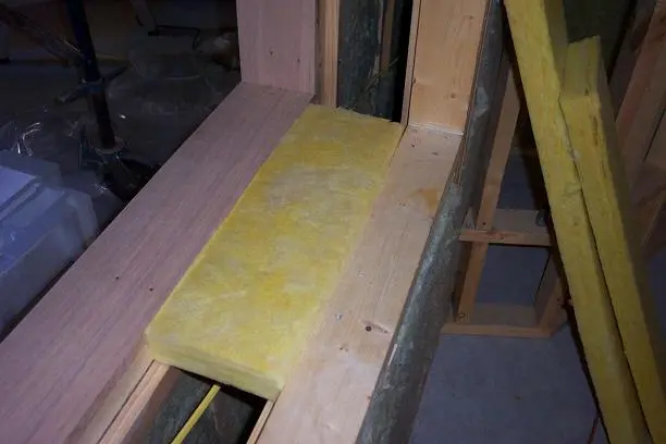

Remember the furring strips on the inside of the window?
Those are there to give a base or support for the insulation that would go between the two walls, inside the window.
Without those, you run the risk of having the insulation slip down in between the 2 wall sections after the glass is installed.
The rough opening is just that... a ROUGH opening.
Where you take extreme care with is the window seal.
It MUST be perfectly square and plumb.
If the rough opening isn't square, and most of the time it wont be, because the wall is built on the floor, then tilted into place, and racked plumb.
All of that could pull the rough opening slightly out of square. That's where your framing for the seal comes in, and that's what you want to be square, true, and plumb.
Just measure diagonally across each corner.
Are the dimensions EXACTLY the same?
If so, then your window frame is square.
Hope that helped.
