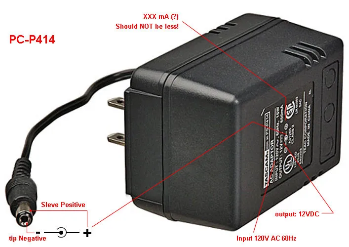

adrianhouse said:
The original A/C adaptor "puts out" (600 milliamps).
If this is true, then you need an AC-to-DC adaptor:
Input: (what's in your wall) - 120 VAC 60Hz
Output: 12 VDC minimum 600 mA (you may get away with 500mA, maybe, but better not to experiment)
Connector: Tip Negative, Sleeve Positive.
My guess is that this adaptor is unregulated (inside that box you have a transformer, rectifier diodes (bridge), electrolytic capacitor and maybe a resistor or two. but I can not be for sure what is it exactly.
Picture is attached (from that photo, I can not read how much current it is rated ...XXXmA???):
/later

The current ouptut on the PS-P414 is 650ma, (12VDC).
I'd say use what you have in a pinch, but make sure it matches the official supply as exactly as possible. Use the proper Tascam p/s when possible and heed the warnings in the manuals.:eek:;)

If I know 100% for sure what exactly the original Tascam adaptor is, then I could advise you for sure, but since I don't , I can't do that. My guess was that it's unregulated, I may be wrong. I think you could use something like this: http://cgi.ebay.com/AC-DC-Adaptor-6-Universal-Plug-500mA-1-5-to-12-VDC_W0QQitemZ140084880180, I can not be sure, though
