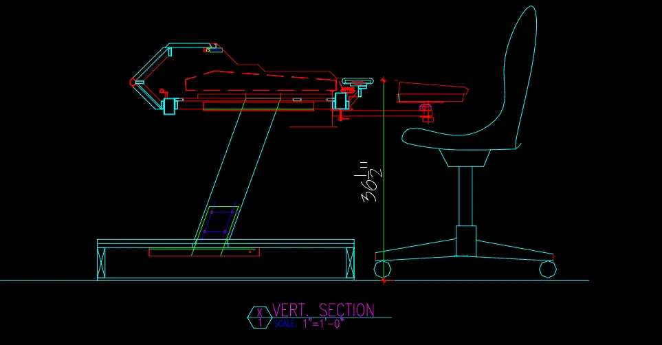

Hey Rush, when I designed my console, it was to be at normal mixer height. Since it was designed for the legs to die into a floating floor as the legs are cable troughs. When I moved, I had to build platforms to act as the floating floor, which brought my console up to a height where it required drafting chairs, which a full 12" higher than a standard steel folding chair. I love it. Especially for playing guitar at the console. here is a section to show the height. It puts my monitors at just the right hieght when they are on the console(not shown) I am in the process of assembling it right now. I'll post a pic soon.

Rick.... thanks for the insight. After hearing what Frederic said about sitting for longer periods of time, I thought my decision against it was concrete. Then you come along and say how great it is! :mad: Now I'll have to stay up all night brainstorming about it again!:D
Yeah.... it'd be cool to see your pic.
Hello Rush, hey, I have to qualify a couple of things. First, this is not at 42" which seems way too high for my way of thinking. Although, the monitor shelf is right about 42". The wrist pad is at 36 1/2" which is about 5 to 6" higher than standard consoles. Second, the drawing of the chair doesn't show the foot ring which allows for foot support at regular hieght. But if you could sit at my console vs. a standard height I think you would see why I like it. Third, the platform acts as a foot rest also, at standard hieght as it is 5 1/2" high. Perfect for drafting chairs. Of course, the chairs have hieght adjustments so I adjust them so my knees just clear the underside of the frame. No matter what, I love the chairs for playing guitar. Anyway, my .02.
fitZ:)
