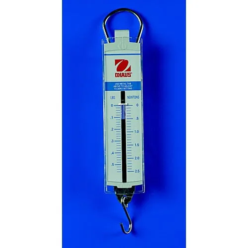

Where can I get a decent spring scale? I would like to be able to go out and get it not wait for the mail...

But the thing about the scale...Does Wally-Mort have them?
This is the best link I could find in a quick search.
http://sciencekit.com/product.asp?SPLID=SPLID01&pn=IG0030881&cmc=HOME_PAGEIG0030881&bhcd2=1188337686
These look adequate & heavy duty enough to do the job, & are relatively inexpensive.
You might find other or better spring scales with a more extensive search.
My spring scale is a bit older & more "scientific" looking model for engineering.
These Ohaus spring scales should do the trick, though. You'll need a couple scales of different values.
The old school spring scale I have is made entirely of metal.

No scales small enough at Wally World. They might have fish scales but they go up to 50 pounds, so won't be fine enough.
