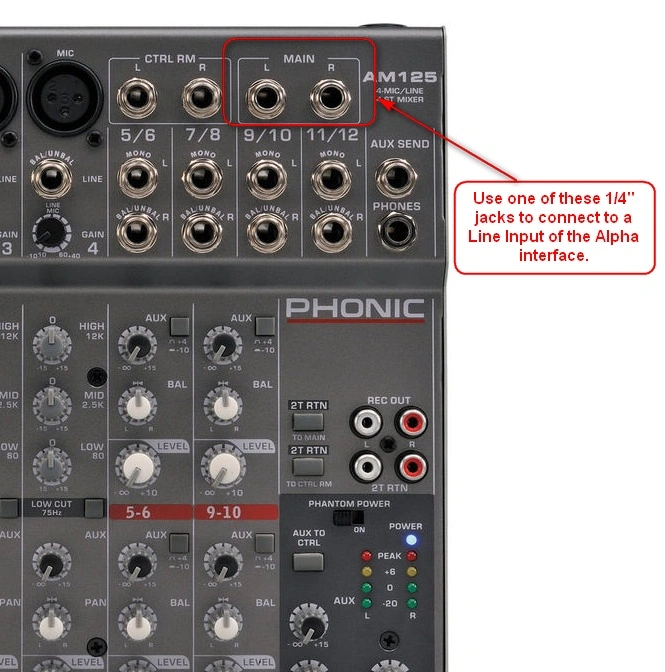

- Is the 1/4" cable a TS(tip-sleeve) or a TRS(tip-ring-sleeve)? The aux send is a TS(unbalanced) jack. You should be using a Line input on the Alpha which is TRS and either TRS balanced or TS unbalanced can be plugged into it. You probably should be using a TS type cable since the aux send is TS(unbalanced). If you have a TRS cable try the Main outs on the mixer which seem to be TRS(balanced) from the manual.

Headphones are stereo, you don't want to use that to connect to the Alpha. Use one of the Line inputs on the back of the Alpha from one of the mixers Main Outs. If you have headphones (which you should have a pair :) ), how do they sound if plugged into mixers headphone jack?
Ahhh, how did I not even think this might be the main out! Lol thank you!
