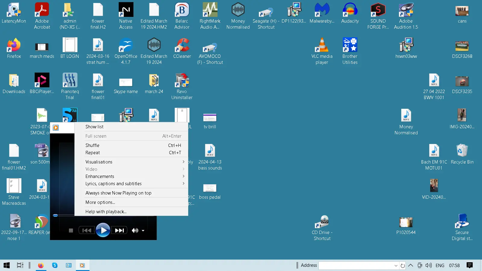

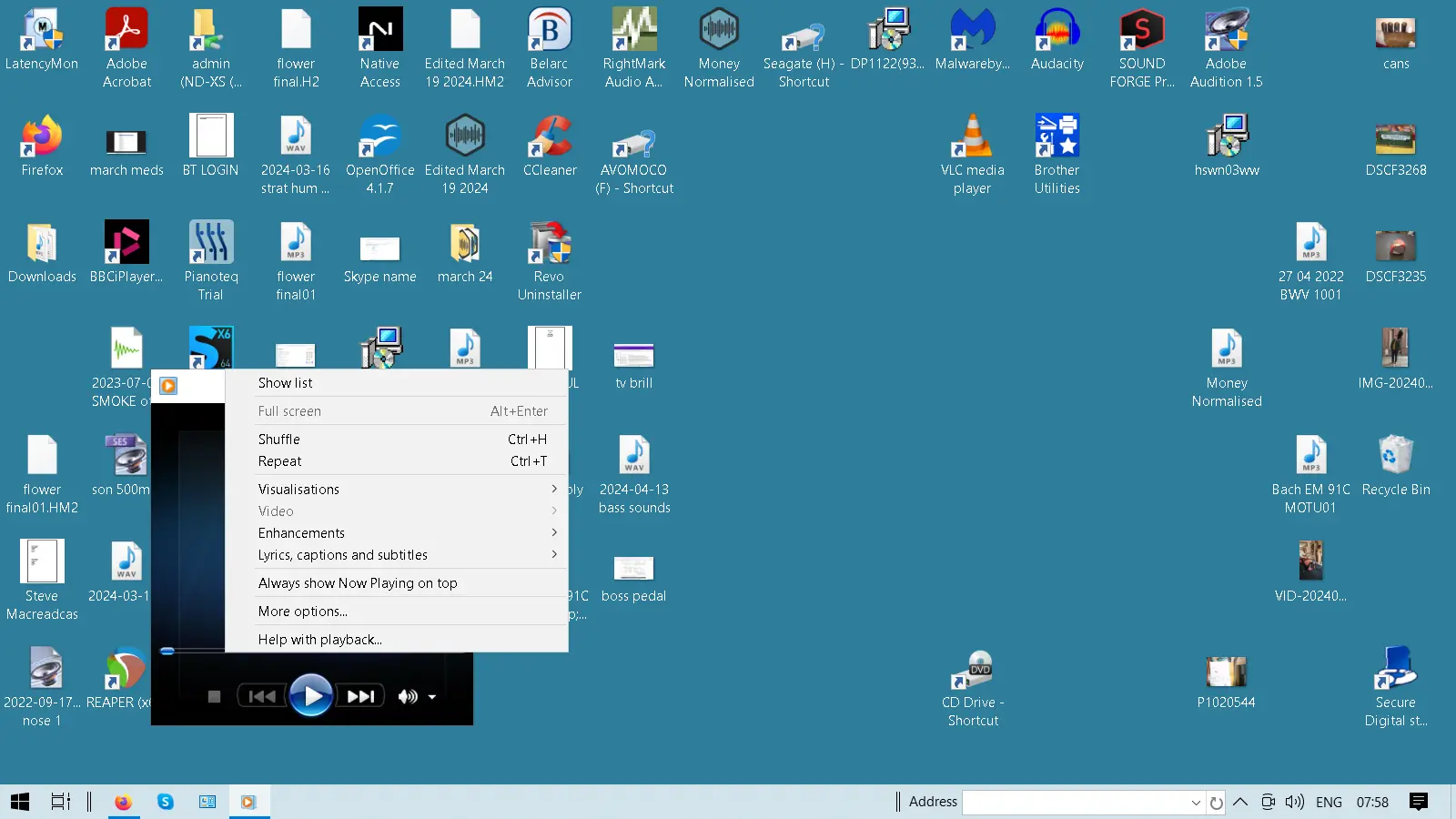

Tried that Rich and, as expected it just saves the link. I still do not have the audio file to insert into Samplitude.
Thanks for the PM* Rich. I wrote a reply (clicked the return arrow as per normal) but then it refused to send it.WTF?
I have attached a screen shot of what I get in WMP after r clicking on the blue line. Cannot see an option to save audio?
I am on Firefox, W10 and BT. The latter have been screwing about with my email function for months but I cannot get any sense out of them.
I shall see how Win 7 behaves later.
*Why don't they CALL them PMs like very other forum? This stuff is hard enough without people using different names for the same function!
