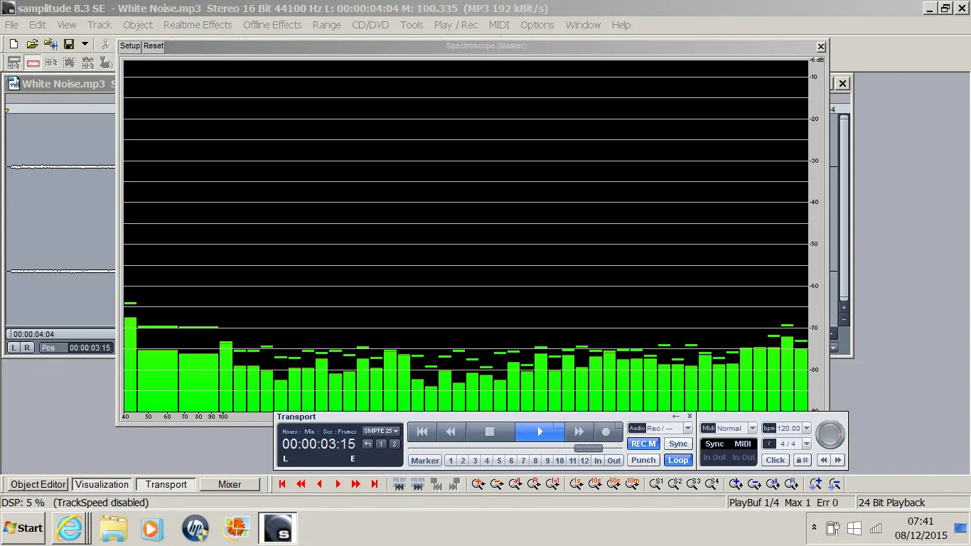

Hey folks,
I'm trying to identify the culprit of what I can only guess is white noise. I've tried unplugging, rearranging chords, etc. Nothing has worked. I've attached a 4 second clip of what it sounds like when I amplify it 50 dbs. Normalizing it and it would peak! I use a small Behringer mixer and plug it into my Echo Mia MIDI soundcard. This is the sound I get whether I have a mic plugged in or not.
Any ideas?
To add to this all: white noise even registers when I do not have anything plugged into the soundcard: main outs and cd/tape in. I get the same level of white noise. I simply record in a program like Audacity or Adobe with with Analog 1-2 (Mia MIDI) as my recording device.
You are correct, that is white noise or I've never seen any!

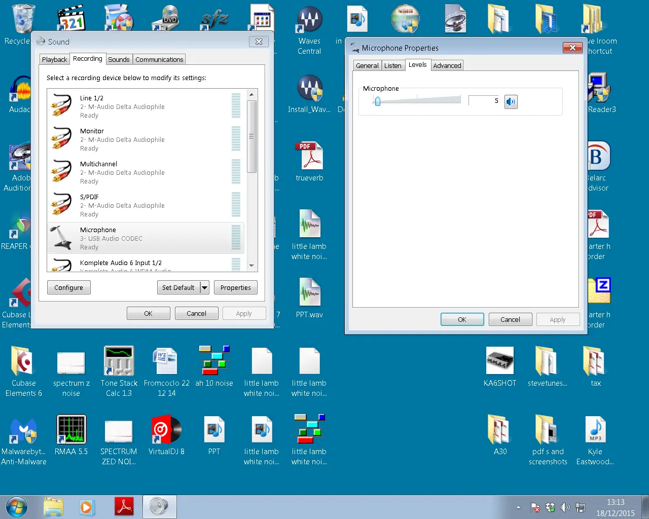

Have you checked/played around with levels as per the screen shot attached? But then I would assume the Echo card has ASIO divers?

I have looked at my levels like the screen shows. Nothing out of the ordinary.
