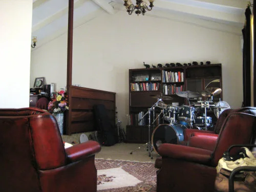

I'm still at my folks place so I can't do anything to the room. Either way, I've attached a photo of it (maybe someone could provide some general comments on what I could do).
The room is basically an 18' x 18' square with a 9' x 9' corner taken out (L-shaped). The roof goes from 9ft to about 15ft.
