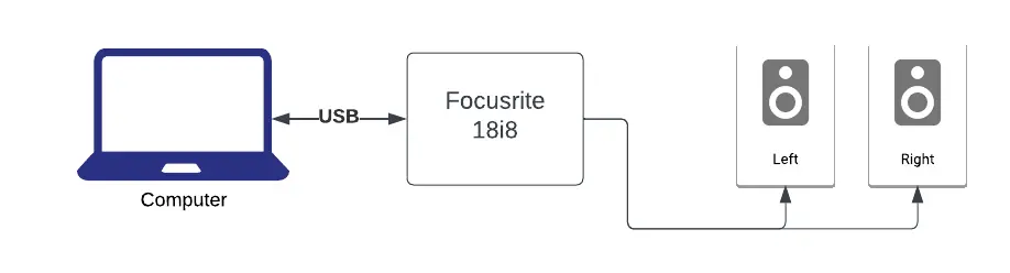

I have mostly built my studio but I have run into an issue that I hadn't planned for.
Original Setup
To begin, here's is my current setup which was as planned:
I have a Shure microphone as an input on the front of the device, and I have two 1/4" inputs being used on the back to capture output from my guitar modeler, a Boss GT-1000. When I'm not recording, I use this to practice by enabling monitoring on the inputs so I can hear the guitar output through my headphones or studio monitors.

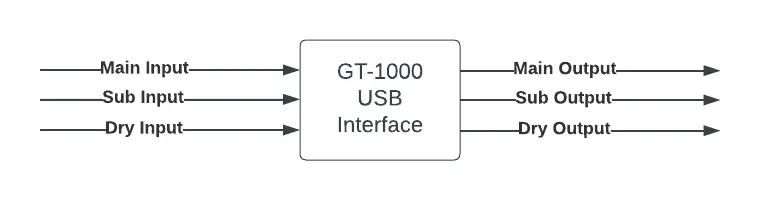

What I hadn't planned for was the ability to use the GT-1000 to re-amp dry signal on the fly. The GT-1000 USB audio interface exposes three outputs (main, sub, dry) and three inputs (main, sub, dry):
Ignore the sub input/output, as that's not really interesting here.
It has been a long time since I did any home studio work, certainly over a decade, and I had never thought of re-amping as something that was even an option, but basically what you can do is:

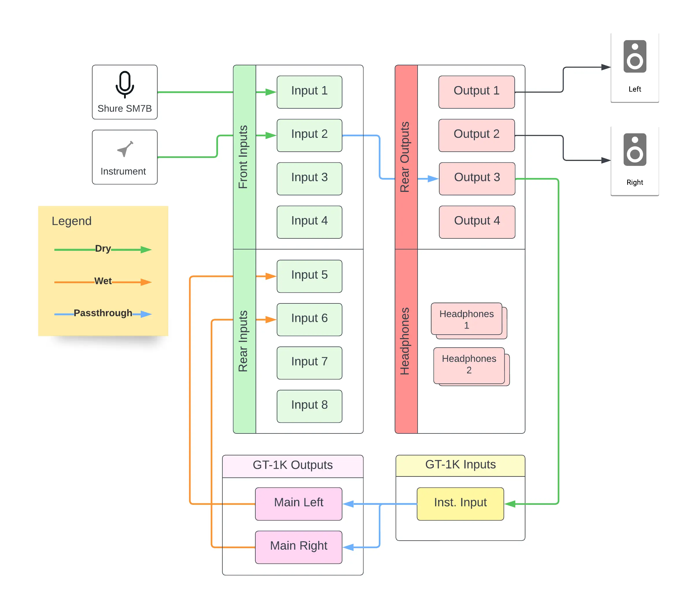

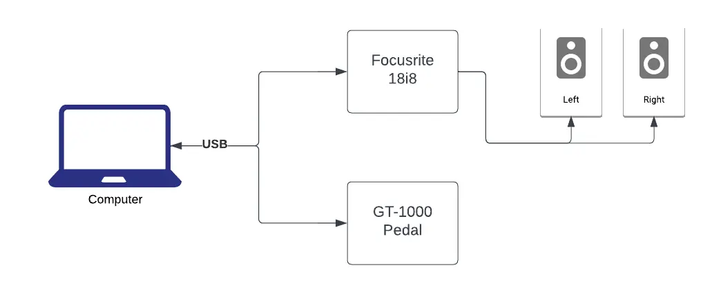

Now, with this setup, my studio setup will have to look like this:

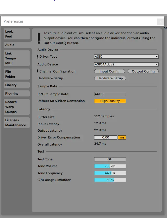

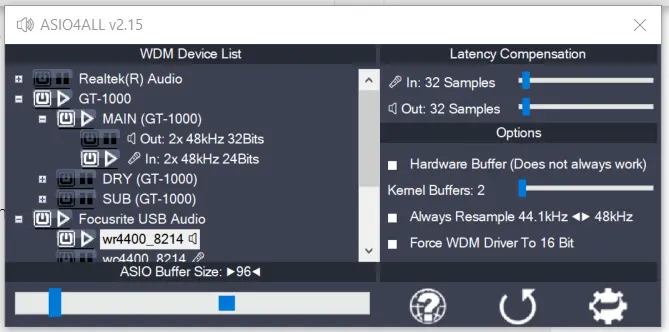

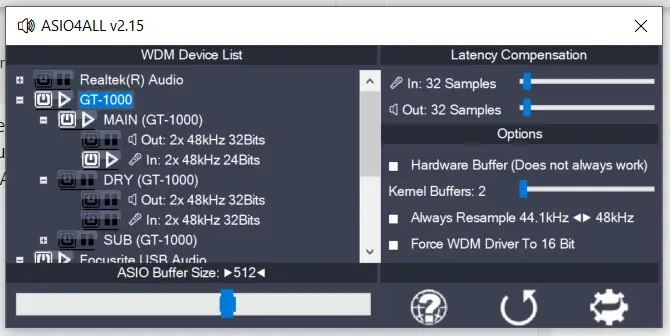

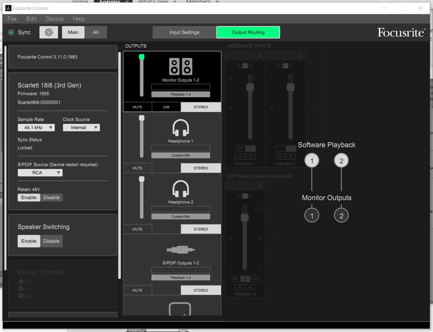

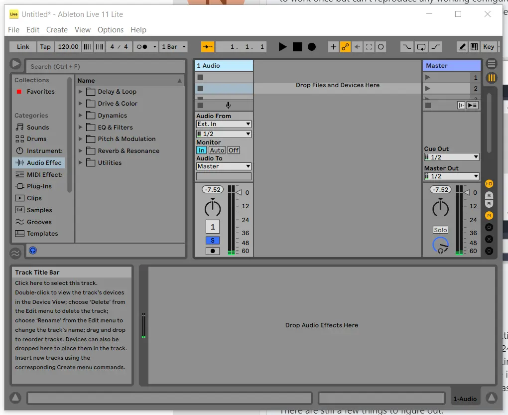

Back in the day, I was using SONAR's Cakewalk and a firewire interface. I have a free Ableton Live Lite license and I have downloaded Bandlab's Cakewalk resurrection. When crawling through settings, it seems like both of these assume that you'll only ever be using a single USB interface.
- Record both the main outputs from the GT-1000 and the dry output.
- To re-amp, send your dry output track to the GT-1000's dry input.
- You can now use the exact same dry signal and change settings on the GT-1000 to completely redesign the sound if desired.
Here are my goals:
- Use as few cables as possible.
- If I'm able to realize the setup above, I'll only need a single USB cable to the GT-1000.
- If I'm not able to just use USB, then I'll have to buy a D/I splitter, route the D/I into the Scarlett, and route analog sends/returns to/from the GT-1000 and Scarlett, significantly increasing the amount of cables I'll have to be using; I was originally only planning to have two 1/4" outputs from the GT-1000 to the Scarlett.
- For monitoring, if I still need to use analog outputs from the GT-1000, this is fine.
- Be able to record mono dry output from the GT-1000 alongside the wet/main stereo outputs.
- Computer audio should still route output through the Focusrite 18i8.
