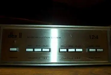

Here is a 4 channel type II I havnt tried this unit yet, I have only had it 3 years.:rolleyes:

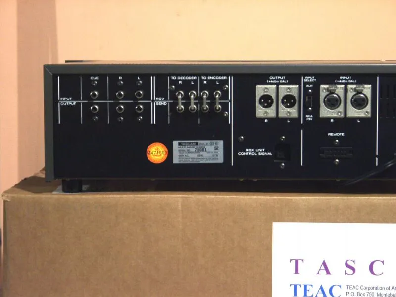

I just thought I'd post this pic,...
of the 133 back panel. You see, there's a dbx control connector, and I'd assumed that this was specific to the DX-2d. No other dbx unit that I know of had the "control cable" connection, 'cept the Tascam DX-Series of dbx units. Beyond that, I plead my ignorance.

Vintage TX said:
OK guys, the 133 cassette has a DBX-connection on the back for Tascam RX-8 DBX-unit.;)
I just checked my catalog info on the 133 and you are indeed correct. The RX-8 is specified as the optional noise reduction unit for the deck.
I don't have any documents on the DX-8 to categorically determine if it is a type I or II dbx system, though I suspect it is a type II device.

Hi again
I checked again here and the RX-8 is a DBX-unit for use on Tascam 122 and 133.
Maybe I am wrong, have been wrong before:p
Thank you! No, it's my mistake, entirely!
