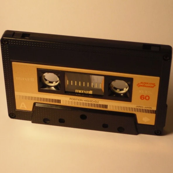

If you didn't experience better quality with good Type II tapes you were either doing something wrong or there was something wrong with your MT50. User error can include choosing inferior tape or tapes of the wrong length, etc. Use high bias tape such as Maxell XLII or TDK SA at lengths no greater than 90-minute. Some cassette multitracks had problems with tapes over 60-minutes and most performed best with 60-minute. 120-minute tape would cause audible errors after a few passes. Problems like you describe are more likely due to tape brand and/or length than differences between normal bias and high bias in general.

Try the TDK SA90 or SA60, if you can still find them. Maxell and BASF did good ones for portastudios too. I used almost exclusively TDK SA90s since 1992 and I've never had the problems you've described.
I'd seen a recommendation for TDK SM-X tapes so I might give those a try.

Wow, two pages of this? The owner's manual tells you which tape to use - usually TDK SA or maxell XL-II, 90 minutes or shorter.
I've used Maxell or TDK C90s almost exclusively, with only a few C60s here and there. However, when I ventured in deep to tweak the record/repro adjustments on a 244, I found the C60's thickness to make a huge difference in stability of calibration response, where C90s waivered a bit and were virtually impossible to zero in. For precise calibration the C60s seemed to be the right thing, although in practical real recording I've never detected any difference between C60s and C90s.
