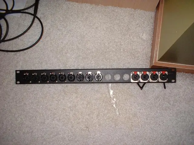

Yep heres one thats almost done! My supplier ran out of Combo's.
-Blaze

The ones I speak of I could take some pictures of the ones I have had made however, they are made to order anyway you can configure them. You just have to draw up a diagram with all the I/O you require and any dealer can quote you a price. I wire everything myself but that dosen't mean you have to. they will com with all neutrik panel mount connectors already mounted and wired if you like. I found it dosen't pay to punch my own panels anymore because it takes too much time. If you need help finding out what you need done if thats the way you are heading let me know

I'll prolly go with the Mid-atlantic b/c they're cheaper. Better get my soldering chops going again! Thanks to both you guys.
JD
