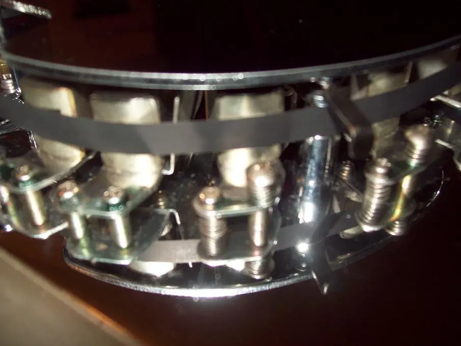

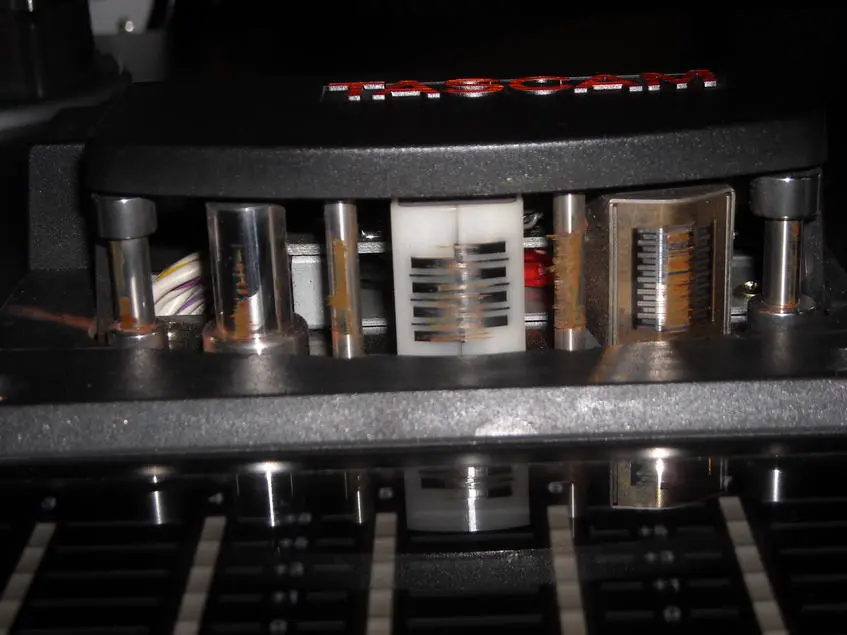

...it gets UGLY!:eek::mad:

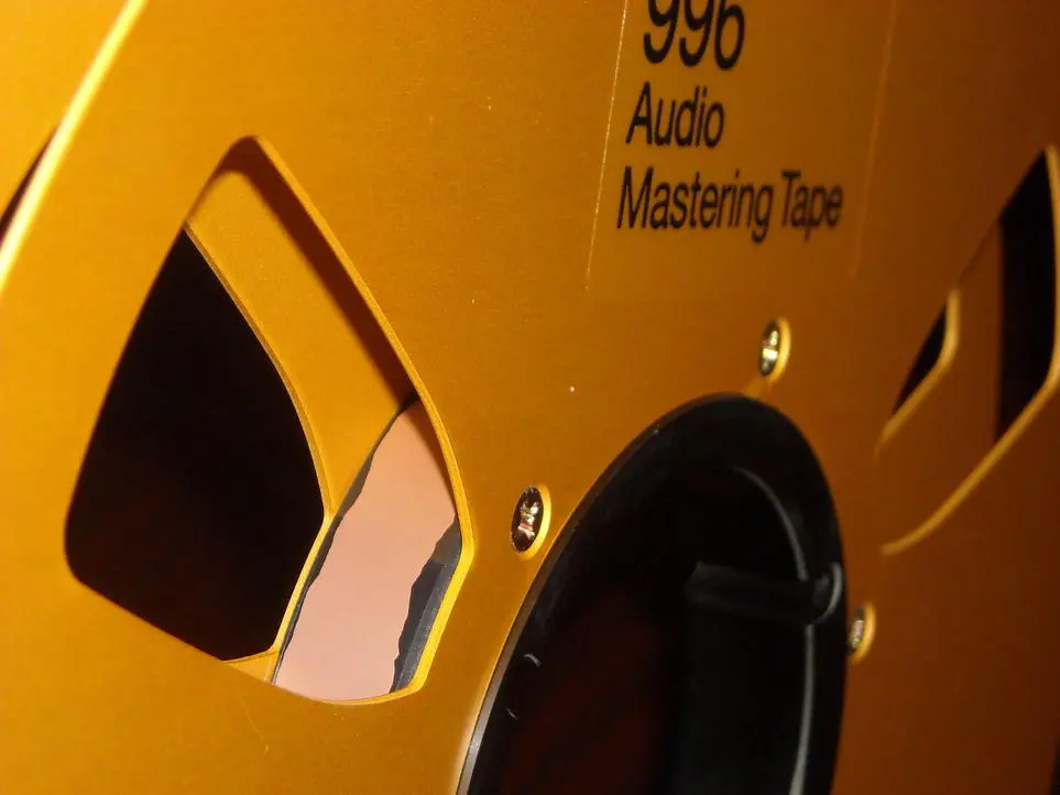

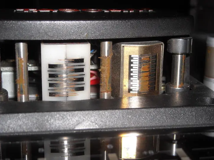

Here, we have an innocent TSR8 brought down by the grizzly 3M 996 tape. The TSR8 gave it's best, but in the end, the 996 left it's mark.
Now, it's time for the grueling clean up and get back to normal!:D:drunk:

ouch!
:eek:OUCH!!!:eek:

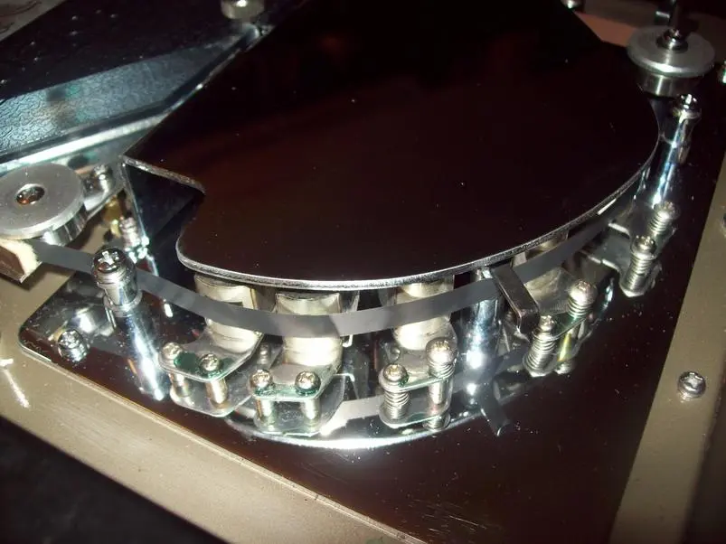

Just ran into the same problem on one of my SRE-555's.
Tried out a replacement tape that was given to me,
and it wasn't an original Roland RT-1L tape.
The damn thing shedded all over my precious tape echo!:mad:
Don't know what I was thinking, tryin' out someone's homemade tape loop from junkbay... when I have several RT-1L's for my tape echos!:confused:
I guess I was curious to hear the difference in the qualities of tape.
Never again!
Looks like you've got your work cut out for you.:eek:
I spent 2 1/2 hours cleanin' my tape echo after that happened. :mad:

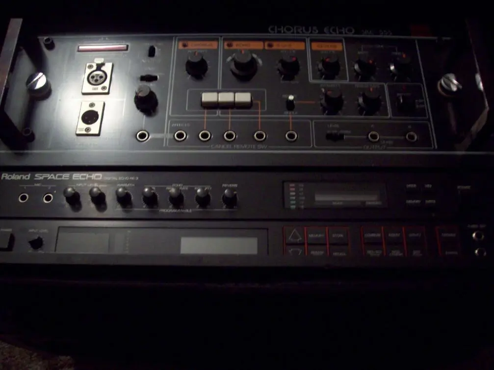

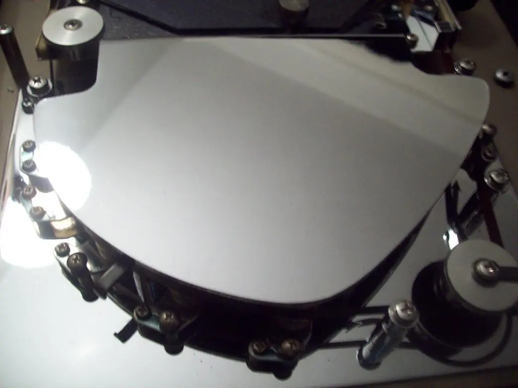

Here it is all cleaned up...

Yeah, 996 was a very good sounding tape, especially for "pro" recorders designed for higher recording levels and with transports that can deal easily with thicker tape. OTOH, I had varying levels of annoying shedding from a little to a lot and, if memory serves, even some sticky issues. My plan is to stick with new tapes and NOS tapes not known for those issues. BTW, sorry about that mess!

No worries man.;) I had a feeling that the two tapes I had might be "iffy". I did ffwd/rwd functions to check, and then played a short stretch of them. No harm done, just some elbow grease and a little time is all it will cost me.
I'm definitely going to stick with the newer tapes, for sure. NOS Quantegy and RMG have been very good to me.;)
Holy Shit! I don't think I've ever seen it that bad. I freak out where there are specks of tape on my pinch roller, if my tape heads and guides had a nice winter coat on like that I'd probably faint or something hahah. Hope all goes well with the clean up!

Unfortunately 996 goes on the "watch out" list which is too bad.
I'll know for sure in a couple months when I'm done with construction can get my Ampex uncovered and into the new studio but I think the reel of 1" 996 I bought is starting to go sticky. I have 499 which I will test back-to-back and I bet the 499 is fine.
