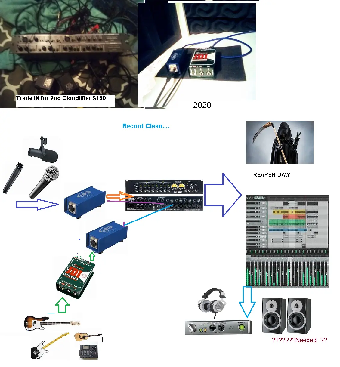

I don't know who here recommended the Cloudlifter to me, but its really been a 5 Star item for my desktop setup.
I learned today, the Radial JDI I have can plug into the Cloudlifter and that's really been a very nice little boost!
Spent all morning for about the 5th or 6th time of comparing this "2020" setup (the Cloudlifter/JDI) to some rack gear.
The CL and JDI has the lowest noise floor, less cables, less everything... etc..etc.. less hassle. Sound great...
2020 resolution was to play, write, record more than Tech-Review compare gear holy grail seeking rabbit hole stuff.... but I got GAS and wanted to see if the CL & JDI would stand up and they really work great for a desktop hrs.
nice big fat wave forms with best noise floor I can muster in this hobbit hole!

What's the pre? I can't tell. So the CL goes BEFORE the pre? Does it do that much for the dynamic mics?
Yes the CL adds gain before the interface preamp. Its a booster, so its CL+Interface Preamp.
Basically its a preamp that has two gain stages, #1 is the CL, the # 2 is the interface preamp gain stage.
The "DI" to this preamp/setup is a Radial JDI … nice.
My surprise was my JDI , was going into my interface mic preamp, but it was a little weak, and so I read about it and its a mic level signal, so I plugged the JDI into the CL, and it gave a really nice boost too, getting my nice fat waveform, with ease.
Its great for a small desktop setup, less cables, less noise, less hassle, not super cheap but professional gear for $149, $199 …
<add> this JDI makes my Fender electric 6 string sound pretty decent too for a clean, chimey, track.
