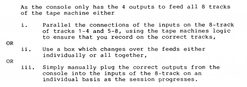

Both the 200B and the M-216 have 8 tape returns and 4 mix buss outs - I am not even sure how I would use this when recording with my 8 track as I believe the 200B manual specifies to "parallel connect the inputs of the 8 track" which I have no idea what that means (see attachment). The M-216 is a little more straightforward but I am also unsure of how to use it for 8 track recording. That said, my main goal is to incorporate these as summing consoles if possible - if not, then at least as a more robust mixing platform for my tape recordings which will then just be bounced into the daw.
