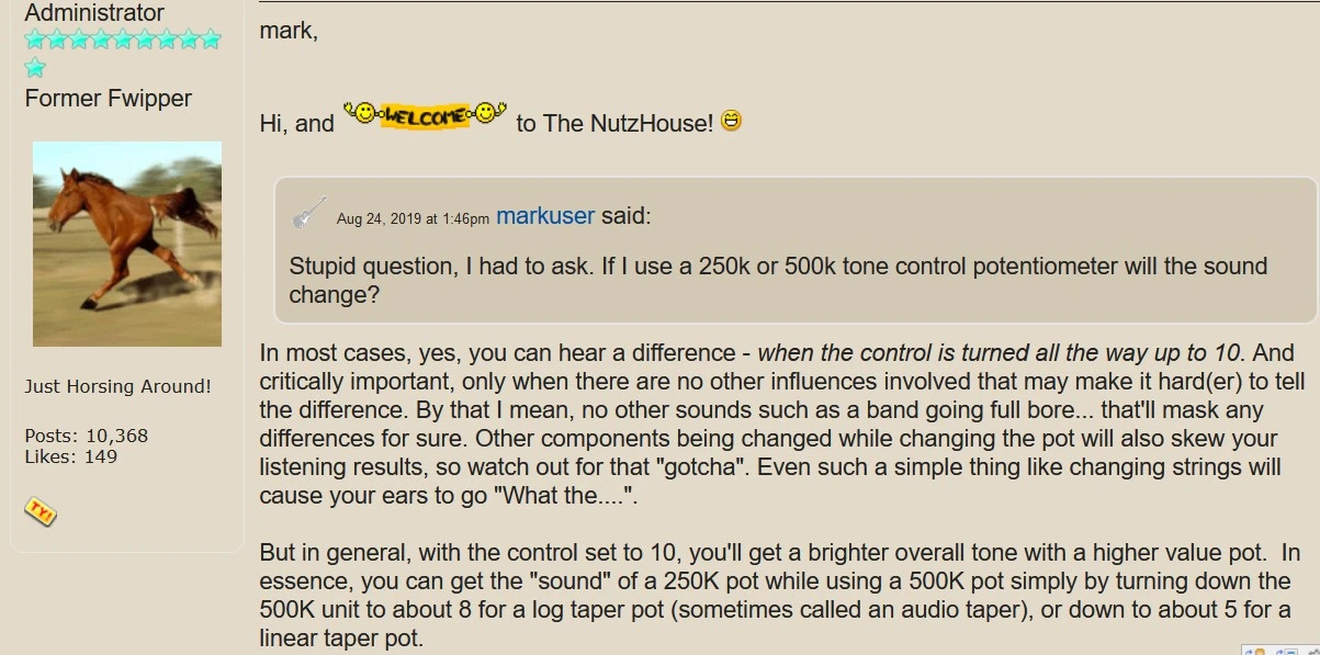

The tone knob on board the vehicle? A tone control is subtractive. So it is commonly used to dull a shrill sound. 10 would be as close to open. 'Tone' circuit cut out completely would be wide open. A 250k pot still sounds open and round, nice and strong, and needs little capacitence in the tone control. Like .10-.20 uf. The resistance, adds needed treble, naturally creating potential. As you go up in volumn knob potential, 500k will require more tone capacity. Like 1meg pots are shrill as hell, so you control it back to presentable with a .6+ uf cap. Potential value increase there is a bad game. You start taking away more than you are putting in, it ruins the attack eventually. The most tactically adept move would be to lower the potentials of the knobs and run the thing as wide open as possible. Purest tiny signal amped with a 9 volt. Using ACTIVE PICKUPS. Switching to 10k pots not 500k. Massive body.
From the preamp's point of veiw, you want as much pick attack potential as possible, with the least ammount of capacity. You would NOT play starting on 1, on the tone knob. Not how it works. Potential and capacity works the other way. Once you have the dynamic signal into the preamp you do what you want with it.
Thats what I say anyways. Pretty sure some of it is fact.
There's a few flaws here. Pots are passive devices and do NOT alter sound passing through them, other than reducing it's amplitude. The tonal aspects many people ascribe to them are just a function of the total circuit. A capacitor in series in an audio line removes HF, that is all. The total resistance of a pot across the signal line is a load and this also results in a change to the response. Guitar amps typically have a very high impedance so they do not load the audio line and reduce the HF. If there is a pot in the circuit, then the impedance will be padded to whatever maximum value the pot has - so a 250K, or a 100K pot will have an impact. The other snag is that the wiper, that produces the output is on a logarithmic scale - so the wrong pot for the circuit means the volume will seem to change most at one end or the other. Get the matching right - for the pickup and the amp/capture device and the volume travels smoothly.
So we have in the guitar or bass components that as Laser said, remove HF, but that is all they do. You can change the capacitor value - then the introduction of the capacitors function in the circuit happens at a different frequency. No pot sounds open and round - they don't have this capability - but the value changes the circuit - the whole thing. Change any component and the sound changes but it's not the pot doing it. The capacitor is what is soaking up HF, the resistance controls the proportion of original to cut sound. Don't think tone controls are special - Mr Baxendall hand a huge hand in the evolution of EQ, but it's always cut until you introduce active components. Switch to active pickups and the lower output impedance and you need to change the pots - not for sound quality reasons, but just to get a full range of control back. Inductors will block LF, capacitors block HF - that's what they do. What do pots do? Apart from crackle and wear out, not a lot other than adjust resistance. Swapping a capacitor, with the right pot should produce a gradual change in tone. Get the pot value wrong and all the effect is at one end - but that's usually all. You hear people say that swapping a pot improved the sound. It wasn't the pot, it was the change in the pot's value. A dirt cheap and nasty 100K pot will sound the same as a mega expensive one of the same value. The expensive one might last longer, turn smoother, and keep the dust out better - but it cannot change sound.
In strict electronics terms these circuits should be 'tuned' - resistance, capacitance and inductance have a set mathematical link and it will allow you to select the correct component values if you want the cut to come in at exactly 6.7KHz, but in general people just go a bit higher or a bit lower from the values already in the guitar. It's also forgotten sometimes that we can change the frequency of the cut, but also the amount. Some capacitors, and the circuit they are in will have sharper dips than others. Physically the smaller capacitors work more 'gently' - so if you keep the same component type, and change the value - just expect the frequency to go up or down, and don't expect a bigger amount of cut to be available.
A 500k CAN sound like a 250k in the range. On 10 they are different.

Yep - that's right but you need to understand what he's saying. The important things are the emphasis on when it's turned up to ten - in this position input is connected to output on the pot - but the key feature is the 250 or 500K resistance is then applied across the line - so a high impedance source and a high impedance destination - so the resistor across changes the match - loading it, in a pre-determined way - the lower resistance will sound more mellow. The other thing is the word sound, in inverted commas, suggesting that the 250K pot has a different 'sound'. It does, but it isn't the pot - it's the effect the pot has on the sound. It's an important difference, because you can get exactly the same effect on the sound by soldering a 250K (or probably a 247K) ten pence resistor across the contacts in a jack to jack lead. You could even market these as a classic 60s sound guitar lead when used to connect a high impedance pickup fitted guitar to a British 60s/70s amp design. The resistor would indeed create a cable that appears to have a sound of it's own. It doesn't, but it uses the chain of guitar, cable and amp to do something. I think people need to understand where the often searched for magic comes from - and it's not magic, it's just electronics theory. You made a crude, but effective filter. We're actually not even disagreeing, but using physics. The really dangerous thing is where somebody could take the thing out of context and get it arse about face. You take a guitar or bass with lower impedance pickups, like I have on my Fender Jazz, and swap the pots, connect it to their Scarlett interface or whatever and discover there's no difference? I read on the internet it made a difference and they copy and past a bit of a post or two - and the administrators post is made to sound faulty, or yours or mine. There is always a context. With X guitar, with Y pickups into Z amp swapping a 500K pot for a 250K pot makes a solid audible difference to the tone. On guitar A with pickups B plugged into Amp C, the difference could simply be a bit less volume and no change to tone.
It's therefore important to understand why this is.
