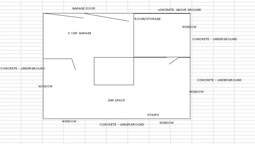

I think at this point I will concentrate on isolating the windows and doors, the ceiling which connects to my unit, and the wall separating the garage from the studio. The concrete I believe will be thick enough to keep the sound in the house.. My budget is kind of flexible, maybe in the order of 1000 to 2000 dollars or so in materials if that's realistic.
I'm including a diagram of the space.

Why not post some now. I'd like to see EVERY condition you have. HVAC ducts, pipes, ceiling/joist wall connections etc. And what is the rectangle in the middle of the room?
