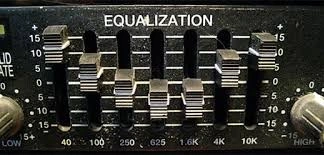

He is talking about 'scooping'.. What is this ?.
bichon
Basically, it's the 'scooping out' of frequencies in the EQ band. One version is referred to as a 'smiley', as can be seen here:
ahh lol.. sort of what i learned how to do , because my kick drum and bass were fighting for the same frequencies... couldn't figure out why everything came out muddy.
