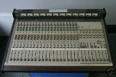

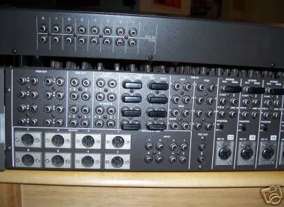

The Tascam M520 has:
-> 20 inputs: 20 XLR's + phantom pwr, 2 1/4" HiZ line inputs on first 2 channels
-> 8 pgm busses
-> 4 aux's (2-stereo pairs)
-> 16 tape returns
-> 3-band sweepable EQ/each channel
-> 28 Access-Snd>Rcv patch points (on each of 20-channels & 8-busses)
-> -10 to +4 line amp/onboard
-> 12 VU meters
SEE: Tascam M520, aerial view:

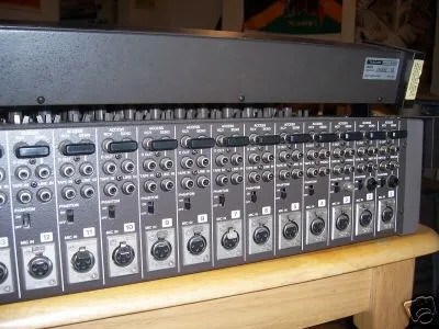

(m520) Back panel, right........... ;)
(m520) Back panel, left............. ;)

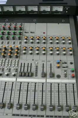

(m520) Tape return & master fader section.............. ;)

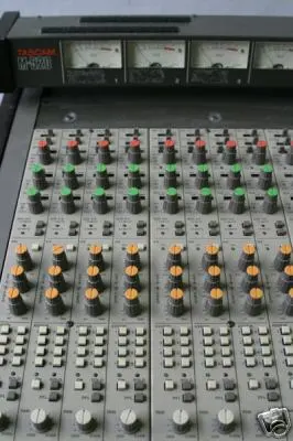

(m520) Top>bottom: Input Select, PAD, TRIM, AUX, EQ, ASSIGN, PAN.............. ;)

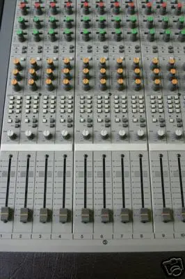

(M520) Featuring, long-throw 100mm faders................ :eek:

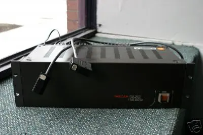

(M520) Should always include external power supply and cable! Don't leave Ebay without 'em!.......... ;)
