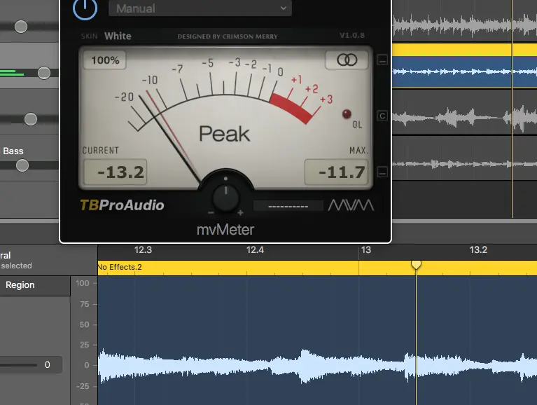

If you're recording 24-bit, you don't actually need to see a wave form. Just slap a metering plugin in GB and watch the peaks there. (I checked my GB and see I have something called TBProAudio's mvMeter - Logic has a couple digital ones but not GB, alas.) You can always put a Gain plugin on the track if you really have to bring it up after recording, but the 24-bitness of it should give you all the dynamic range you need to manipulate it.

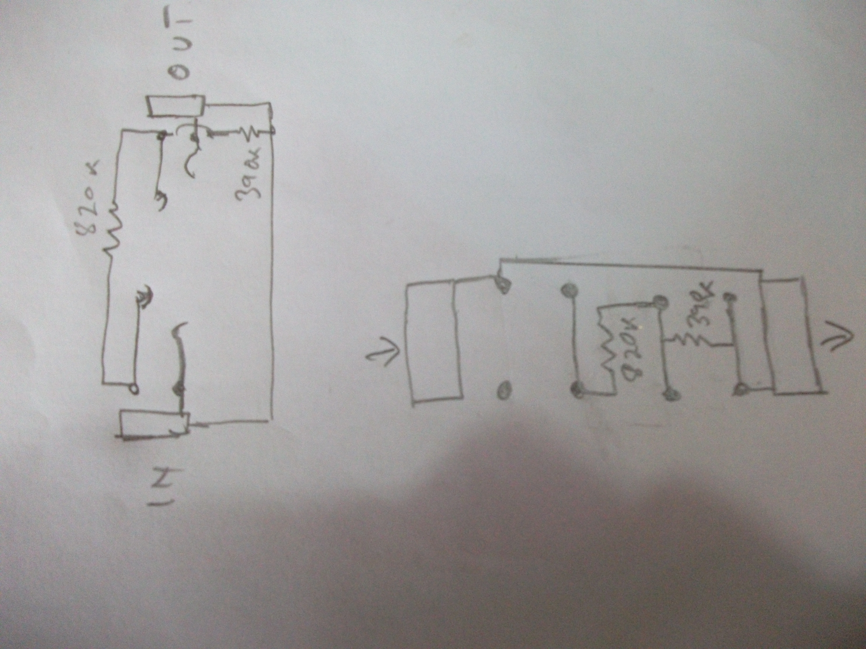

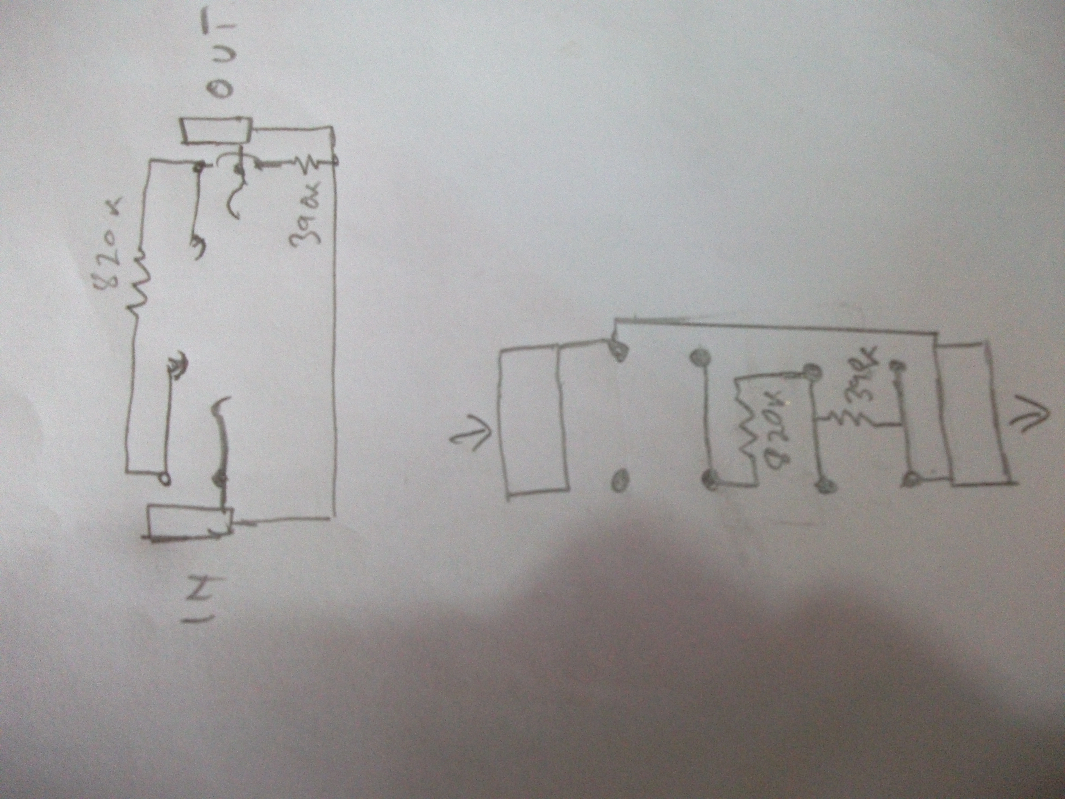

I am meaning a resistive attenuator. A series 820k Ohm and a 390k shunt, signal goes from the junction. I shall post schematic and layout drawing in'morning. That will reduce the level by about 12dB.

Sorry for the crudity of the calligraphy!
The attenuator will insert a loss of about 12dB but the exact amount depends on the guitar's output impedance. The input Z is 1.1M.
N.B. The cable connecting the output jack to the high Z AI input needs to be kept very short, 1mtr max, preff 330mm because the output Z is high at about 280k and you will get HF loss on a long cable. Of course, you could dispense with the second jack and just have a flying lead.
Naturally it all needs to be in an earthed metal tin.

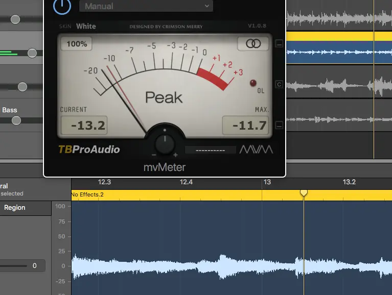

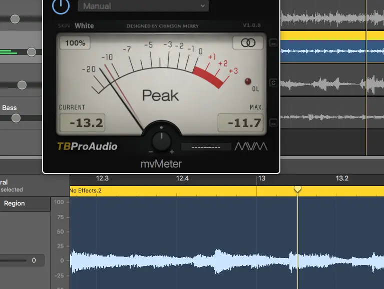

I'm sure you know this, but if you double-click the region you get an expanded view in the bottom frame. Even something with peaks of -10dB or less is pretty visible for editing in that view. Not as nice as Logic's ability to expand just the waveform vertically, but better than working in the smaller track.
