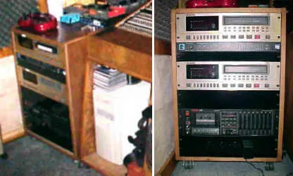

Rack mounted equipment is standard 19" wide so if you build your own rack (which I highly recomend) the INSIDE demension should be about 19 1/8" or there abouts. You don't HAVE to by rack rails but they are nice. If you build the box out of 3/4" plywood just add a strip inside on each side as rails and will work out nicely. I've built several of these.
Nice Rack Rat!
I also built my own, but I used a customised kit to do so. The music store stapeled the woodwork together and cut the profiles of the doors to 45 degrees. The long L strips and all the other hardware were supplied with the kit. It took me 1 saturday to build it, and it saved me about 50% of the price!
