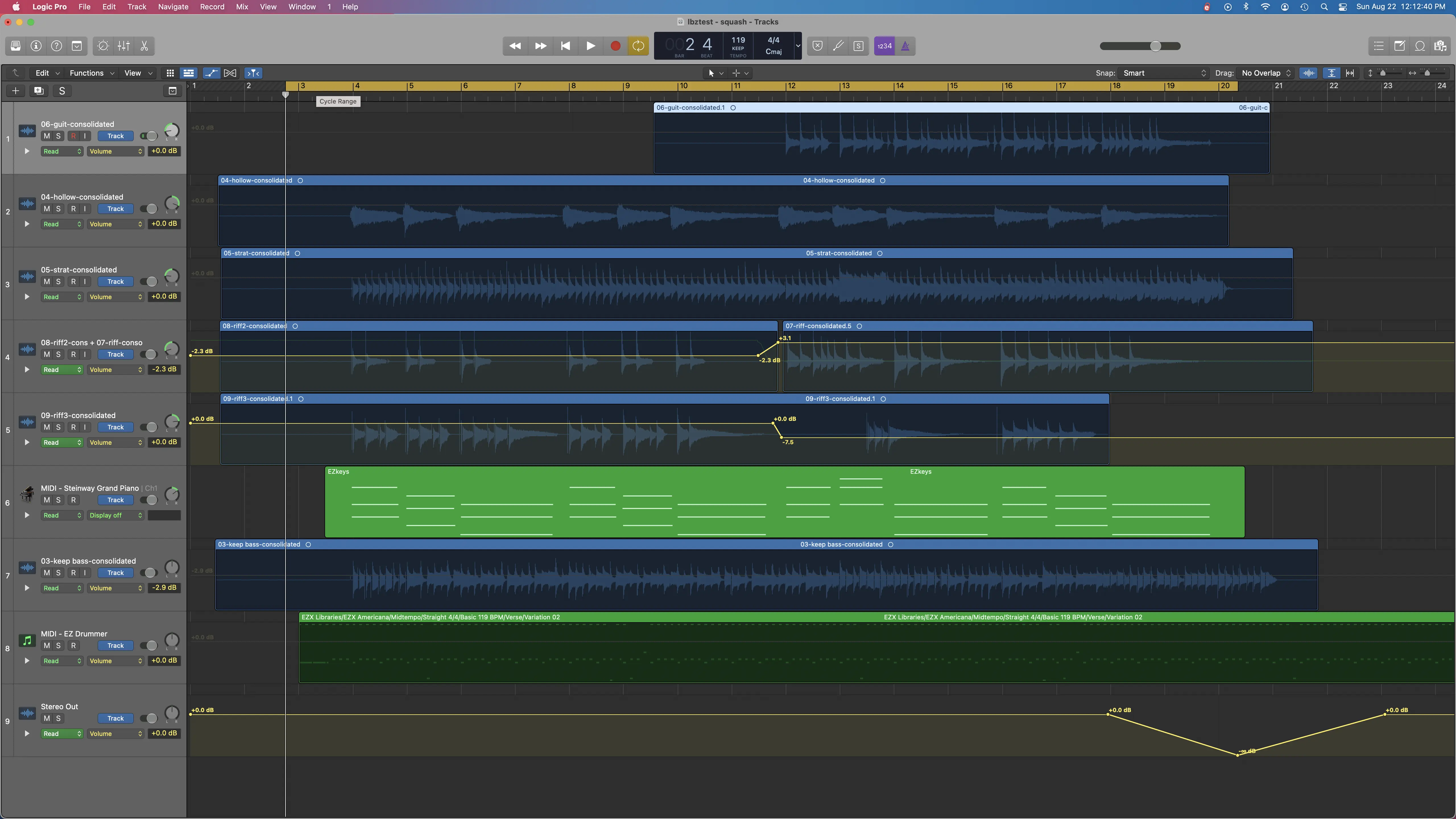

Nothing was added, and I probably did have EQ on different tracks. Because the tracks didn't appear to line up perfectly, I wasn't sure where things went, so I just got the EZD track set with whatever the default kit was for my old EZD2 stuff, and tinkered a little with timing the hits more metronomically. I used that to align some of the rhythm tracks and maybe bass - just minor stuff, but it was too loose for my ear.
I pasted a copy of the guitar regions together (end to end) or one track I also ran the guitars through some amp sims, probably just a Fender and Vox combo with more gain, and yes with amp reverb and tremolo. There's a little automation on volume and also on panning where I move the lead into the center more when it starts.
Yes, parts probably got slid around a bit as I was lining things up. But, as suggested, I started with the drums, then I added the bass, got happy, probably keys, next long rhythm guitar tracks, and finally lead guitar. A little bit of compression on the mix bus. iZotope "maximizer" to push it to that -12dB LUFS - kind of arbitrary but it seemed like you wanted something in the louder range.
Like I said, I didn't listen to anything else. I basically work from the rhythm, and I'd say the main thing I noticed (in your tracks) that created work at start was the timing is not sharp. I mean, this doesn't have to be perfect, like electronica stuff, but if there's a drummer, then the bass and the drummer need to really be in sync, and that main rhythm guitar has to lock in. Now, you can create space in the middle for the singer, leads, whatever, and they can go crazy, but it should really hang with just the basics.
P.S. (edit): screen shot of the project attached. I actually only put amp sims on guitars & bass, except 09-riff3-consolidated had nothing. No EQ or compression on individual tracks, but there is some one the master. The MIDI keys were mapped to a Steinway Grand (by default?) - I just left it there.
P.P.S. I did use Logic, too, but did not "quantize" any tracks. Just use "timeflex" FlexTime to individually do a little bit of stretch or squeeze in a couple places where I noticed it. I'm sure there's more or less that could be done, as different folks prefer.

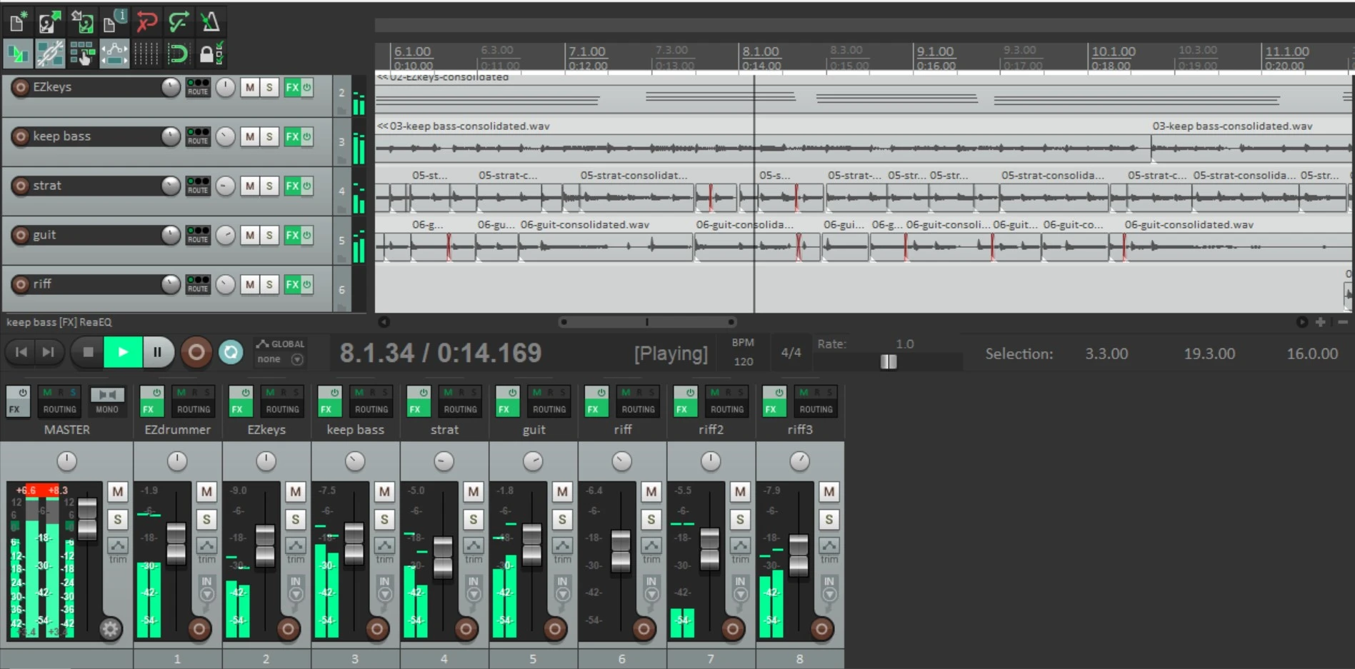

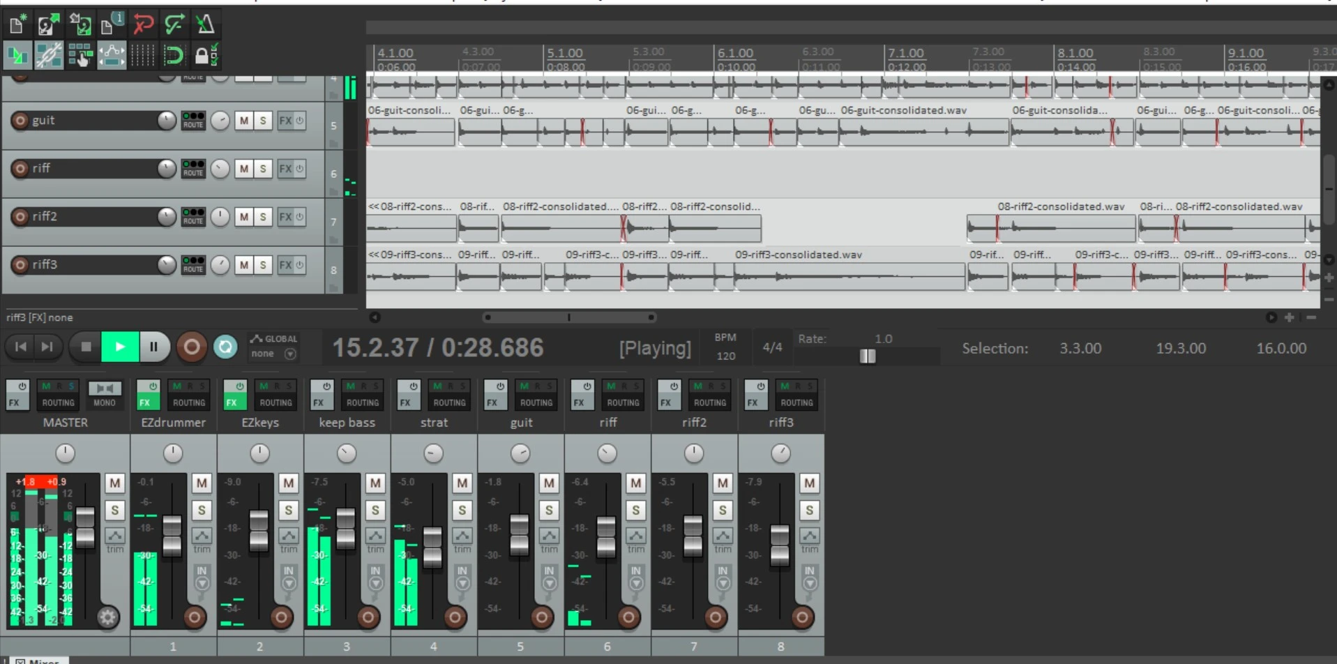

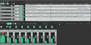

Does this look or sound time fixed? I also deleted the hollow body guitar, being slightly out of tune.
pic
Every track has a HPF LPF set added. Guitars are 250-10,000hz., Bass is 80- up , Drums are 80-10,000Hz and a master limiter on the mains.

18 and 23 are both nice.
I chopped the song up too much, then decided to change the settings. Reaper is now at less than 2 seconds latency. The timing is fixed. The latency buffer in UA console was turned off. It needed to match the DAW and was set to medium. It adds samples and size to match, or at least needs to be turned on.
