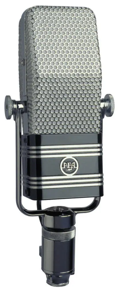

If price was no object, I'd indeed get one of them RCA 44 clones, the AEA R44 Series. It is so pricey, though, that they have a separate pdf price list for it!:eek: :D
AEA R44C
Hand-crafted, museum quality, 44 reproduction
The AEA R44C has the authentic sound, feel and look of the 1936-38 RCA-44. A museum quality replica hand made by AEA using 1.8 micron ribbon material originally manufactured by RCA. Museum grade version features details such as a bronze investment cast yoke rather than the factory zinc yoke. The ribbon element is only 1.8 microns thick, fabricated from material originally manufactured for RCA. The black and chrome "radio" finish is standard. Parts are interchangeable with the original RCA 44B and BX. R44C parts are also interchangeable with the original RCA 44B and BX. The microphone package includes a three meter cloth covered Accusound Silver Studio Pro cable, a zippered canvas bag, and AEA 44VC vertical case for proper shipping and storage.

If you recall, the R44 was near the top of my "if price were no object list". I talked with Wes about it some months ago, when I was discussing preamp requirements for ribbon mikes in general. At some point the R44 came up. He pointed out that it is quite a large and heavy mike (8 lbs., IIRC!). He also makes the R84, which has the same basic transducer, but he had his shop guys design a simpler, smaller, easier and cheaper-to-make body so he could sell that same basic mike to "married guys!" (His exact words). Then there is the R88, a stereo version which is also more open (less protected) and is generally designed to only be used with a fairly large source to mike distance (miking an ensemble in a nice sounding room).
They aren't so impressive to look at, but one nice feature of the M130s is that they have the smooth, effortless sound of good ribbon mikes, but they are very small and lightweight, which makes them very easy to use around the studio, particularly in coincident or near coincident stereo pickup patterns where both mikes are on one stand. A lot easier to deal with two mikes on the same stand (and mike bar) when each one weighs five ounces, rather then eight pounds!
I should add that the M160, the hypercardioid version, is quite popular, too, perhaps more so. The directional pattern is handy when you can't stand to have sensitivity to the rear (the way I work I actually prefer to have the figure-8 pattern most of the time) and the M160/M130 combo is perhaps the best M/S pairing on the planet, so having both is a good thing. I guess my take on the "can't ever have too many microphones" is you "can't ever have too many really nice ribbon mikes". :)
