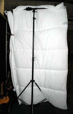

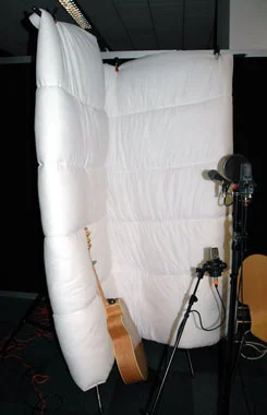

...and while we're on the subject, here's a budget 'vocal booth' [front & rear], made out of a couple of duvets, booms stands and clips. [Not my photos - found 'em online sometime back].:eek::D

Daniel...that picture makes me want to take a nap!
