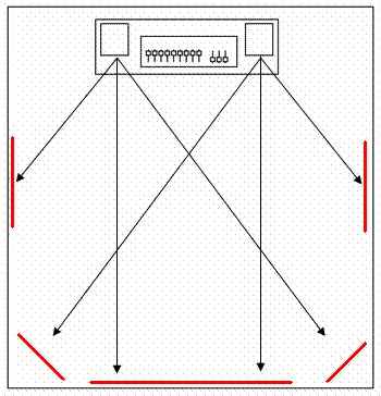

The "challenge" is to get your room sounding good for both tracking and mixing. If I were in your spot, I would hang panels in the corners to deal with bass build-up first, followed by wall treatment placed where the primary reflections would occur. I drew a little mock-up of what that might look like... the red boxes would represent acoustic panels and how they might be placed to diffuse the reflections. Use your thickest material in the corners.
Makes sense. I'll use the thick foam for bass traps. So they only have to be in the corners where the walls meet, not the walls and the ceiling? your drawing appears that way.
