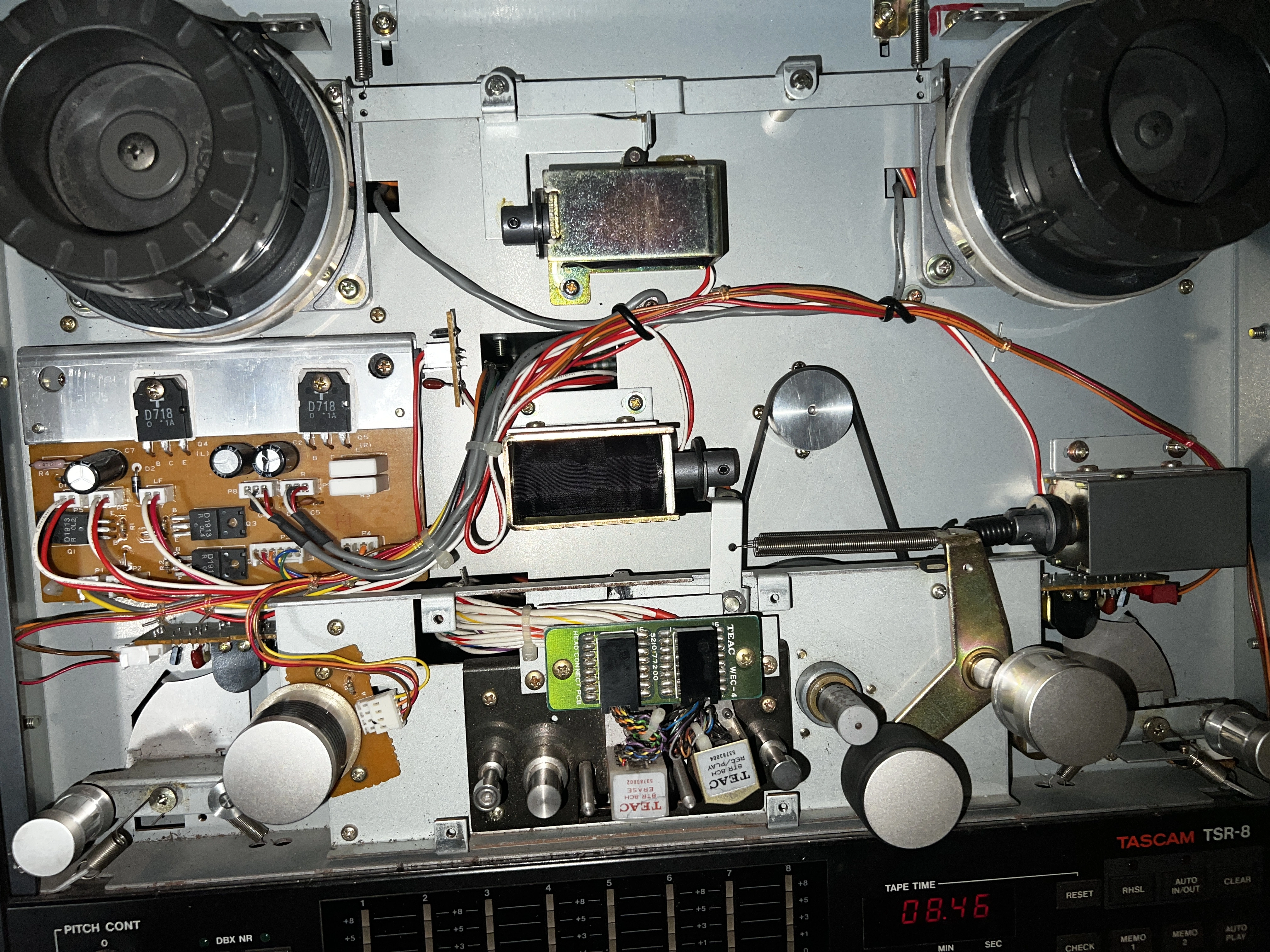

Hey guys. I’m new here. I have a Tascam Tsr8. I took off the front panel to make sure the belt was ok. When I put it back on I have no input signal, no playback, and no vu activity on all channels. Does anyone know what might be going on? Everything else is operating normal.

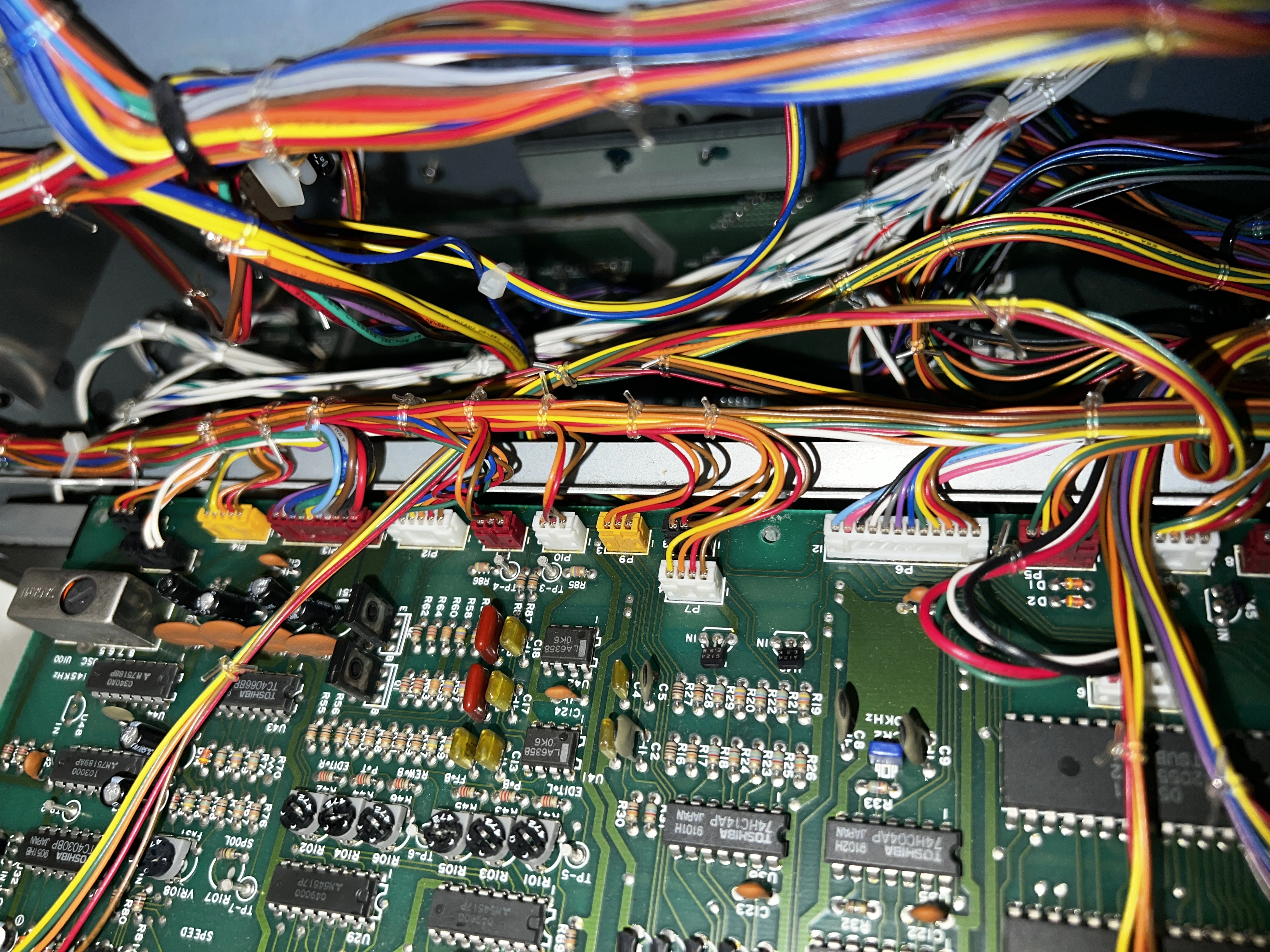

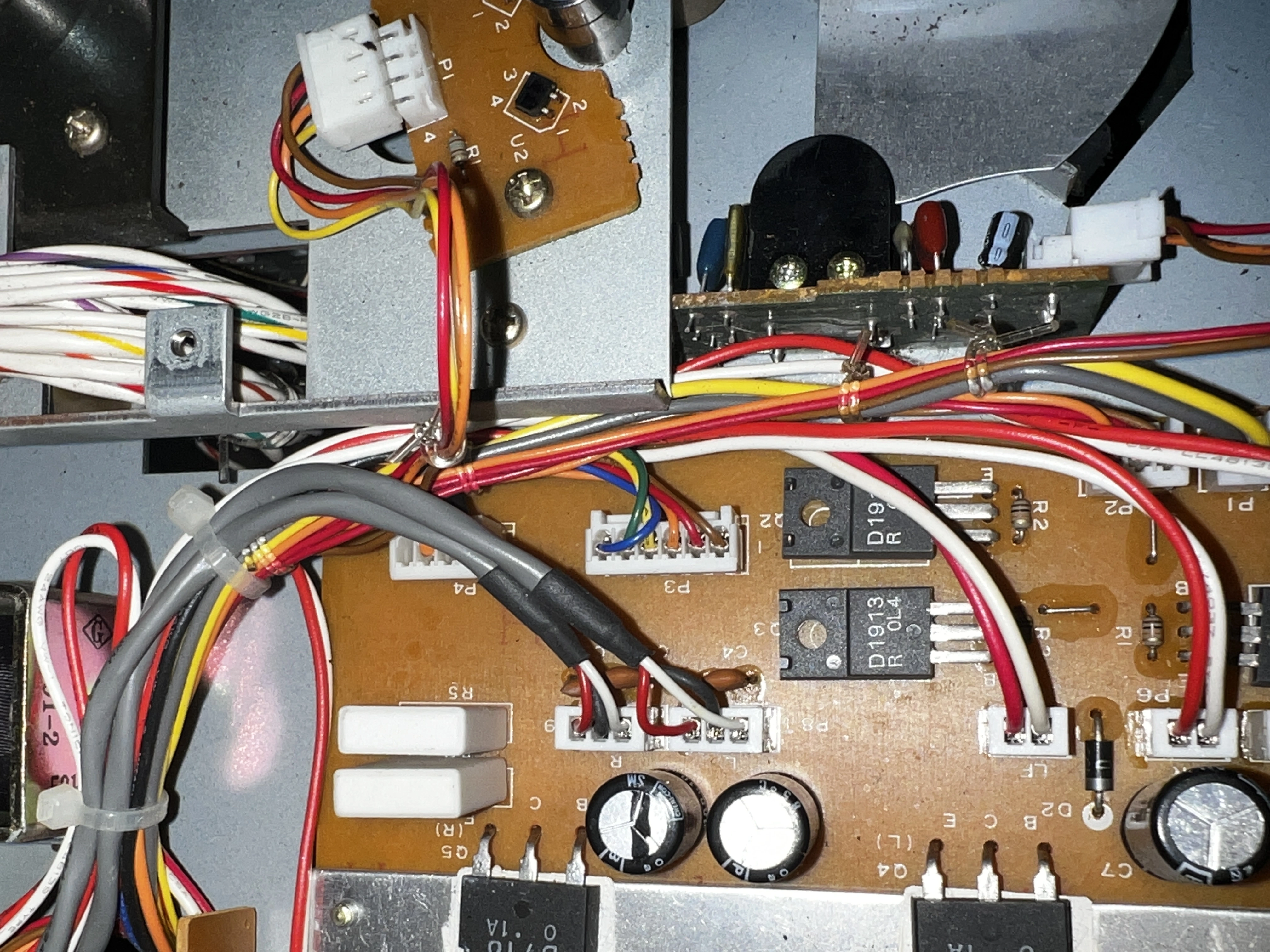

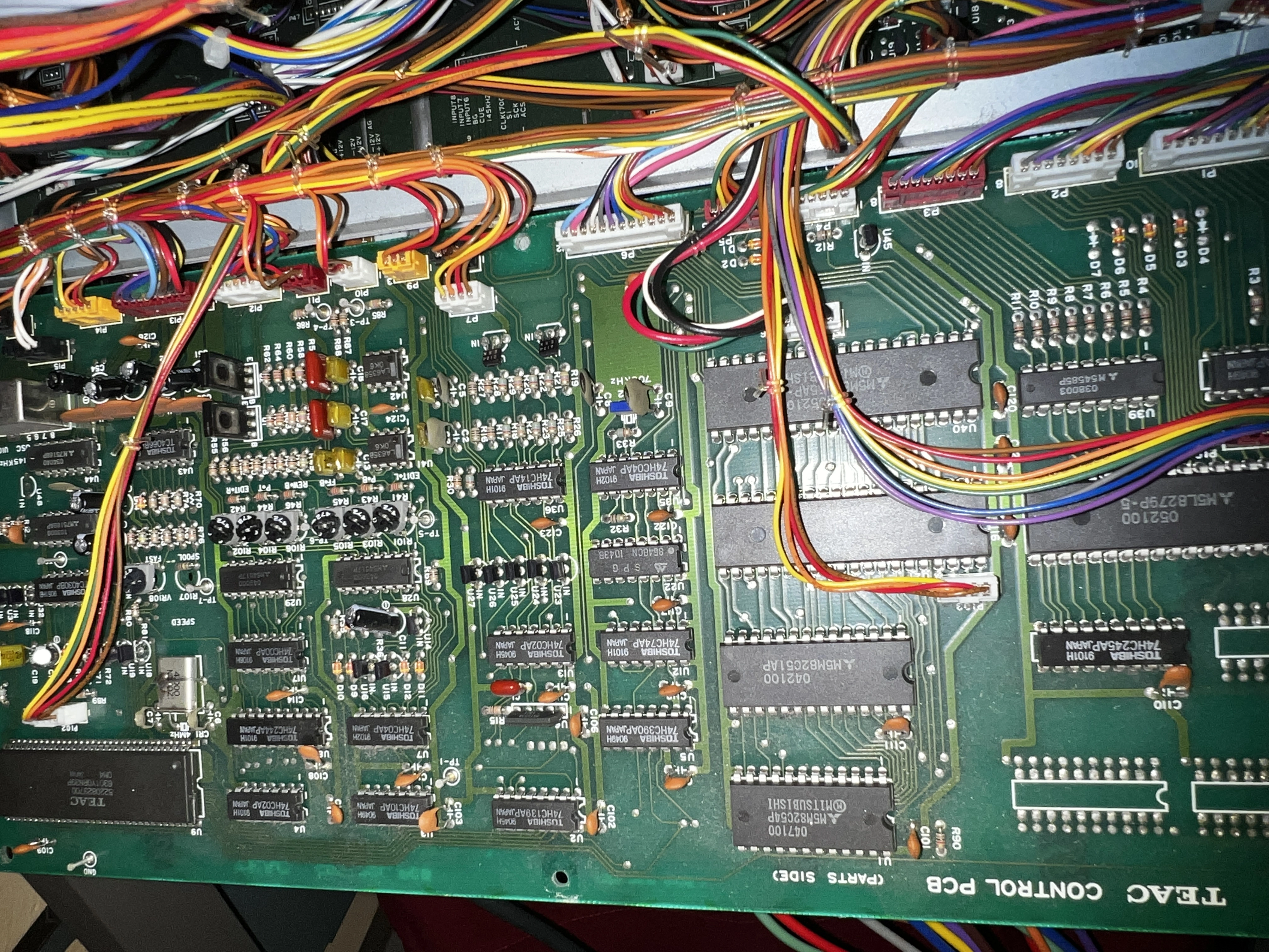

Attached are some pics if that helps

I’m not familiar with the guts of this machine, but in the bottom right hand corner that 4 wire plug going to the small board looks off.,
I think that's just the perspective. Also, that's the sensor board for the counter/tach roller so it's unlikely to affect the meter panel.

Hi, if you need a tech I can give you his name by message. He's near Los Angeles, to my knowledge he doesn't fix things by mail. Fortunately he had the parts, I brought some parts, and others could be fixed. The lack of signal ended up being the transistors and the p.s. reg. on the power supply. Also fuses f1 and f2 had to be replaced. There were other minor things he was able to repair to bring back to factory spec. The lesson in this was, always go to a good tech if you have one. I was nervous, but actually got it done at a really fair rate. Less than what it would've been if I would've bought replacement parts on ebay and tried to fix it myself. Also he was able to find little things that could cause an issue down the line and repair those.
