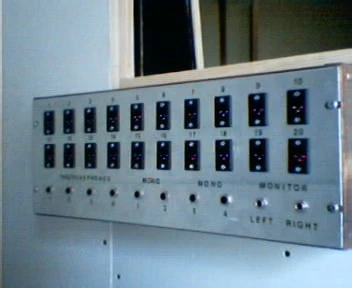

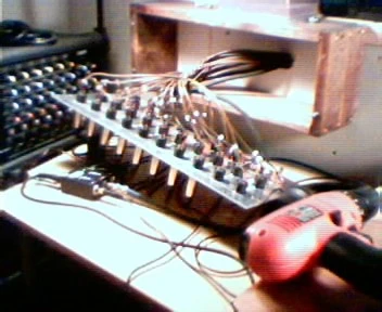

Here's what the panel looks like from the back. Using my machinist tools I laid out the marks for the hole positions- all of them including xlr screw holes. Punched the marks. I then cut out the xlr holes with a 13/16 pilot/hole saw. I then mounted all connectors to the the face. I then soldered all wires(purchased at clark and wire) that I pre cut at an 8 foot length (making sure it would snake between the walls and come out on the other end with trim left over) to the connectors with some help. It is pretty tough to hold the wires and solder at the same time. I put shrink tubing on all of the sheild(bare wire) so that it will not short on any of the other surrounding wires. I used plenty of solder. Not enough solder can result in having weak signals. With one side soldered and mounted on the box I snaked the wire through the wall and soldered the other end on. I went to staples and bought some transfer letters "designators" 1,2,3,4,5...etc i have 20 xlr 4 trs 4 mono 2 -1/4" speaker(soldered speaker wire). Having 4 headphone jacks means I can turn up the sound on 4 independent channels with the rolls headphone amp. Without the musician having to get up and turn it up himself or herself. Well that pretty much it . i am not an expert by no means I just had to make do by any means necessary.

Well, the xlr's have a back to them. So, at least there's some blockage of the hole in the wall plate. But the 1/4" phones don't have a back to them... at least not the ones I've seen, so its a open hole through the wall plate.
How do you avoid that open hole on the 1/4" phone?
Oh. I'm looking at your picture again. I think I see now.
All of your cables are routed through a small penetration on the back of the wall plate. Which I imagine is all sealed up nice and snug. ;)
I thought the idea would be NOT to do that (route all cables through a single, small hole) that way, if a cable went bad, you could just un-screw the xlr, unsolder one end, and use the old cable to pull a new one through.
Makes sense now.
Michael, it's next to impossible (especially if plates are offset from one side of the wall to the other, as they should be) to pull a new cable in with an old one, unless it's all in conduit - and using conduit negates the sound isolation by a LOT - normally, cables inside walls don't go bad in the owner's lifetime - only occasionally at solder joints (if done poorly) or if they're flexed a lot.
For sound walls, you're probably better off just adding a couple of spares (labeled on both ends) before sealing the boxes, and leaving the pigtail coiled up inside the box at each end for future replacement or expansion... Steve
