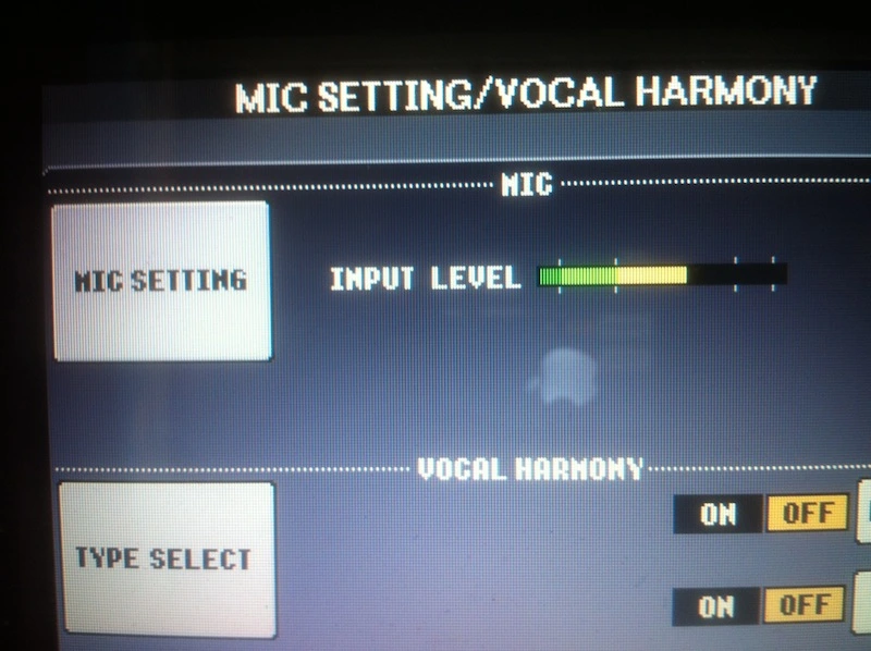

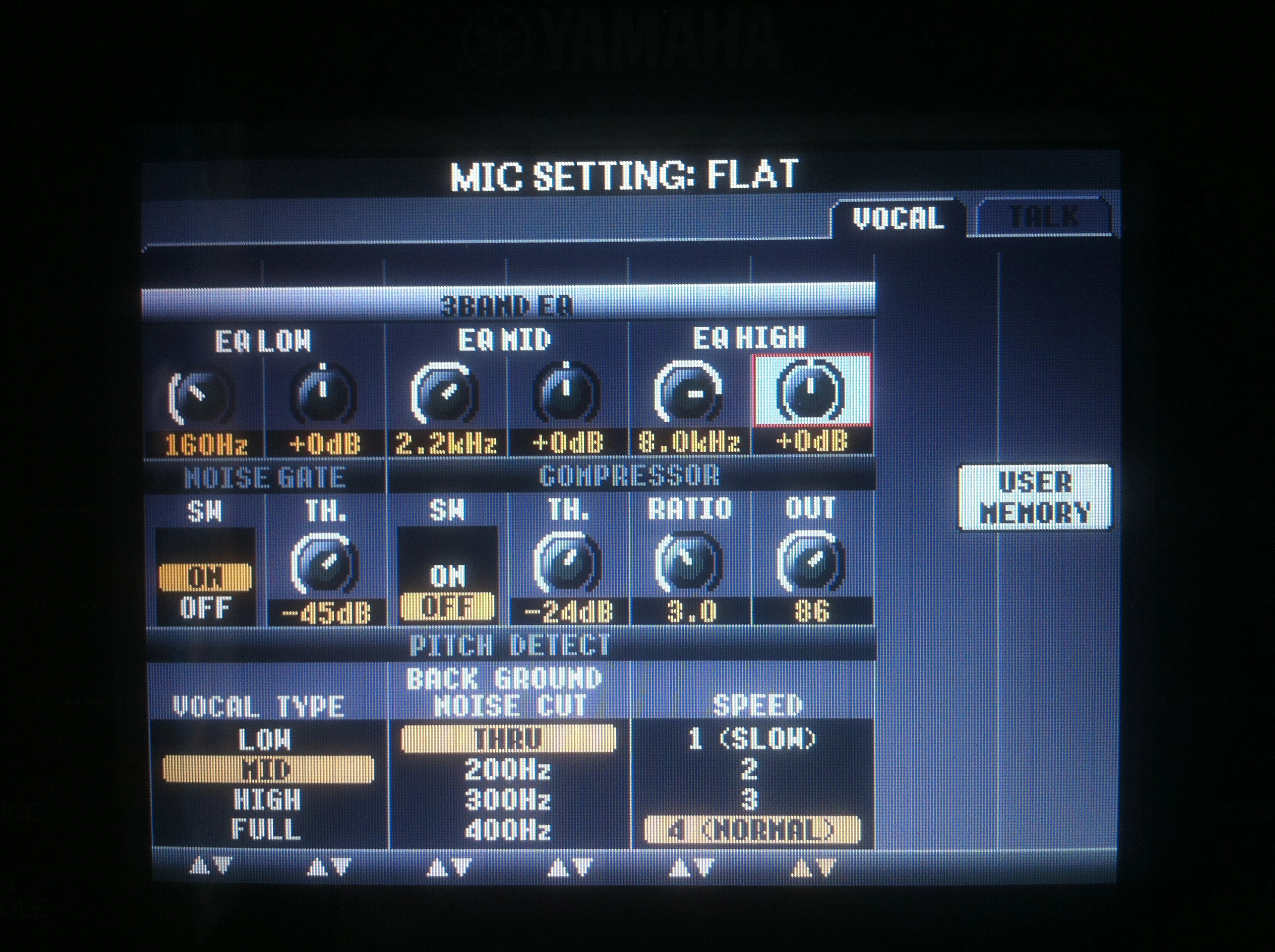

Arcaxis: I'm not sure if i did it correctly as the images below shows. I've also toggled the switch from MIC input to LINE input at the back of the keyboard. Also, I always wanted to clarify if i should be singing within the yellow range, or the green range of the Mic Input Level as I've always been adjusting the volume so it hangs around the yellow area.

The yellow is the perfect place to be on your meters. :)
Those pics show no eq at all. Perfectly flat.
It looks to me like 'background noise cut' is your high pass filter.
Try it at 200hz. You should notice some mud disappearing.
400hz is probably too far, but play around and see.
For a high frequency boost, set your 'eq high' to +6db or so, then sweep the other knob (kHz) up and down to hear the different choices that you have.
If/When you find a frequency that sounds well when boosted, maybe reduce the amount to a few db.......Whatever fits.
Maybe you won't need a boost at all!
