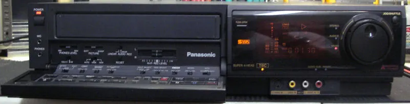

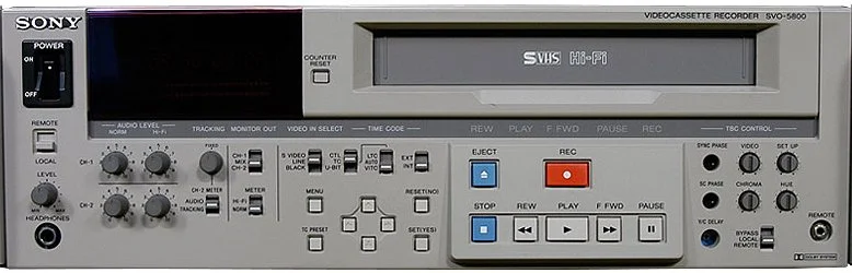

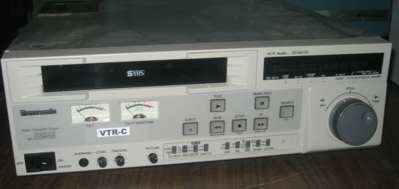

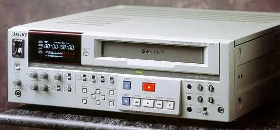

Let me make an assumption (nah!) that the "glories" of video Hifi were remembered from and referred back to the days when the Hifi audio tracks levels were manually set by input level controls.
Some "outdated" VHS Hifi decks for "pro" use still have the L/R-Hifi tracks set with manual controls and VU meters. I'd only consider serious mastering to a deck like that, so ref: Sony and Panasonic on eBay.

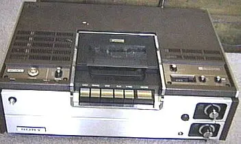

I remember those early consumer Sony Beta decks...they were huge, with the two big manual detented dials on the front face... :cool:
It's Pro, baby,...
all Pro!............:eek:;)

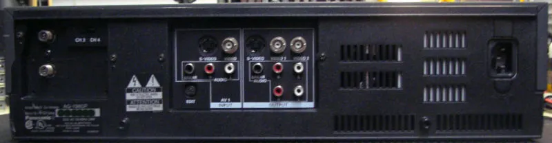

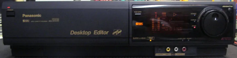

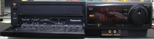

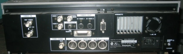

Those 3 S-VHS Hifi decks I cited above would put you in the territory of...
not just audio mastering, but maybe of making legit Hifi audio music videos!
Not only w/ live shoots, but many of these decks would sync to SMPTE, or could drive it. The lofi linear tracks could be used for timecode, etc.
