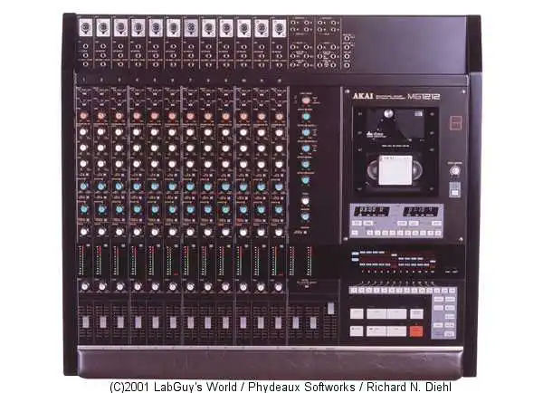

Been there & done that, in the mid 80's, with the Akai MG-1212. :eek:
A Reel Person said:
but this whole 1/2" cartridge "port-a-studio" is feasible, alright.
Sweet machine! Thanks Dave! :)
How many tracks on that bad boy ?? What was the speed ?
~Daniel
With the TASCAM 388 readily available and its reliance on regular open reel tape, no wonder the Akai 1212 didn't make a dent in the market.
Anyway, from the Akai 1212 manual (got it on their site) it says that the recorder employed 3 "Super GX" heads (I assume glass heads ??) and speeds of 19 cm/s, 9.5 cm/s on 14 tracks/4 channel 1/2" tape. It also had dbx 1 NR!
Pretty interesting and highly original.
Daniel
Yes.
For the rest of us, it's 7.5ips and 3-3/4ips,... 12 tracks I believe.
... but I'm not arguing with the guy who went to the Akai site.
Some of those "official" and "manufacturer" sites sometimes post little inaccuracies about their own legacy gear,... such as when Tascambbs posted that the 244 was released in 1984, when most of us had them in 1982.
The Akai MG-1212 was 12 tracks on a 1/2" analog tape cartridge, comparable in size to a Beta cartridge.

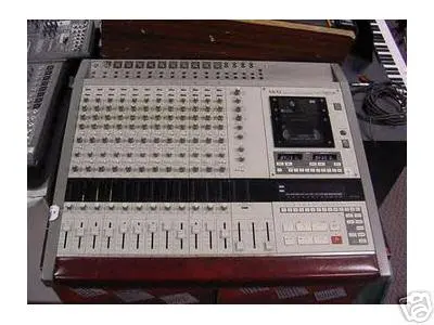

Exhibit B: The Akai MG-1214

Dave,
I took the info from the actual 1212 manual that Akai Pro had uploaded and changed to a pdf file online:
Here's the direct link and the info can be found on page 4 of the manual.
http://www.akaipro.co.jp/global/archiveOM/MG1212om.zip
Thanks :)
Daniel
The 13th and 14th tracks are not for normal audio.
The 13th track is a sync channel for recording SMTPE time code and the 14th track is a Continuity track which records a proprietary code for the unit so that it perform automated pinch in and outs with greater accuracy that doesn't depend on the time counter solely as a means of locating these parts on the tape as counters do drift from slippage and other design foibles.
Cheers! :)
