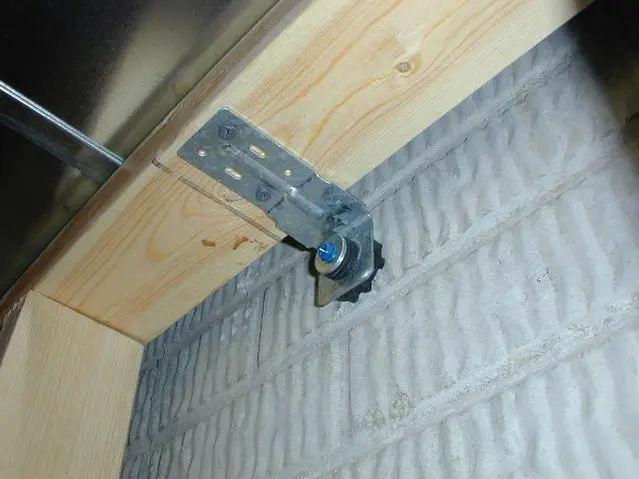

Then hang your drywall with GG. You will want to connect the top plate of these walls with clips to the joists.
Hello John. Say, are those "clips" in the photo a "resiliant isolator" (RSIC)type clip? I can't tell from the photo. See one below tied directly to a block wall.
However, if they are simply "ties"(which some local codes may require), these would NOT decouple the framing from the block wall NOR the roof. Direct structural transmission can occur from this type of connection. The best way is to build whats known as a "decoupled anti-sway brackets", OR use "resiliant Isolators" (RSIC)of a type designed for this application.

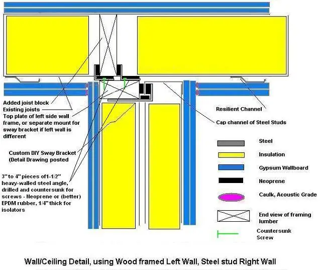

Another thing. I've never heard anyone use GG to attach drywall to framing. I could be wrong, but I don't think it was designed for that application, nor would it be code compliant. If you use RSIC to decouple the framing from the exterior shell, then you don't need to decouple the drywall from the framing. Below is a drawing by Knightfly, illustrating an "anti-sway bracket on TWO partition walls, but the idea is the same for an interior leaf assemby.

Hi Fitz,
You are correct, That is an RSIV DC04 Clip in the Pic I posted. The same one it looks like you posted. The Knightfly drawing is a very good illustration.
