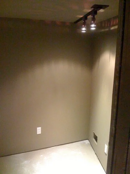

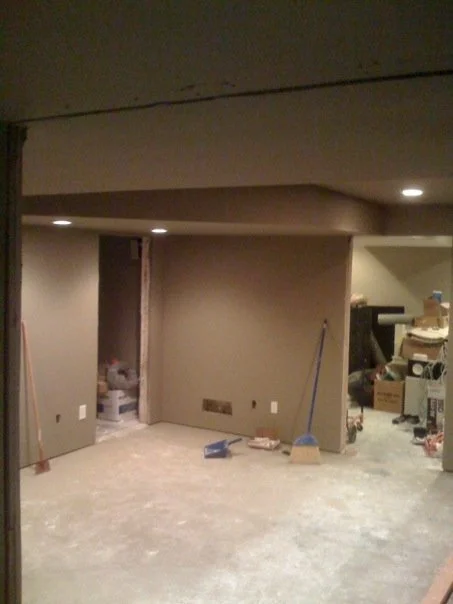

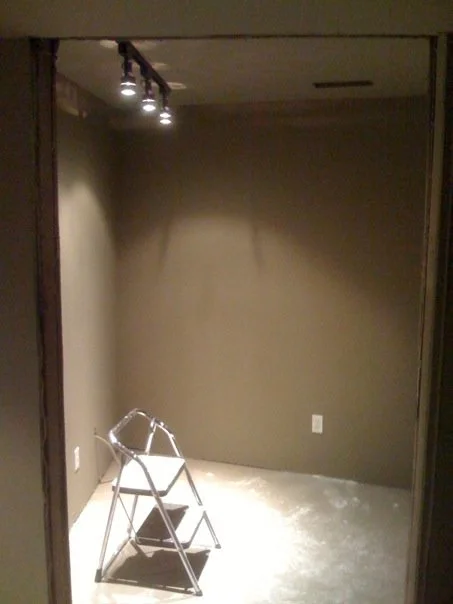

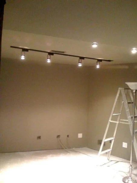

Sorry for the crappy pictures, but here are some shots of my rooms which are FINALLY nearing completion.
Long story, but the city sort of forced me to complete the space.
Doors went on order today... trim arrives this next week... carpet and flooring is being worked out as we speak.
Enjoy!!
Jim

The details are as follows:
4 rooms-
dedicated control room
dedicated drum room (though small... will act also as another "booth")
dedicated vocal room
home theater room, which doubles as a larger live room
All rooms are in the basement with no windows. All walls are two layers 5/8 drywall hung on resilient channel with proper caulking around corners/seams and fire putty packs around all wall outlets etc.
HVAC is shared with the rest of the house, but is structurally isolated from the main trunks etc. So far it seems to work really well (though I won't know entirely until I get the doors put up).
Doors are all 1 3/4 solid core doors on exterior jambs with thresholds and ball-bearing hinges.
There are two doors between the control room and drum room and between the control room and live room, just to help out a little.
Trim is on order, but I have to work out how to attach it (since I can't nail it to studs). I'm thinking of using finish screws and fastening it to the RC.
I'll grab more pics when I get a chance.
Jim
