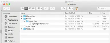

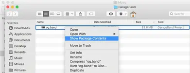

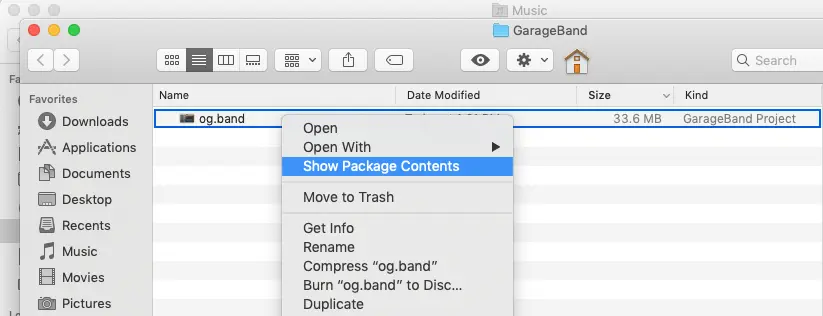

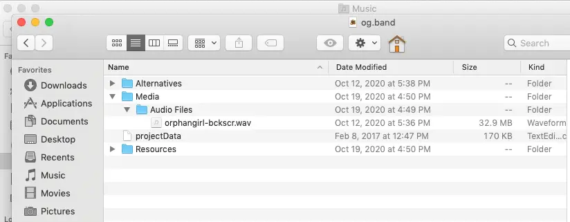

When using GarageBand, if you have a track you like that is supposed to be sent elsewhere to mix, then I would simply open the project, which appears to be a single file, but really is a directory. Select the project file, right-click and click Show Package Contents. Then, expand the folders to display the Media/Audio content, and the WAV file will be there. You can edit that with Audacity before sending it if you want to trim it up.
p.s. You can do the same thing with Logic Pro "project" files, too.
