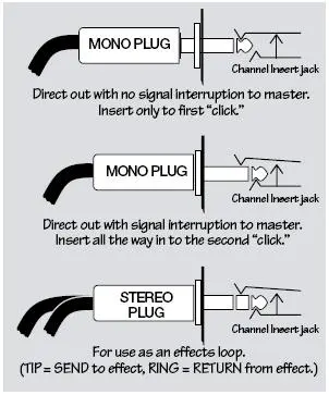

what exactly do you mean, LemonTree? USe the Group 1-2 and the ST outs instead of the insert i/os?
I found this diagram in a Mackie manual. Would this apply to the Yamaha mixers as well? Would the polarity issue also still be there?
I guess my question that I had earlier is, if a company takes the time to provide balanced mic level XLR and/or balanced line level phono connectors on a channel input, why would you want to use an unbalanced insert/direct out to your ADCs? I'm having a difficult time wrapping my mind around this. I must have undiagnosed OCD!
