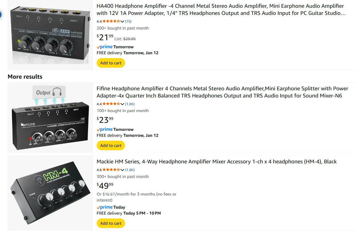

Don't worry about having 2 headphone jacks on the interface. You can get a Behringer MicroAMP HA400 for $20. Get a good interface with a midi input. A MOTU M2 or M4 are good, and have both audio and midi inputs. A Universal Audio Volt 2 is similar. Both are current models and should have decent support.

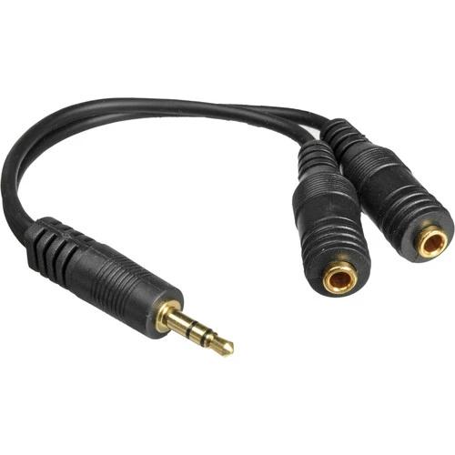

get a headphone splitter, like this

get a headphone splitter, like this.
Those will work, but you can't adjust levels separately. Last week, when I was with friends playing, we had 3 different types of headphones and the levels were all different on the headphone amp. For $20, its money well spent.

3 different brands, 3 different prices and very likely identical and made in the same factory with different knobs and labeling. Amazon just check the reviews and roll with the least expensive that looks identical to the "Mackie"
I bought a Donner ( I buy their sustain pedals too) but they are out of stock @ $25 usually.
I’ve got the HA 400 and it works perfect for me if that helps anyone

Why? Well apart from the fact that is has a near state of art specification it has super stable drivers which translates to glitch free reproduction at low buffer settings and thus low latency. Yes, it only has one headphone jack but the wee Behringer is a steal, you would need to pay 4 times its price to better it and unlike a splitter you get individual volume control.

But the $21 headphone amps posted above look like a better idea, imo.
easier to turn a knob... and can be used with any interface or mixer you end up with.
