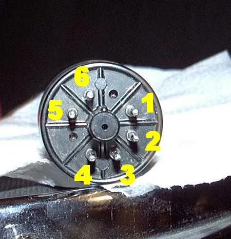

I'm going to post a pic of the bottom of tube and post a pic of the multimeter I'm gonna test them with. I need someone to walk me through this so I do it right.
Here's a pic of the tube.

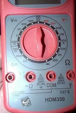

Here's a pic of the multimeter. I need to know where to plug the red and black cables in, where to set the dial, and which pins on the tube to test.

You can't test your tubes with a multi-meter. It really requires a good tube tester, and unfortunatly, there is no such thing. The old tube testers can give you some valid information, but they have one big flaw. They don't test tubes at full voltage.
Basically, the only way to really tell if a tube is working is to put it into an amp you know is good, and see if it sounds the way it should.

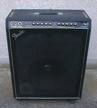

It's this kind of amp-

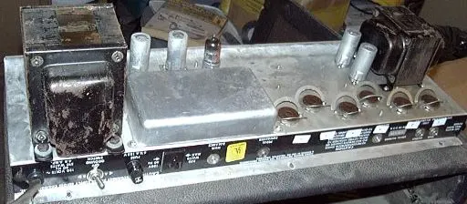

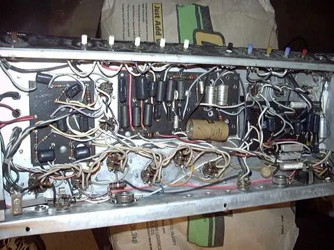

Here is the inside of the amp part of the cabinet-
The only reliable way to test tubes is in circuit. Years ago I used to work on radio equipment .... tubes test normal on a tester and break down in circuit. Usually changing tube capacitance is not critical in audio circuits to the point where the circuit fails.
Did you check to see in the filiments are lighted?
(in my best Boris Karloff voice) Bring it to my laboratory. I can make it speak.
Don't trash it. People like me will pay good money for it the way it is.
The worse thing that could be wrong with it is a bad power supply, and still that's not a catastrophe.
I don't fix amps professionally, but I've repaired plenty for myself, and friends. If you want to throw that one away. Throw it at me.

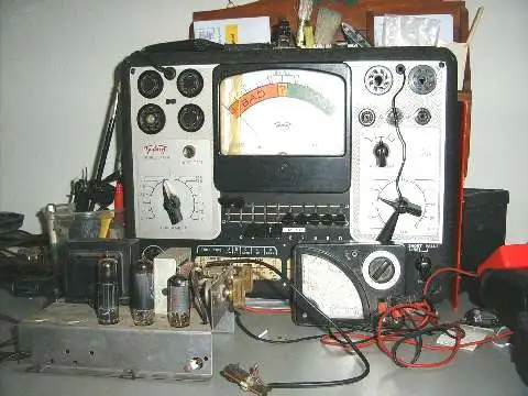

I paid 20 bucks for this tube tester. It's nuthin' fancy, but it serves it's purpose.
Use that multimeter to check the fuse.
That's where I would start.
Good call C7,...... I was going to suggest that myself...
If an amp just quits all of a sudden,..... thats the first place to look.... but it usually blows for a reason,.....
for example,... be sure to check the bottom of your new tubes to be certain the guide pin in the center is there,.....
if not,... the tube could be inserted wrong,.. and blow a fuse as soon as the amp is turned on...
there are many other reasons a fuse blows,.. but as C7 said,... I would start there....
tubes rarely go bad all at once,..... and with that many power tubes,.. it is either a fuse,.. or as someone else suggested,.. it could be the output transformer,... or ,.... there are many other choices,.....

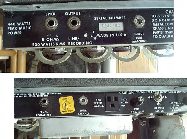

Here's a pic of the back, split in half. Do I need a 200 watt 8 ohm speaker?
