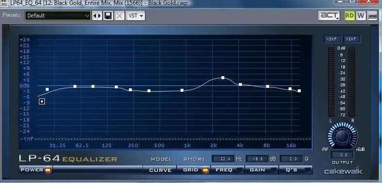

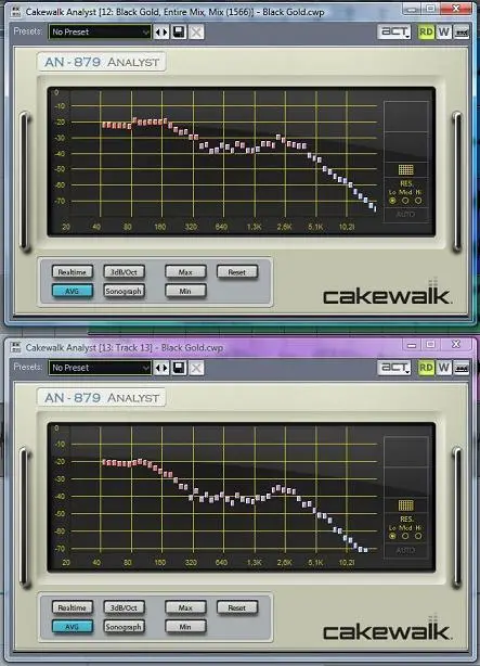

Now mixing. i was trying to get closer to the reference track which is Declaration Day by Iced Earth (yeah, i know we are not playing like iced earth in the first place, but still :)) and i used the spectrum analyst plugin from Sonar. As you can see on the attached screen shot called Spectrum.jpg the upper is mine and the lower is the reference and they are pretty close.
I have done this by means of the linear EQ plugin and the screen shot is attached too.
Still the difference in sound is obvious. So i would really appreciate any advice that will help my mix sound better than total crap:)

Gúitars could be a bit better, like Poetic Intensity said. Learn to rely on your ears when you EQ, not just a spectral analyser. You can't just copy a pattern from a commercial CD, they are recorded with different situations to a home studio. The song seems to be pretty promising, although too short to be able to comment on it properly. So you're off to a good start.....
