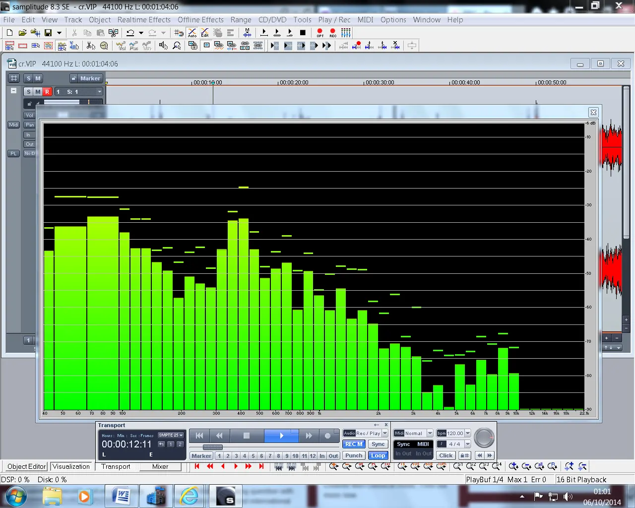

Capitol would not allow me to record at all on my 2496 soundcard at 96kHz, in fact it crashed Samplitude and I had to start a new project.
44.1kH was fine except it hesitated a good 10 secs before starting (Radio 3 never does that)
I would not expect a domestic DVD machine to record audio at other than 48kHz? In any case...
1) Just record the radio internally, prob' at 44.1kHz
2) Why 96k? The radio won't be coming in at that sample rate.
And I found the spectrum interesting. A brick wall at 10kHz! Radio 3 goes out to the 14kHz point.
