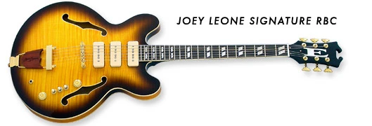

Well, that's what the two guitars I linked to in the first post do. 3 P-90s, 5-way switch.

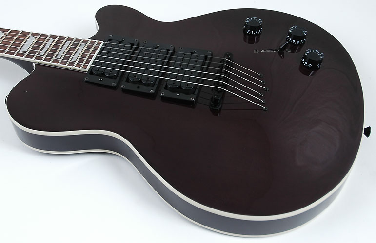

I just got myself one of these and was considering some P90s.
Any suggestions on what kind? I don't want to put a ton of money into a $150 guitar and I can't play for shit so.....
Would I put a bridge or neck pickup in the middle? Totally ignorant about guitars here.:o
http://www.rondomusic.com/wt445.html
If those are standard humbuckers, P-90s will not be a direct fit. P-90s are a bit wider than humbuckers, and a bit smaller in height. So you'd have to widen the holes and find some way to fill the gap in the other direction.

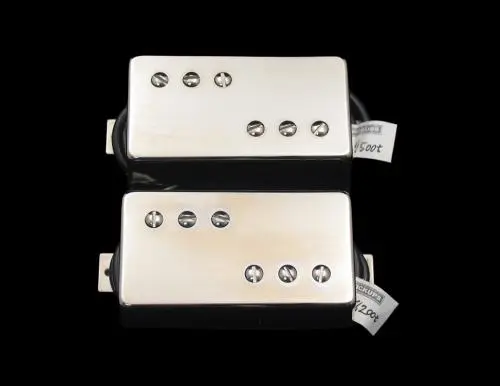

He also makes one he calls a P-92 which I am using in my Heritage H-555. Stellar P-90 tone in a drop-in humbucker replacement. It has two coils configured like a P-Bass pickup. It is even available with a black cover (the cover is required).

Thanks for the info guys. I definitely don't want to spend too much although I could always use a good set up pickups in future guitars. I bought this thing to tinker with and learn a little more about guitars in general.
I actually really like how it plays. I need to tweak the action a bit but the neck feels great and the shape and weight of it feels good as well. It looks great too. It looks purple in the picture but it's actually a black finish that's transparent enough to just barely see the wood grain through.:cool:
