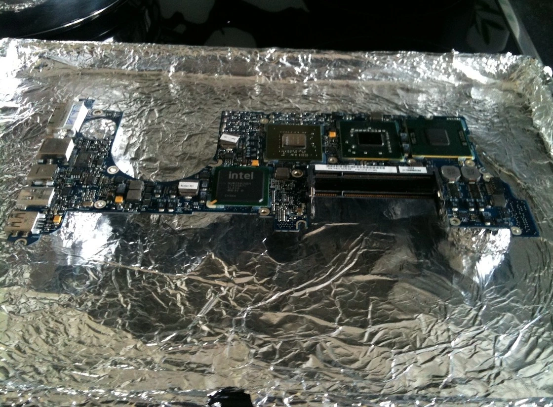

Had a to put a macbook pro logic board in the oven today, and I'm not joking. :p
That looks tasty! :drunk:

(Why did you put that board in the oven, Steen?)

The MBP was booting but had nothing on screen, no backlight, nothing from DVI output.
I figured either the GPU was dead which means replacing the logic board.
It was damaged when dropped and I could find nothing obviously wrong so I took a punt that maybe some solder joints had been fractured.
Baking it in the oven is a less than ideal way to allow the solder to reflow. Worked a charm. :)
Good! I would never have hazarded a thing like that myself!
