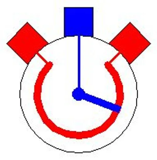

First, it is important to understand how a potentiometer works. Pots are also called variable resistors, which probably makes it easier to understand what they are doing.
In the diagram, the red track is a carbon track. This track is a resistance between the two red terminals. The blue terminal goes to a wiper that touches the carbon track. You move its position with the shaft of the control. the resistance between the blue terminal and the red terminals is relative to the position of the wiper.

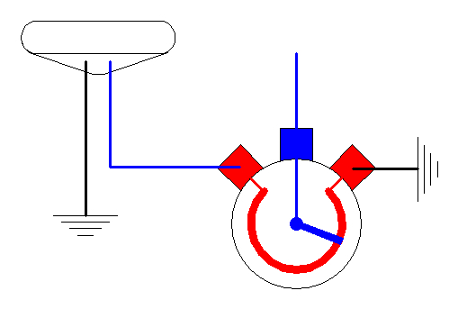

So, a volume control shunts a part of the signal to ground. The most basic form of guitar wiring would be a single pickup with a single volume control. The most common way to do this, and the way it is done on VAST majority of instruments, is to have the pickup hooked up to one end of the track, and the other end hooked up to ground. The wiper is conected to the output.

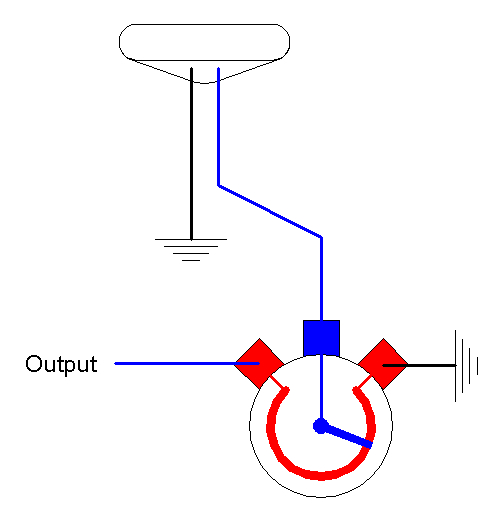

So, there is another way to wire a volume control, which is used on multiple volume instruments where you want the ability to blend the level precisely. The most common example of this is the Jazz Bass. This could, I suppose, be called pickup to ground. In this, the pickup is conected to the wiper, the output is conected to the end of the track opposite ground.

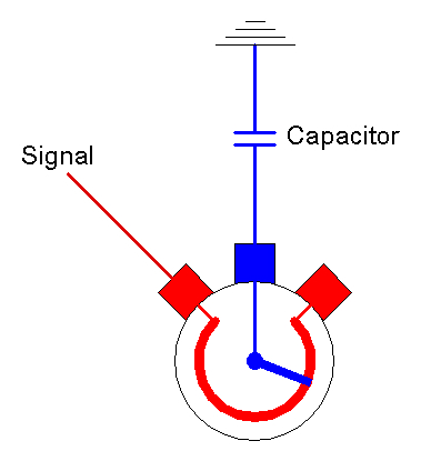

So volume controls are placed in line with the signal, or in series. Tone controls work differently. The are placed in parallel. The cap will pass frequencies above a certain cut off point (which is value dependant, with the cut off being higher on higher value caps). In a tone control, these frequencies get blead to ground, thus making the sound darker as you turn the control down.
Edit: Oops, I actually got this one backwards. The pickups should go to the other side of the track.

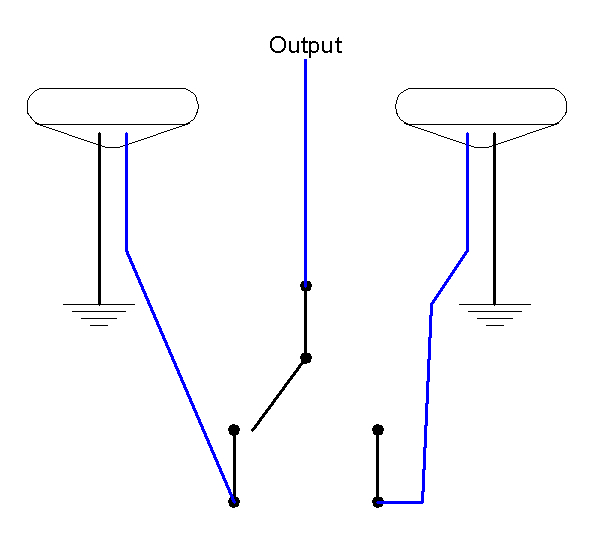

A switch, in its simplest form, simply picks up the signal from either side of the switch. Actually, there are even simpler switches which can switch two conections either on or off. This is called a single pole/single throw switch, or a spst. You can add throws to this, so that you can switch the output between two inputs (or one input between two outputs). It would then be a spdt, or single pole double throw. A Les Paul uses a spdt switch, and though the mechanics are a bit more complex, it works pretty much exactly like the diagram. It does have a middle possition, which is just a stop where it makes contact with both sides of the switch. This gives you both the pickups at the same time.
