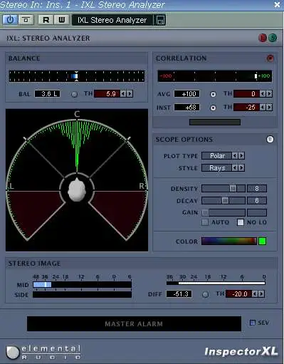

Looks balanced to me...all ditto the above.
Him and his fancyas*s stereo analyzers.
Hehe, sorry, just kidding. Just felt like saying that. Cheers.
Just thought you might want to see that all your ears are calibrated and certified. :D
