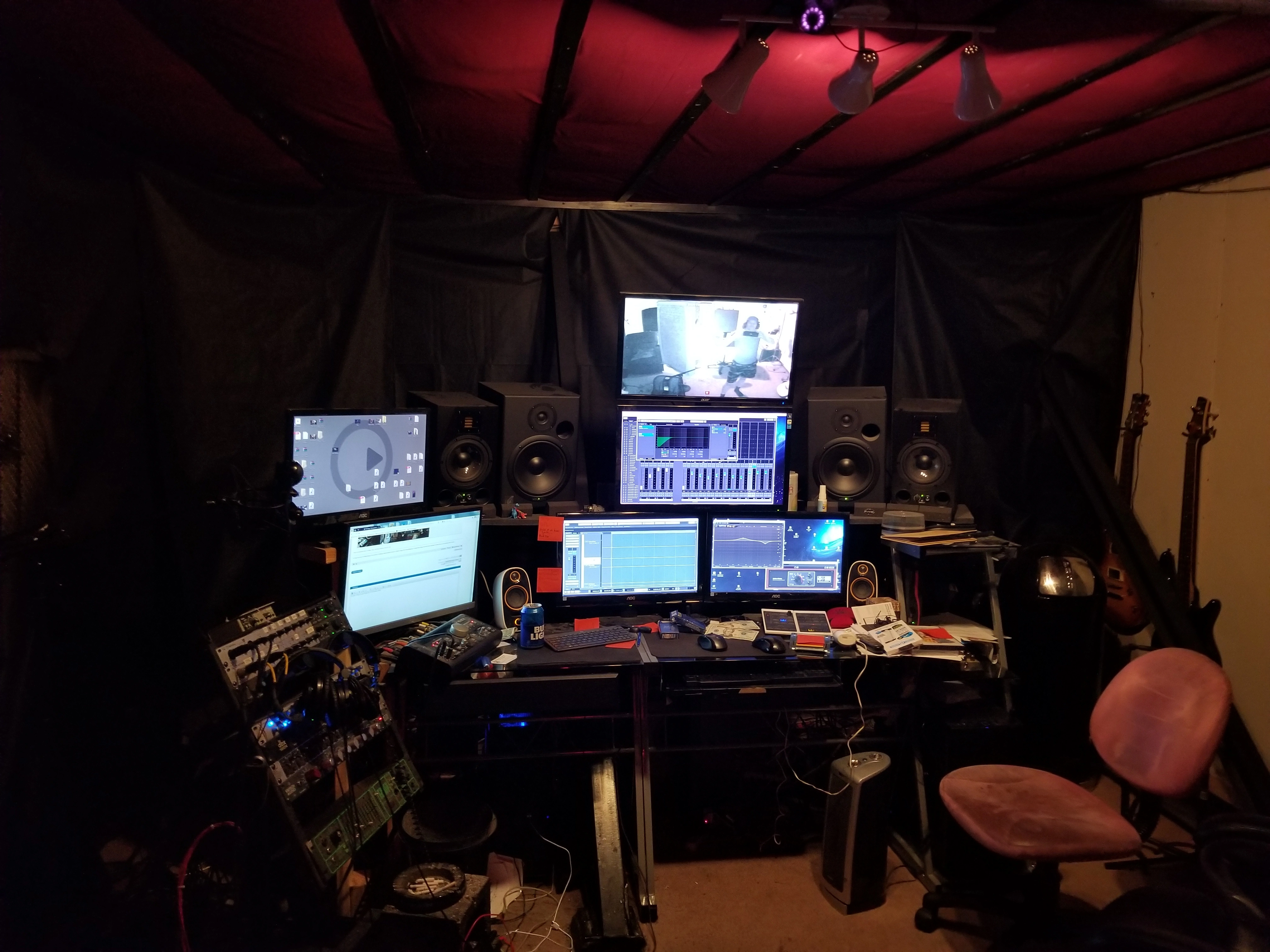

So, what I have done in my control room is open ceiling with pink fluffy stuff. As advised by JH Brandt. It is covered in cloth to just behind my listening position. I have 6" thick rockwool panels behind the desk in corners from floor to ceiling. I also have a 4" thick 2'x4' panel 'cloud' above me at listening position. When mixing, I bring in two panels from my drum room at reflection points on side walls at the reflection point from monitors.
In the rest of my 13x30' room I have 4" 2'x4' panels hanging on walls with 1.5' gaps in between. So 8 of those panels down the walls at the long walls. I haven't had reason to place/build bass traps at the end of the room as it defeats my purpose for the room. At that end is a $2500 watt PA system that some live guys love to hear when drums are recorded in it's 13 x 30" isolation room. In which the ceiling is completely filled with 4" rockwool with 6" gap between the insulation and subfloor above. Again covered with cloth. Then 6 of the 4" 2 x 4' rockwool panels staggered on the concrete walls. There are also a few hanging office dividers that I have at angles to reflect the sides. It is a haphazard thing that just worked really well. Though the drum room is a different animal, and treating it has much to do with trial and error. This just worked well for me.

Just the quickest I could find a pic of my control room desk setup.
I can take and send more pix. Been a while since I uploaded my current setup.
And many things have changed. The room acoustic treatment has not other than addition of the cloud and side panels.
