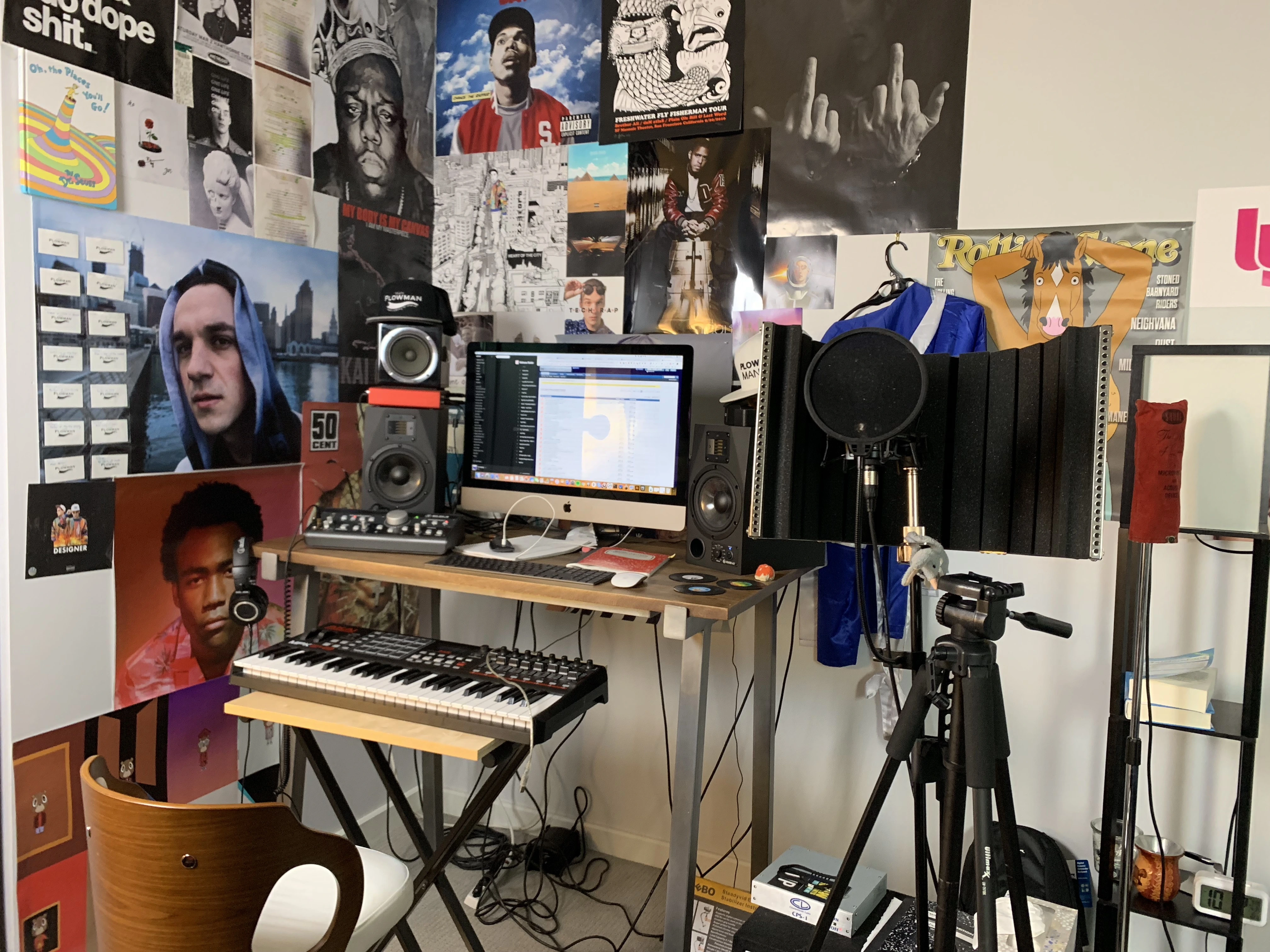

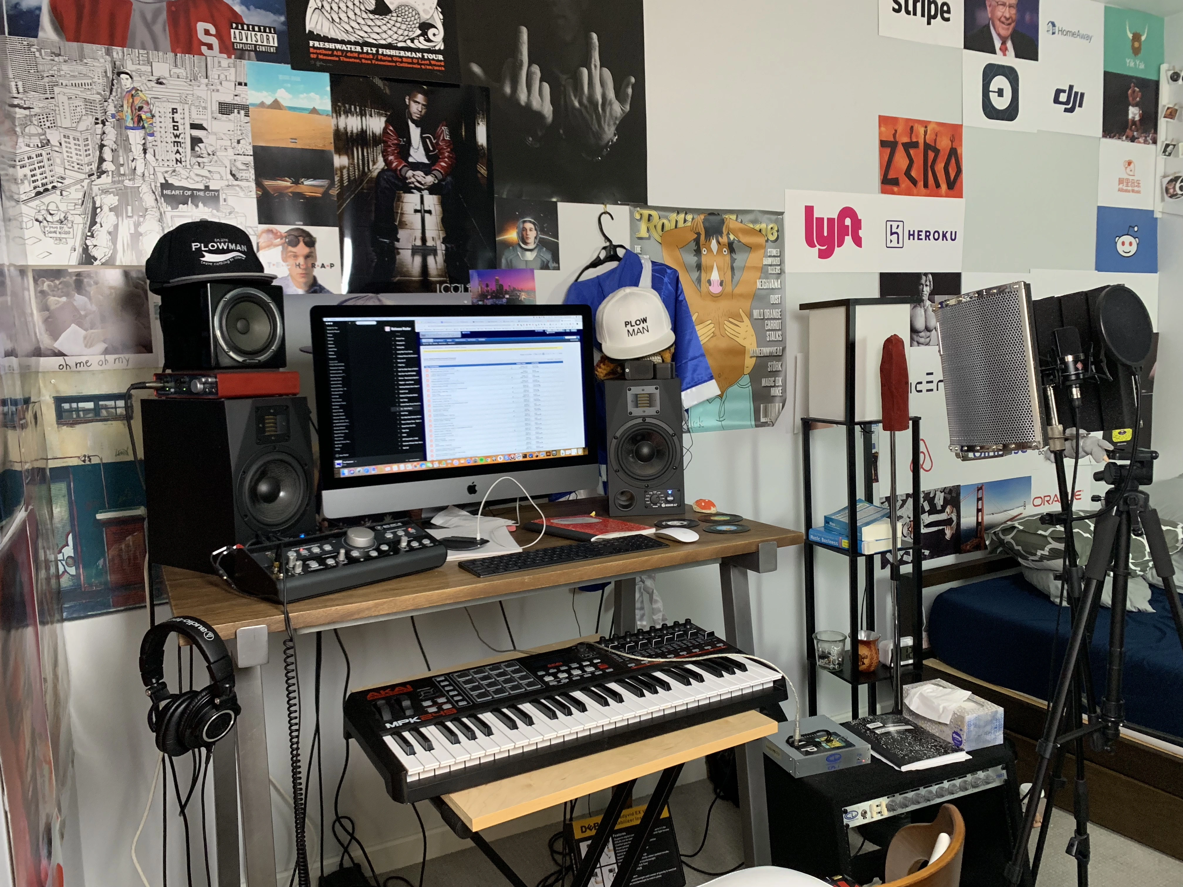

Right now I've been working out of a bedroom studio (pictures attached).

Are those the new Adam Monitors?

Had heard about multiples in room modes 5 : 10 for instance. Hadn't heard about even room modes. Will keep that in mind. They are ADAM-A7 so no.

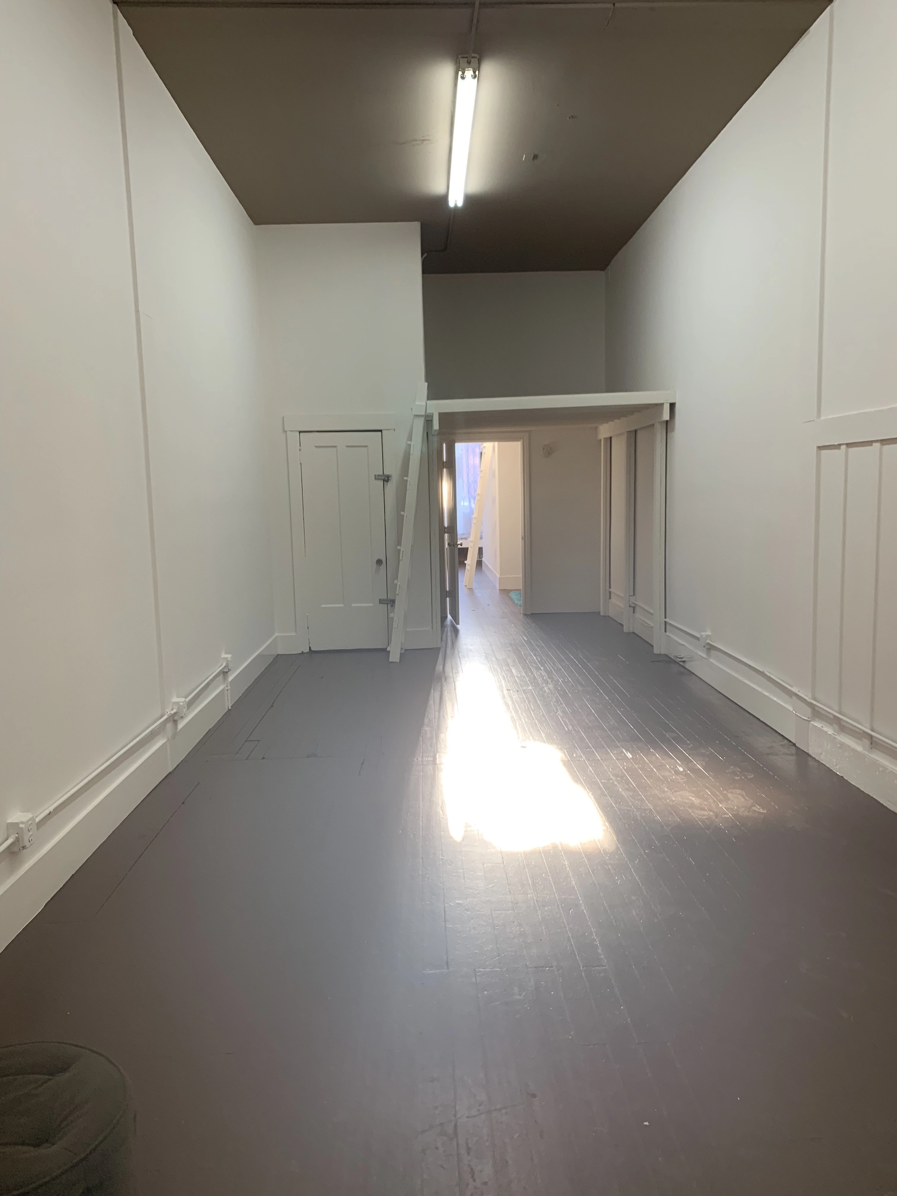

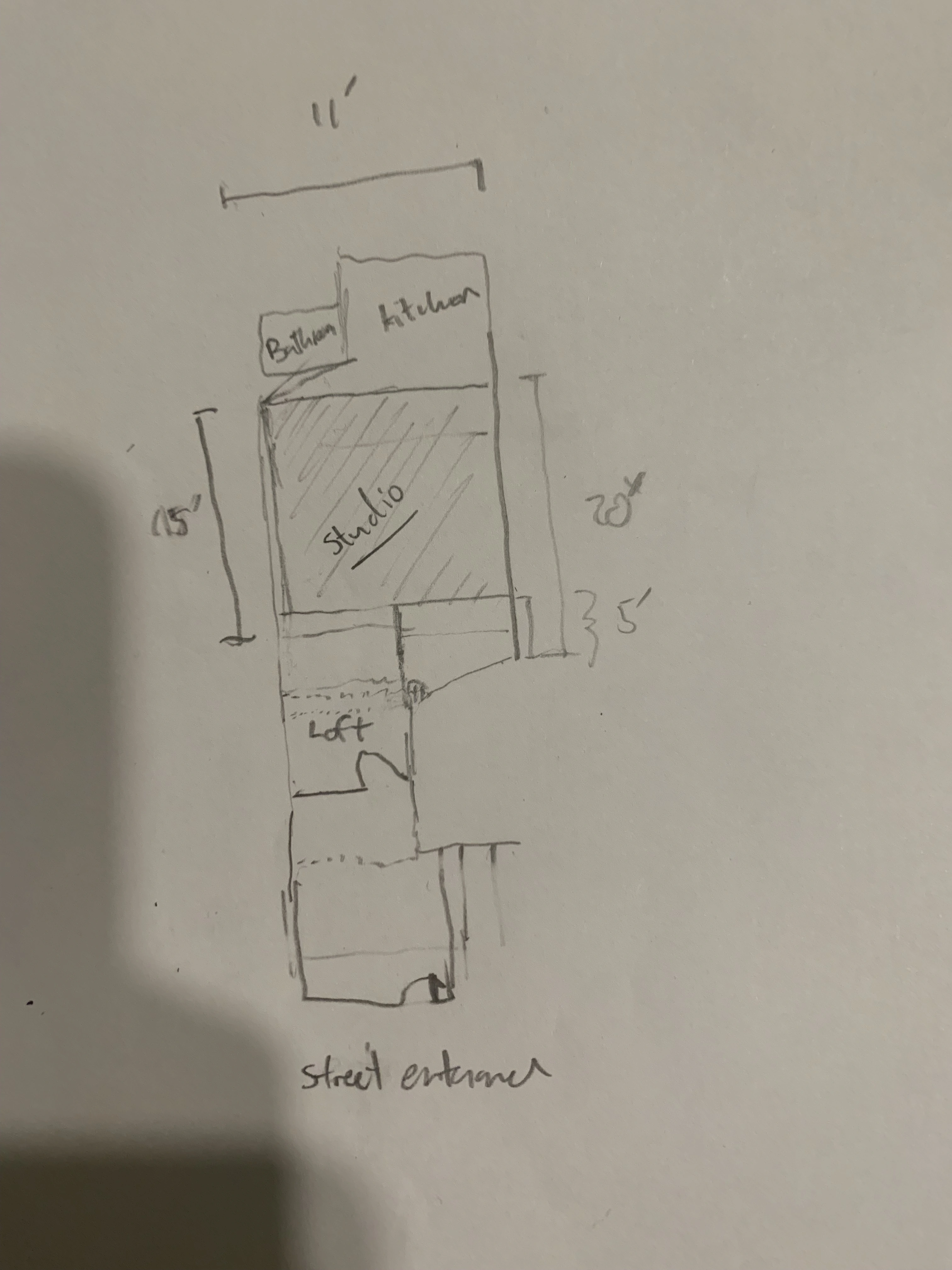

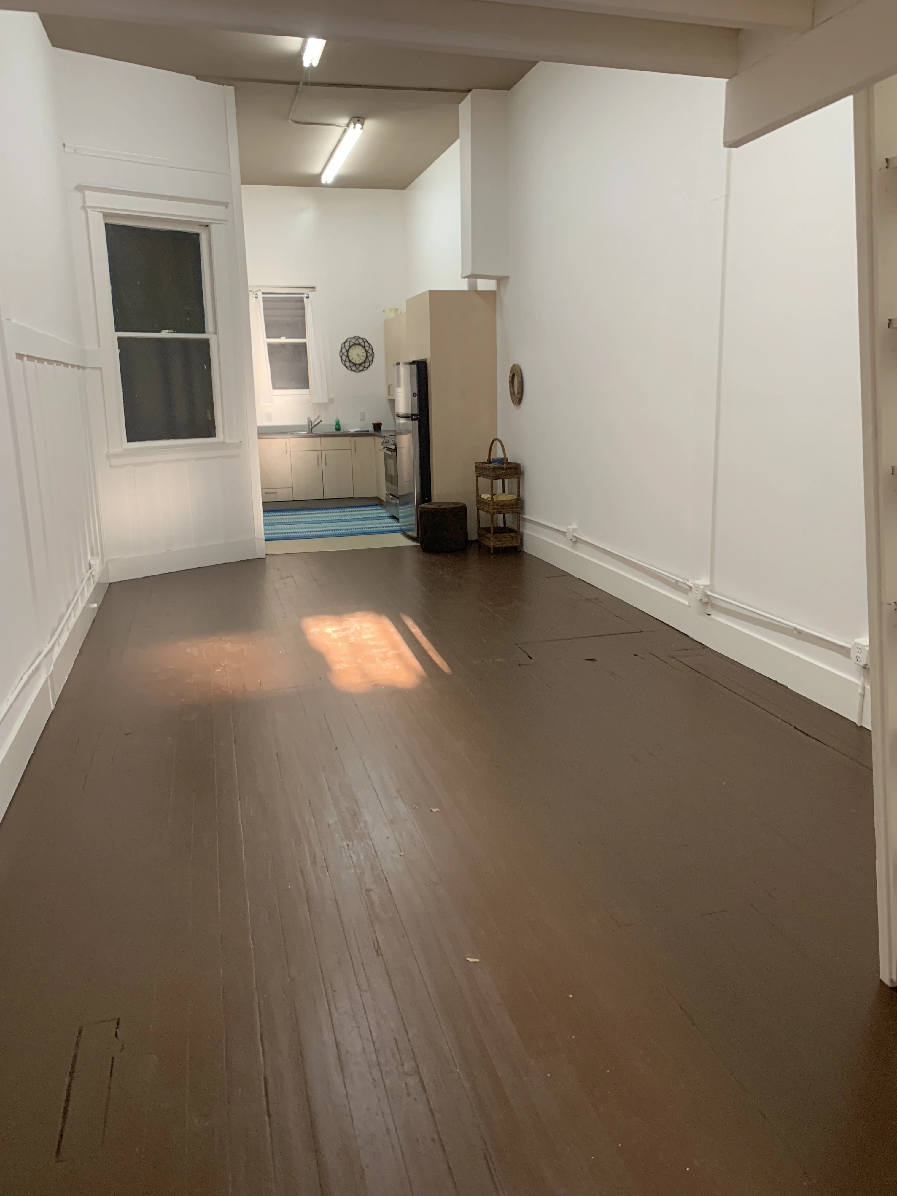

So I just toured a live/work space that I think might work for my studio setup. I wanted to get feedback from you'll on it to see if it makes sense!

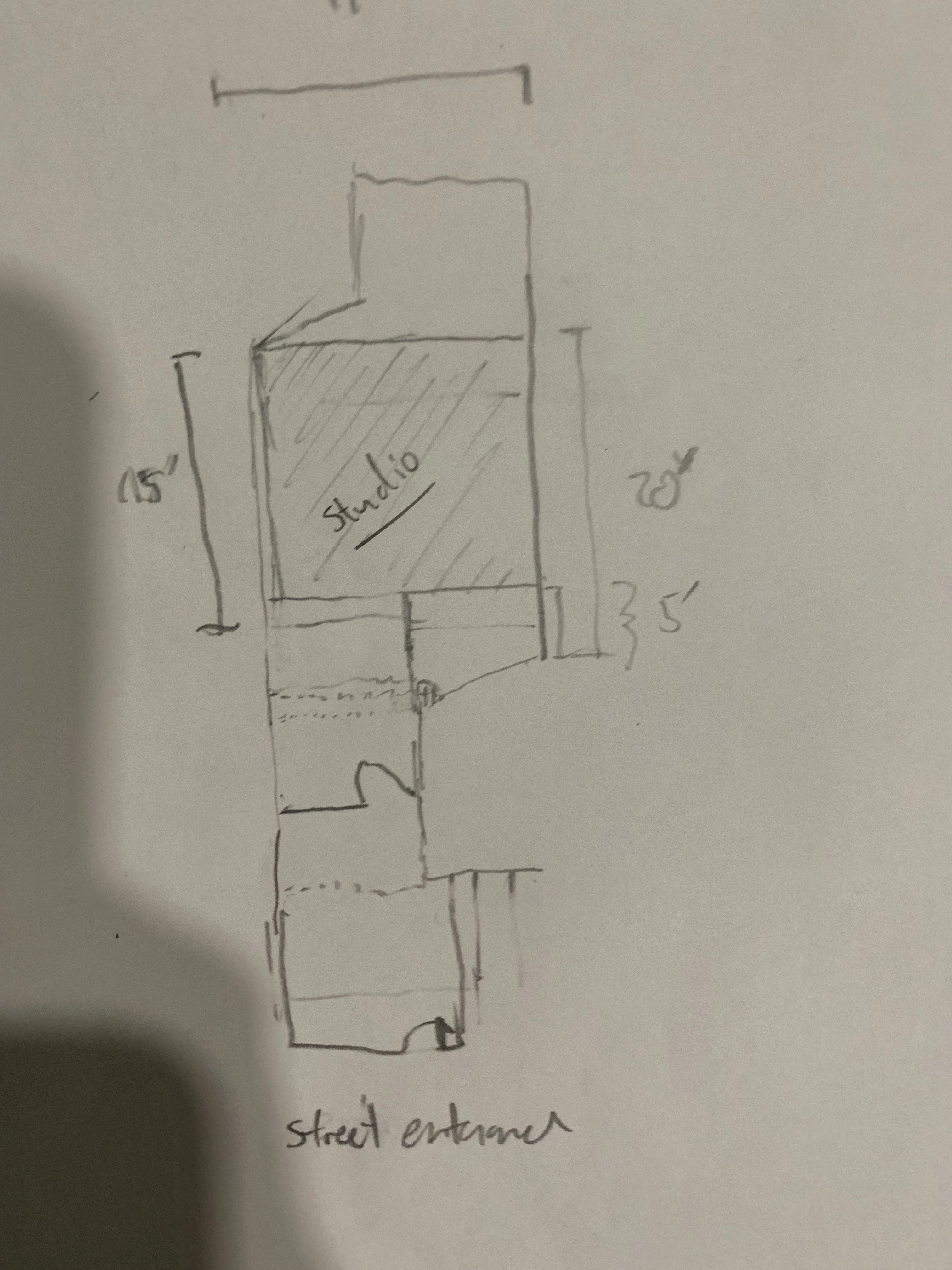

I attached a rough floorplan of the space. The area I'm thinking of using is 11 x 20. I'm thinking of using 11 x 15 of it and leaving 5 of it for part of a small bedroom area. Open to using all 20 of it if that would work better acoustically.
The biggest thing I'm struggling with at the moment is where to put a vocal booth. Wondering if anyone here has suggestions!

Check any potential sites for RFI sources. A cell phone tower 100mtrs away is probably no problem but 10mtrs or less could be!
Farm buildings are often isolated but not good if farmer Giles starts TIG welding. Similar serious mains borne and radiated electrical energies can be hard/impossible to keep out.
A good test is to take a guitar amp and guitar to any site you view. Plug in and set the volume to a tad under feedback and leave buzzing (they always do, a bit) while you wander around and take measurements etc. Any loud farty noises or actual radio programme indicates you could have a big RFI problem. A valve amp such as a Fender Champ is best but any decent amp will do at a pinch.
You should also check that the mains electrics are in good condition. SAFE! You also need a landline that can give you a fair internet speed. Wireless kit and studios often do not a happy marriage make.
Vocal booth? Don't unless you can make it completely dead which effectively means it starts twice the finished size and is lined with huge amounts of absorbers. The best option, outlined here at HR many times is to construct a "tent" of duvets, blankets, whatever and keep room sounds from getting back into the mic. As this is a stepup from the bedroom scenario you can make something better in the form of movable frames. Called "Gobos" these are also useful for breaking up room reflections (and you can build mains diss strips and/or XLR boxes in them)

Sometimes live'work spaces like this have artists who may be working and don't want audio disturbance from neighbors. How are you planning on isolating that 15'x20 area from the 'bedroom' and kitchen and entrance area?
I'm not as I'll be the only person using this space. I wasn't clear what I meant by "live/work". In this case I meant it's less finished (doesn't have proper bedrooms, the bathroom is fairly limited). Below me is a cellar (so I don't think that needs to be isolated). Above me is another living unit, but I'm hoping the room I build inside the 15x20x(15?) space will provide enough isolation so that it's not an issue.
Will keep that in mind. I think I might have room under the loft section of the apartment. Either way I think I'll save that project for once the control room is done.
I think I might build the control room with a somewhat forward looking setup so I could add a vocal booth in the future. It's already becoming clear this project is going to take a ton of time and I'd imagine I'll be itching to use the control room as soon as possible. I haven't dug into the details of running xlr cables, but I remember reading it's much easier to put wires in ahead of time than it is to add them later.
A cellar? Assuming the floor above it is wood they will be "connected" at low frequencies. This means you can put bass trap material in there. Need not be fancy, GF or rockwool left in bags and stacked in corners. Hopefully there is nothing noisy in there? Furnace, AC?
Cables: Put in loads and I mean a S***T LOAD! Clip some 1.25" PVC water wastepipe to the walls and runs wires in that (and always leave a strong plastic line in there as a future "pull thru') . Don't buy expensive HD super flexible balanced mic cable and hide it! Foil screened two core is actually better for RF screening. Only 3-4mm OD and the drain wire means it is a dream to strip and connect. You can also use CAT5/6 shielded (FTP) cable. Cheap as chips and each 6mm cable gives you 4 twisted pairs. Not only can CATX carry audio but there are cheap adaptors that allow video (HDMI over a pair) S/PDIF down it plus of course Ethernet!
Err? "Control room"? Do you intend two separate spaces a la "posh" studios with double (triple!) glazed window between? If so why? You can't monitor/watch yourself! The problem with HS'es is almost always small rooms. Use ALL the volume you can for both recording and mixing.
