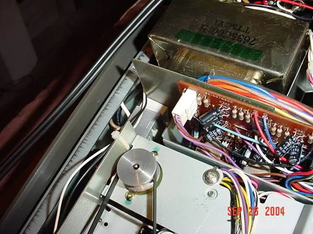

Hi,
I just bought another MINT 244. I got this one locally which is pretty rare - not on eBay this time ;) . Anyway, I found what looks like a "switch" which is not present on my other 244. It's located on the far left, just by the power supply (photos attached). First I thought that it might be a voltage switch but then checked the manual and if it is that then it's located a bit farther than the manual shows. I'm not sure what it is ... All I know is it looks like you slide a white thing up or down ... Anyone know ?
Thanks!
Daniel

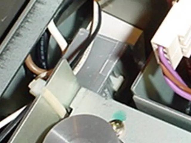

Close up .....

Hi,
Anyway, I found what looks like a "switch" which is not present on my other 244. It's located on the far left, just by the power supply.... First I thought that it might be a voltage switch but then checked the manual and if it is that then it's located a bit farther than the manual shows. I'm not sure what it is ... All I know is it looks like you slide a white thing up or down ... Anyone know ?
Thanks!
Daniel

How many wires are connected to it and do any of them trace back to the power supply?

That box is the on/off switch for the Tascam. I just swapped out the non-polarized plug that attaches to it, for a polarized cord.
You'll find the power cord attaches to it in 2 spots, as well as 2 wires going to the transtormer.
The set up is:
A - Wire from power cord and wire from transfomer together. This is the Neutral.
B - Wire from power cord. This is the HOT.
C - Wire from transformer. This connects to HOT when the power switch is in the ON position.
If you want to change out your cord to a polarized cord, you would take out the old one, and wire it so the wire with the wide blade connects A. The wide blade on the plug is Neutral, and on the left when plugging it into the outlet. The smaller blade is the HOT, and is the one you always want to have switched. That one would connect to where the old wire is by itself on the switch. C, the wire from the transformer, remains where it is.
If you want to instead, add a 3 prong cord, you'd do the same, but the 3rd wire (green on the cord) would be soldered somewhere to the chassis (metal frame/body) of the Tascam.
