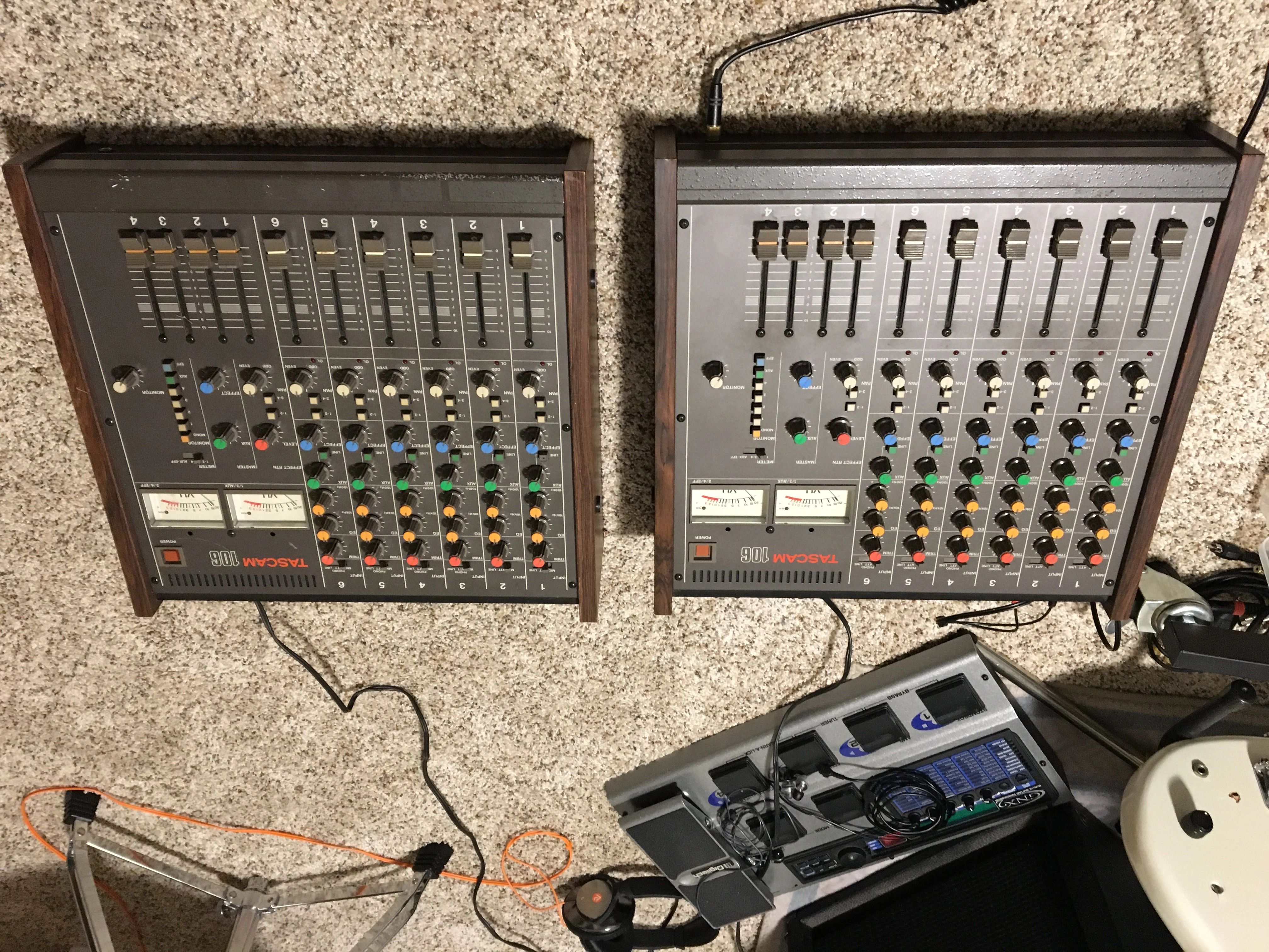

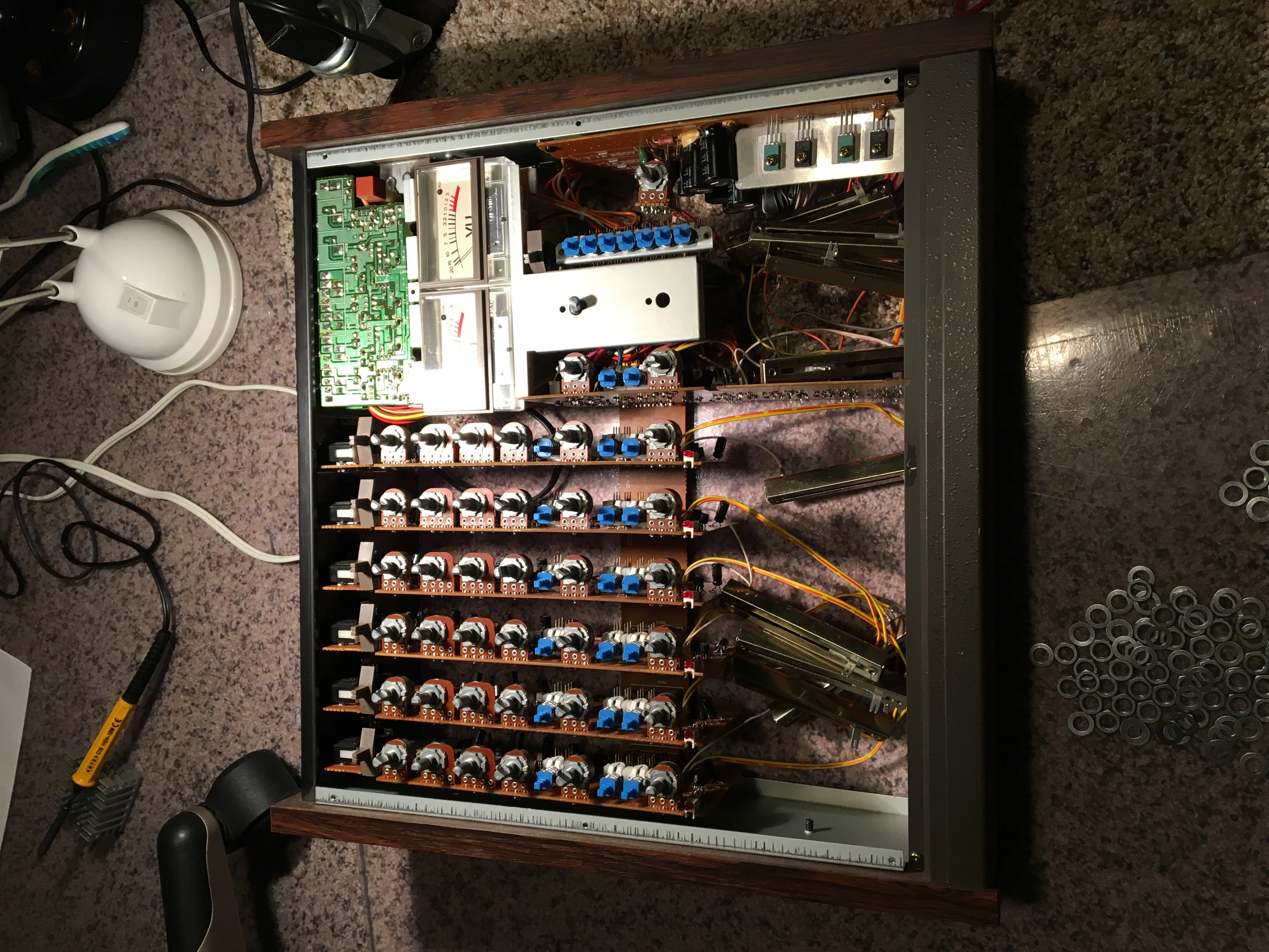

And this is what they look like inside...I'd take one of these over a little Mackie, Behringer, Phonic, Alesis unit all day long...
Maybe $70 was too much to pay for one...oh wait...that's right...I got two for that price!
:D:D:D
They both work just fine. None of the VU meter lamps work, and one of them has one dead meter. I have lamps and spare meters too. One of them is in excellent condition...thinking it will clean up 9/10 easy. The other is a little more rough but not too bad.
They sound good! For original caps being onboard and 2041 opamps I'm pleased with the sound. Anyway, probably get them both going tip-top, make one minty one and one average one out of the pair and sell them both.

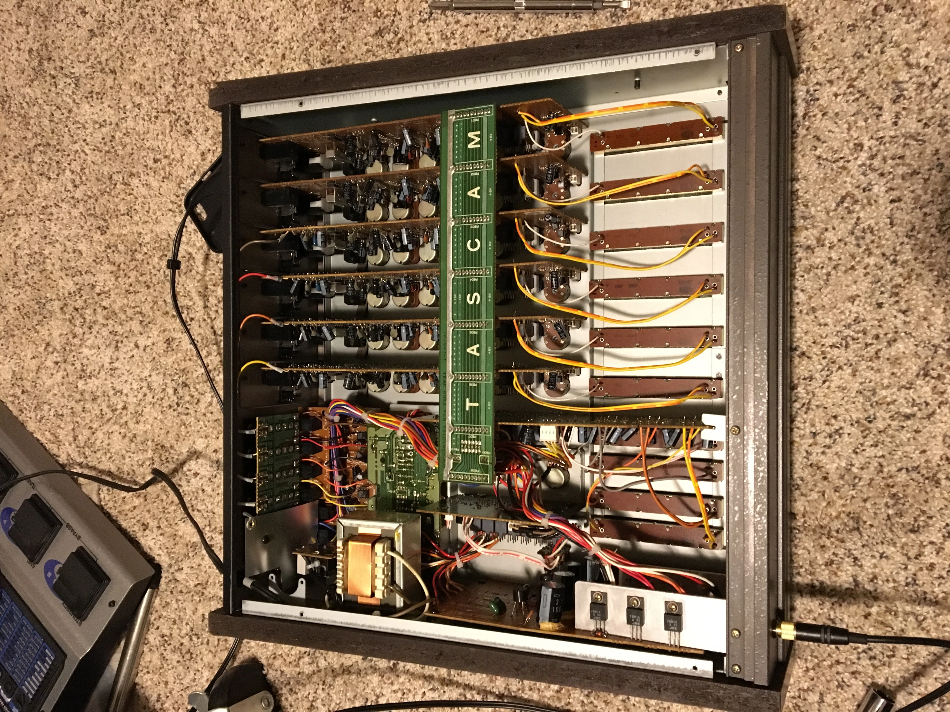

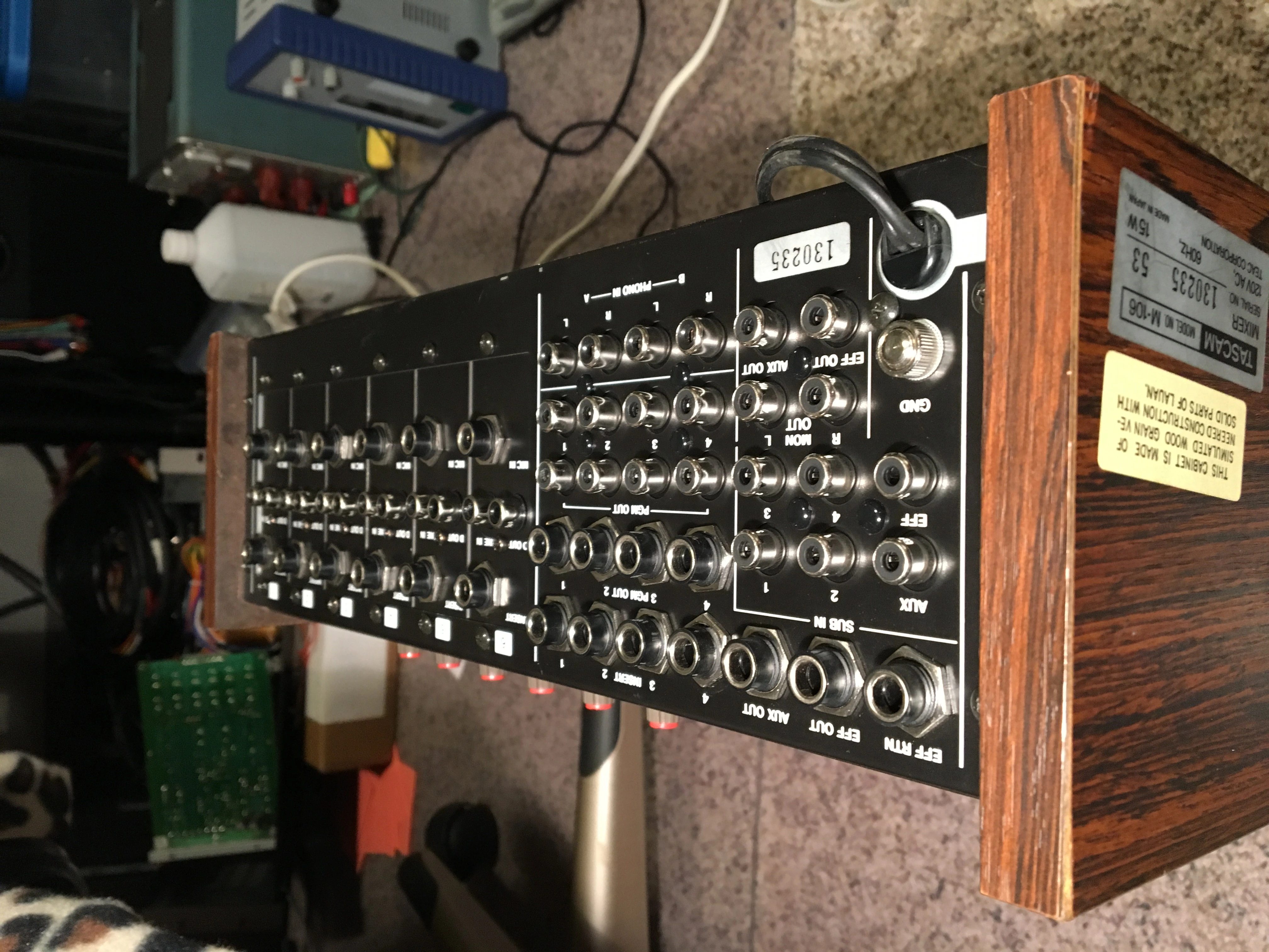

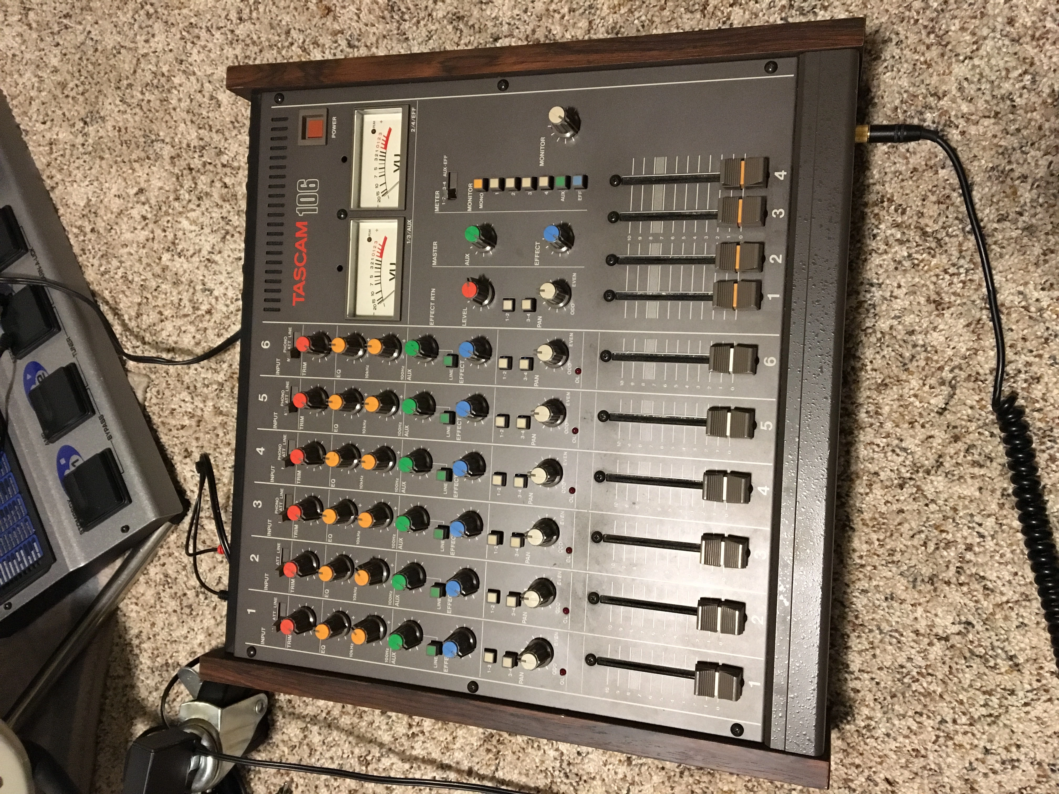

This is what a naked M-106 looks like from the top...it is possible to remove the dress panel to clean it with all the guts left intact:

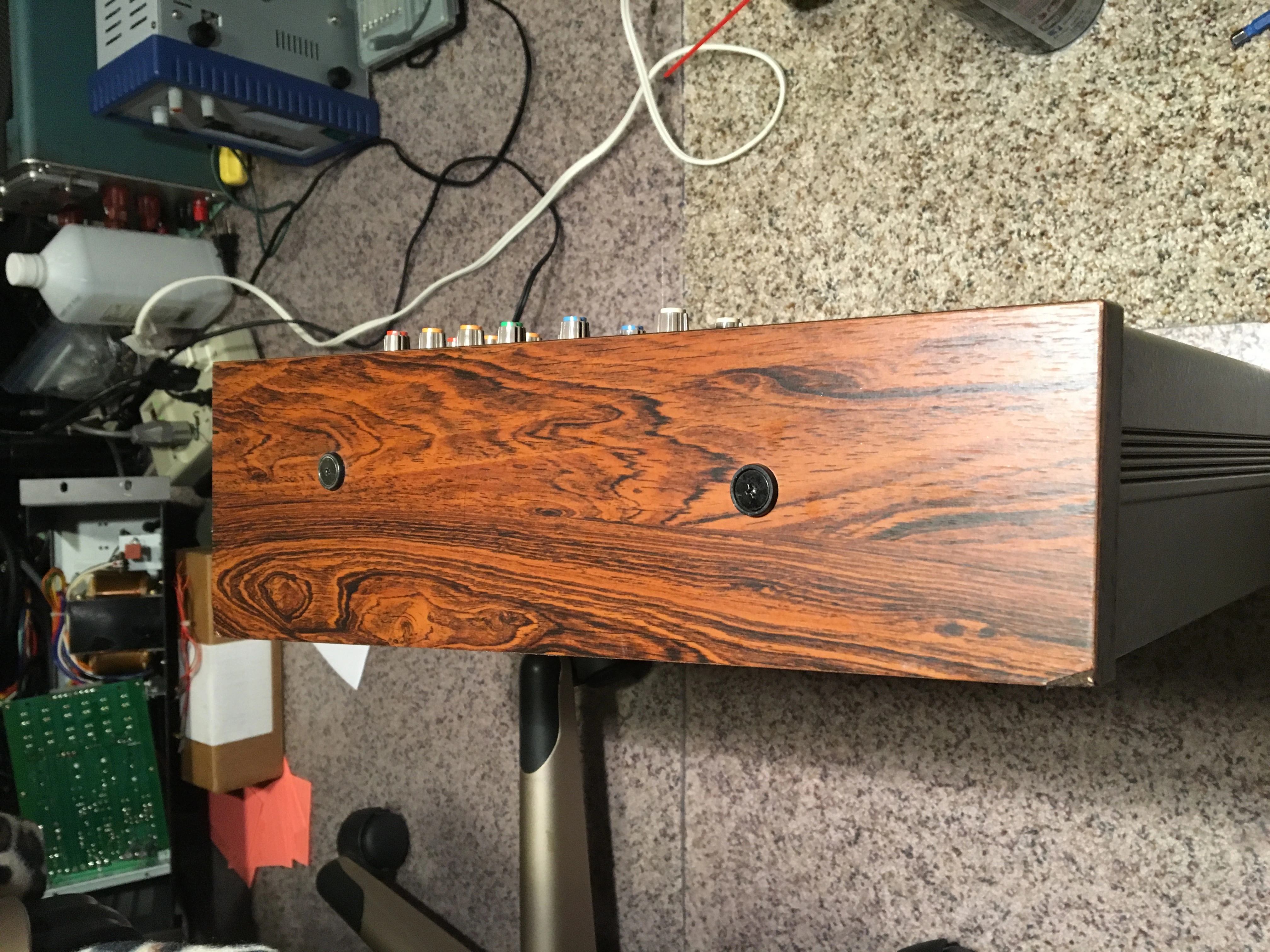

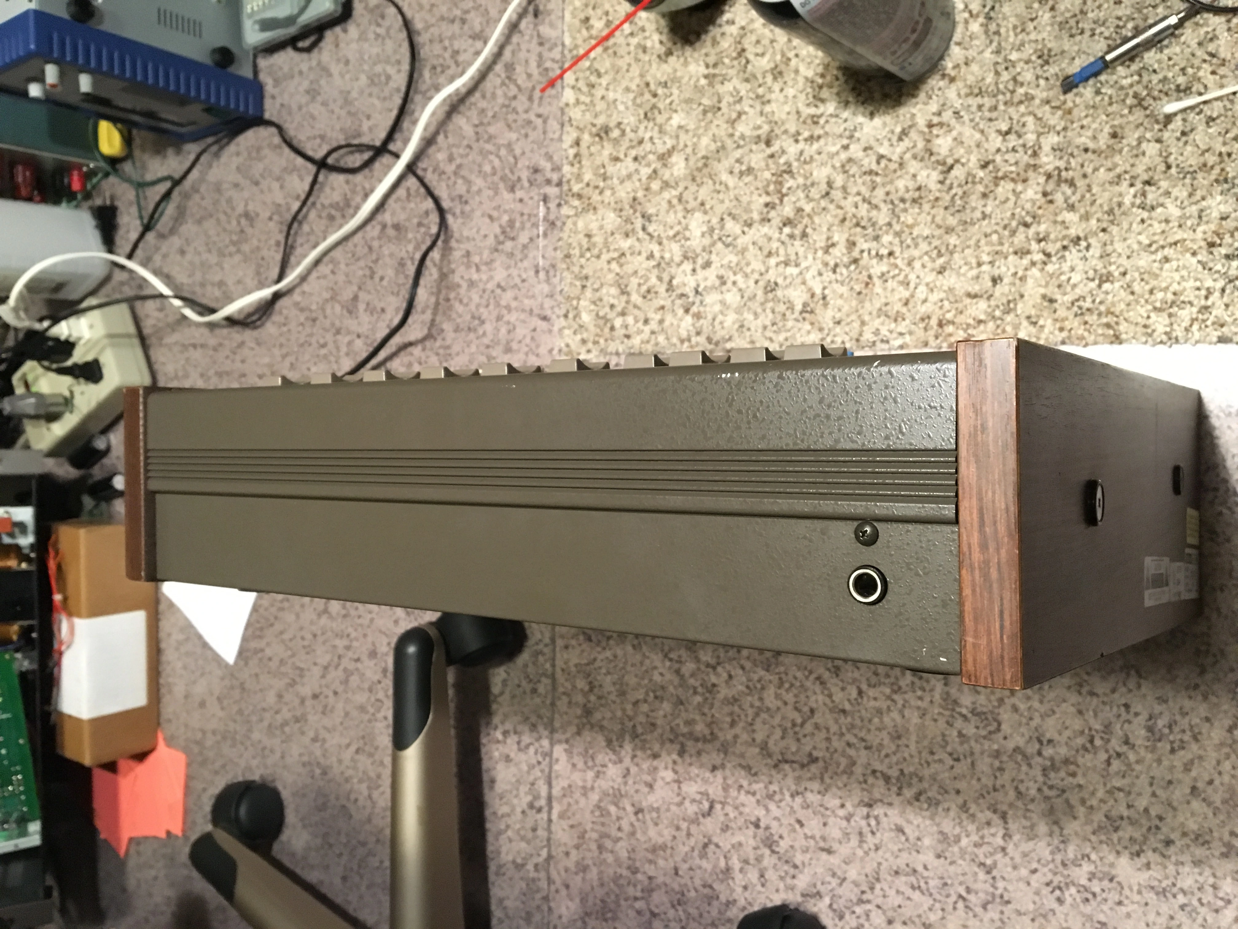

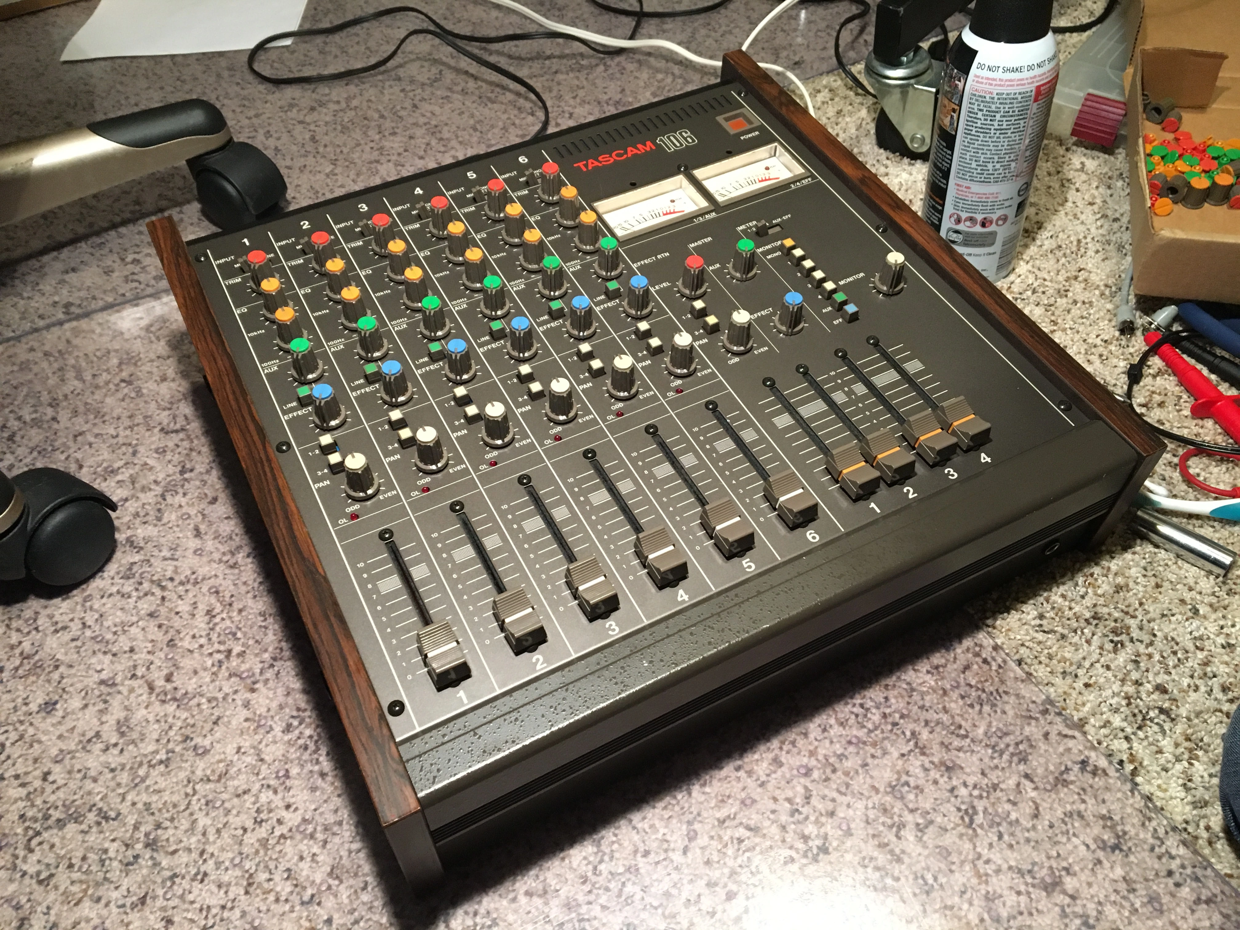

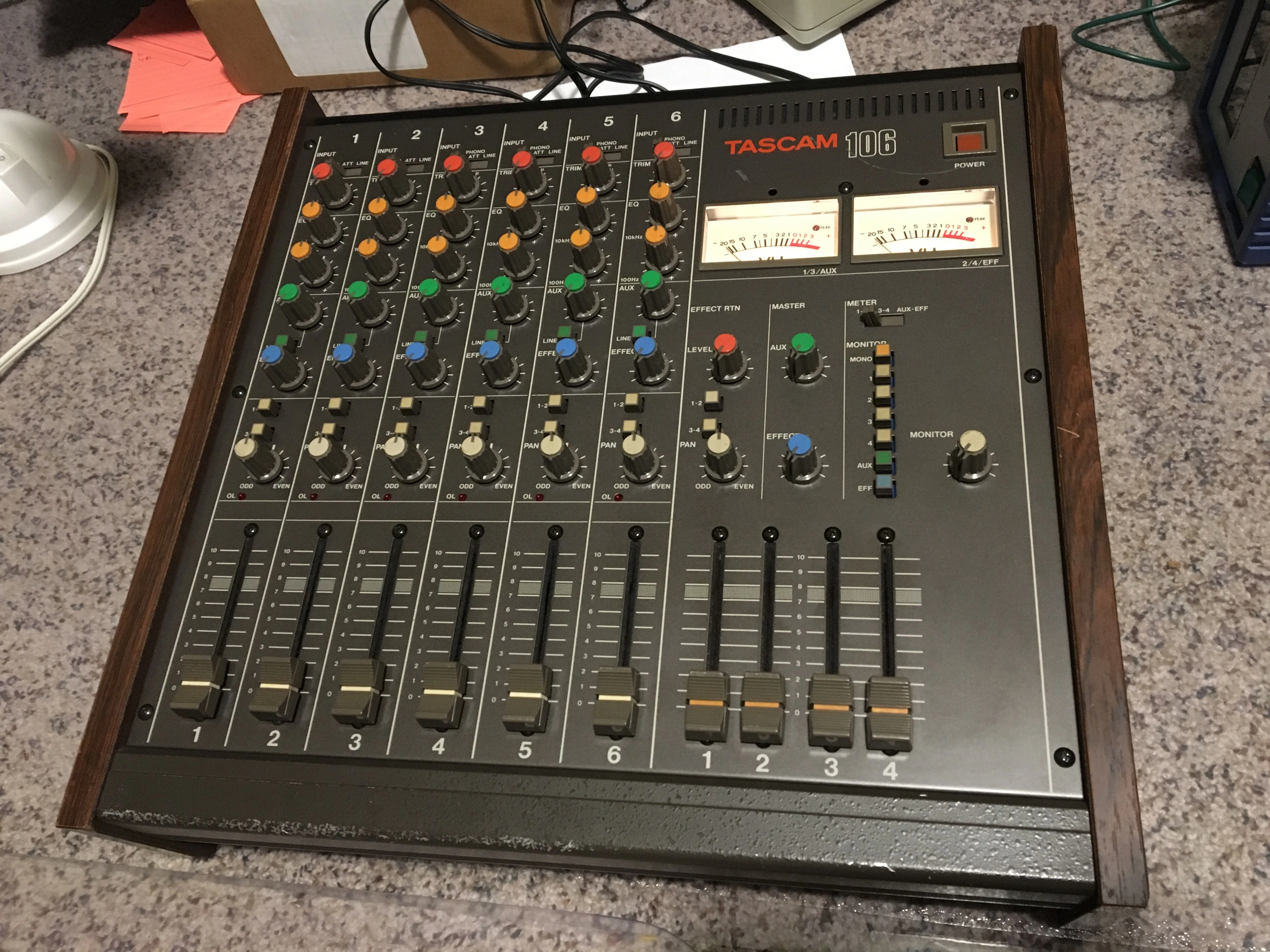

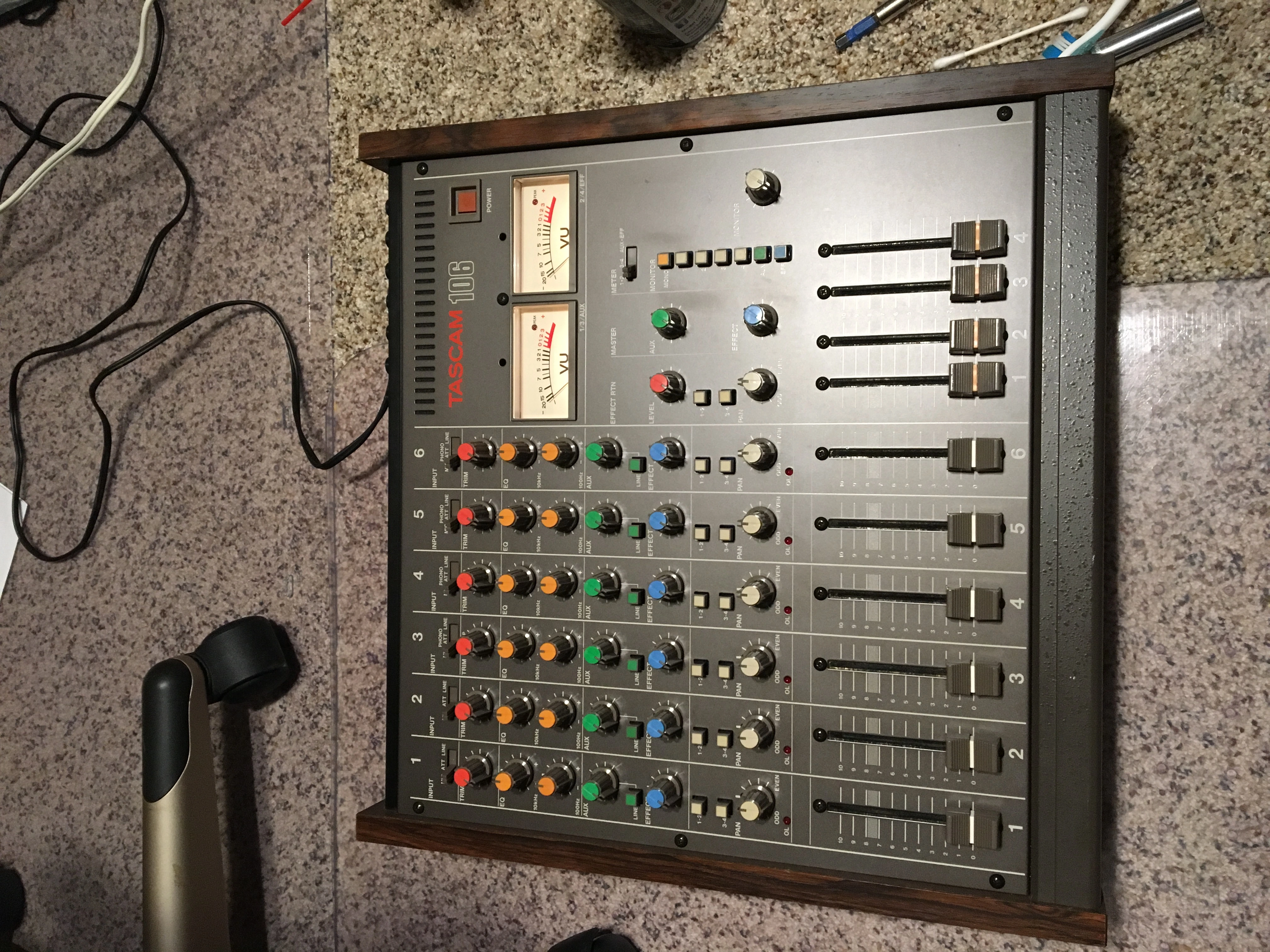

I finished refurbishing the one M-106 I got that looked like it would clean up well. It did end up being a solid 9/10 cosmetically. I detailed everything, disassembled and cleaned all the faders, installed new meter lamps and calibrated the meters. Both of the M-106s I bought appear to have been used/stored in a dry environment...I often come across older Tascam gear where the RCA jacks have a sort of hazy oxidation to them vs being bright shiny chrome. Both of these M-106's jacks are nice and bright and shiny.

In the M-106 the meter lamps are powered by a +6VDC power rail. Lamp power at the terminals for the lamps was +1.3VDC...something shorting? I disconnected the power connector from the meter PCB and checked the power at the connector...still +1.3VDC. I probed the 7806 regulator on the power supply...+12VDC at input (good), +1.3VDC at output. On the hunch the regulator was bad I went out to the shop and hastily pawed through a box of M-300 remains...I recalled there being a power supply in there and I figured since the M-106 and M-300 series were contemporary to each other the lamps in the M-300 were likely powered by +6VDC as well. Quickly found the power supply and sure enough there's a 7806 regulator on there. Swapped the part from the M-300 supply carcass on to the M-106 supply...lamps still didn't work...hmmm...wait...then they were on...wth...I wiggle the power connector at the meter PCB and the lamps flicker. Out comes the soldering iron again to re-flow those solder joints. All better now. I calibrated the meters, did a quick wipe-down...it's in better shape than I originally took it for. I'd say a 7/10 and fully-functional:
By the way, a great answer to a trivia question: the M-106 and M-300 series use the exact same power supply PCB.

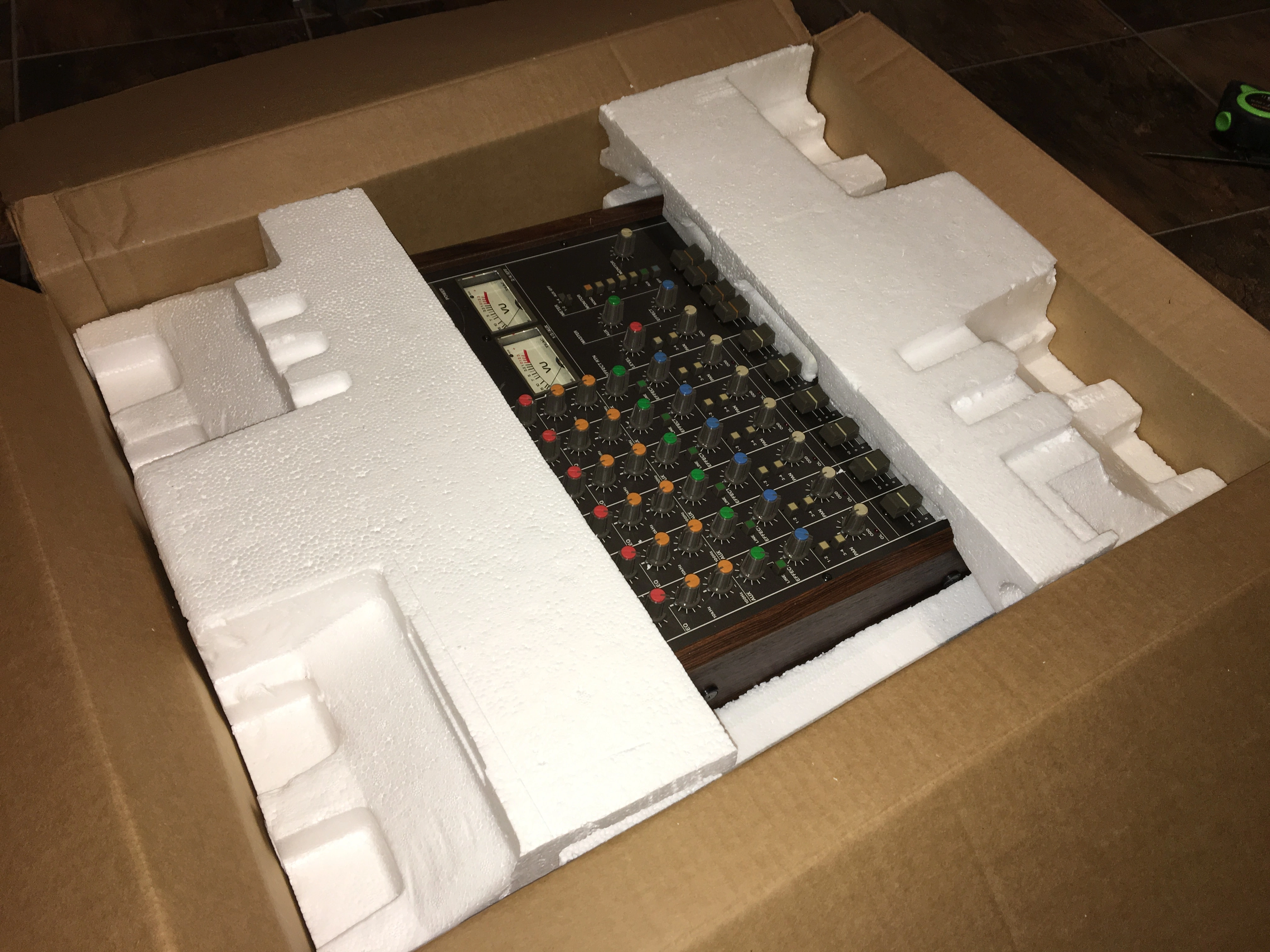

I like it when stuff works out like this...I purchased the two M-106 mixers for about $70...the seller thought they were non-functional. They both did need a little work, but not much, and they are now both 100% functional, one of them is in minty condition, and the other I just sold for $100.
And this is how you ship it...in a custom fabbed cacoon made out of styrofoam packing blocks from computer monitors. Bye-bye M-106 #2.

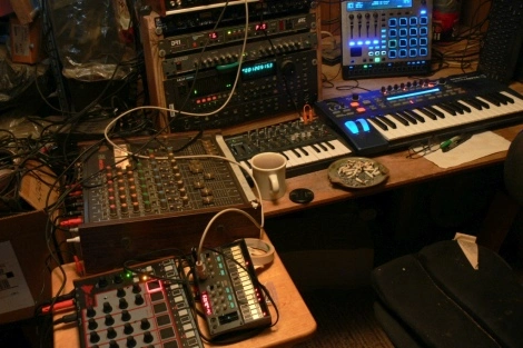

I got one in Feb. 2011, after my first mixer left me feeling empty - a Behringer 1002fx.
Very happy with it. Never sees a MIC. I don't use the 2-buss for anything. One day it's mixing synths to a disk recorder, the next day its on the floor, the next day mixing DAW groups out to 4-track tape ?

Hey thanks for the post and welcome!
It's a handy tool. I really like how mine sounds and yeah...it's really easy to just set it up wherever. That's cool!
