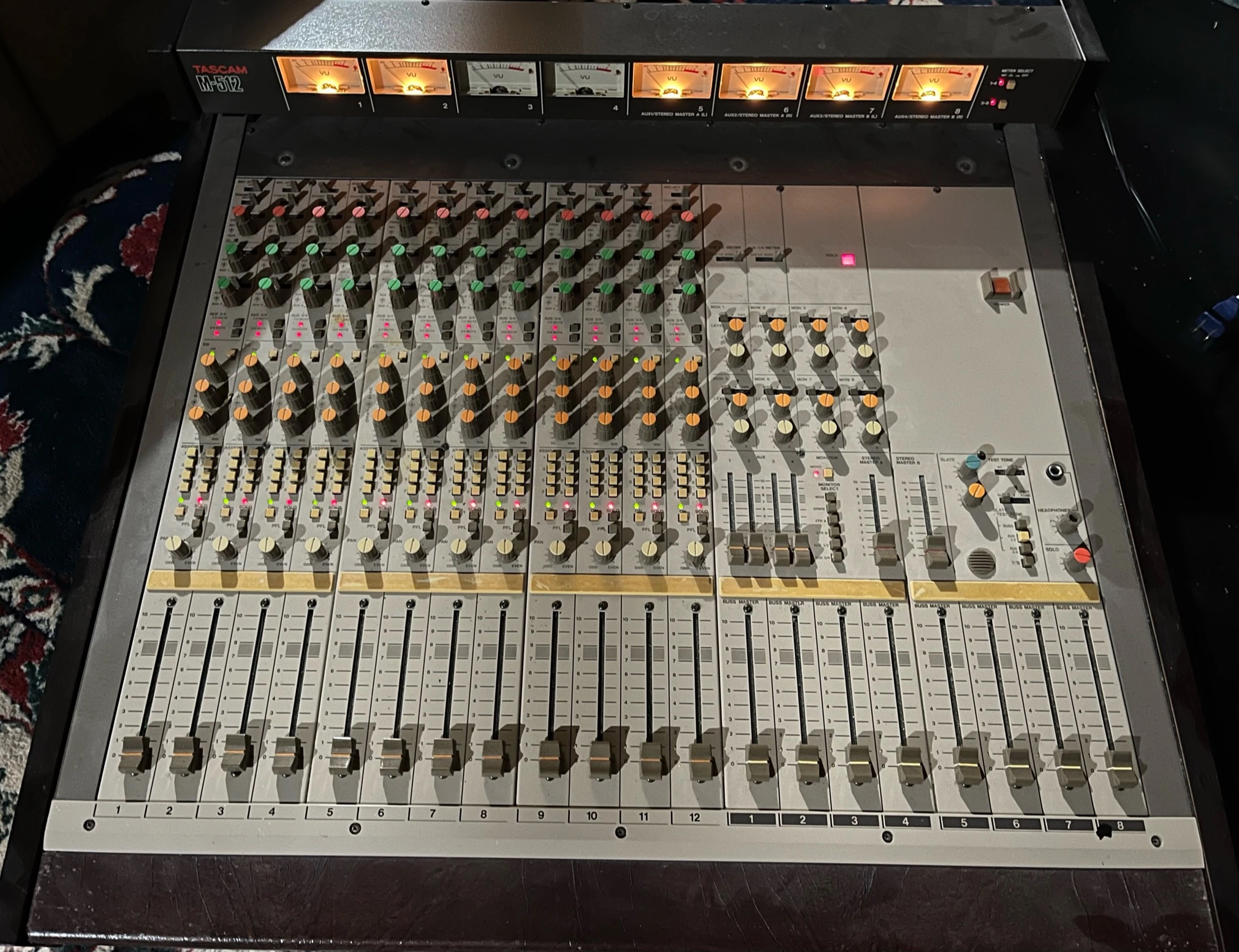

hey all, i’ve got 2 mixers in my line of site, one of which i’ll want to use with a tascam 38. a pretty well kept tascam m-512 with 2 burnt out VU bulbs, local, for 450. and a well kept, however still yet unseen (seller is busy but has been very nice, even lowered price for me) m-30 mixer that’ll have to be shipped for 640.
i’m gonna use it to basically be the only desk that my tascam 38 reel to reel sees. mix in the desk, track through the desk, digitize through the desk (and some other outboard junk).
both have likely been unserviced, but the 512 owner has told me the eqs are aggressive and powerful. he’s tested it for me and says everything works. it’s just the 2 bulbs that are out.
i’d like some thoughts on how these 2 mixers stack up to each other. the m-30 would be a cute little addition to my desk, that could certainly track an album on the 38 all by itself. however, i love the way that the 512 is just friggin huge and has so many options. it WILL hang off my desk though by about a foot lol. below is an image of the desk.

The two aren’t even comparable. If you can deal with the difference in footprint, the M-512 is a much better option just in terms of features and flexibility…easily twice the console for 30% less money. This seems like a no-brainer to me. If you are wanting an analog console to interface an 8-track multitrack machine, I’m assuming multi-channel DAW interface, and “a bunch of other junk”, the M-512 is going to do that much better than the M-30. I’m no knocking the M-30. I’m just comparing what your stated application is compared to the feature set of the two tools you presented.
The M-30 is an 8x4 console with 8-channel monitor or return mixer. The M-512 is 12x8 with 8-channel monitor mixer, but has much better metering and flexibility, multiple inputs per channel, inline monitoring, 100mm faders, 8-channel balance amp, hi-Z inputs, talkback and oscillator facilities, better AUX bussing…like, the M-30 almost has no AUX bussing…M-512 even has individual AUX masters on faders…it’s literally twice the mixer with lots of flexibility. AND…you can actually check it out before you buy it. No-brainer.

this is a sorta unrelated question to the main topic, but do you have a recommendation for replacement bulbs for the 512? i have noticed that more “well kept” tascam units feature a more orange glow to the VU meters, rather than yellow or white glows. and my 38 has this orangish attribute. i’d like to match it somewhat, so if you’re aware of any bulbs (i know the original fuse types are extinct) like that, i’d love to know. i’d probably have to replace all the bulbs and not just the 2 downed ones if i want to make them all look the same.
Usually yellow or white are an LED conversion. I’m not a fan. I understand why many are. So just get incandescent lamps. Look for 100mA 8V solder lead lamps. Yes, on the M-500 series consoles they have the clip in fuse lamps. Maybe you can find them now. Years ago you couldn’t. So u just used solder lead lamps. You can get some and see if the match up close enough to what’s in there, but just keep in mind if some are dead, the others can’t be far behind. Also the lamps are polar. This doesn’t matter if the lamp power rail is AC. It does if it’s DC. I think the M-500 is an AC rail. But regardless I always install the lamps in one orientation anyway. You’ll see the solder lead lamps have a different shape at one end. It doesn’t matter which way they go, just that they all go the same way.
My 520 has all led lamps. Gives off a bit of an Amber light. I don’t mind. It came like that and all lamps light up, so I’m good with it.
