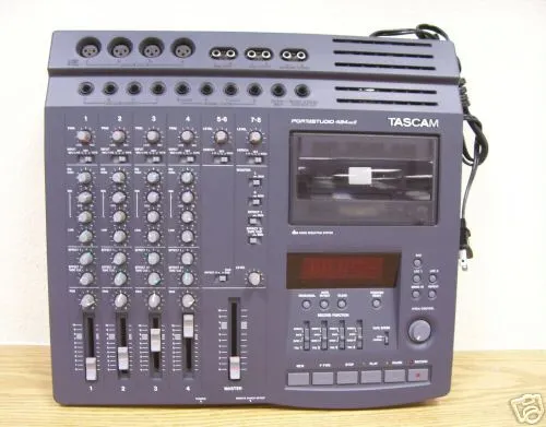

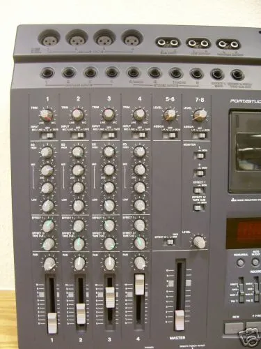

Or, maybe the 424mkIII's the best selling and most popular Portastudio ever because
I've recorded with one!:eek:;)
(Oh, wait...):eek::eek:;)

I was able to afford to shell out a couple hundred for one of these things back in the day (when I was a poor college student to boot).
Criticize the build quality of the 424 mkIII all you want, but you could also argue that Tascam was smart because they realized who their market really was and what they really wanted: AFFORDABILITY
Yeah these things are cheap, almost like toys. But I have done a lot of recording with mine in that last 12 years or so, and it has held up remarkably well, although I have been careful with it. I probably wouldn't be posting on this board if the cheapest cassette 4 tracks you could find in the mid-90s were in the $1000+ range.
